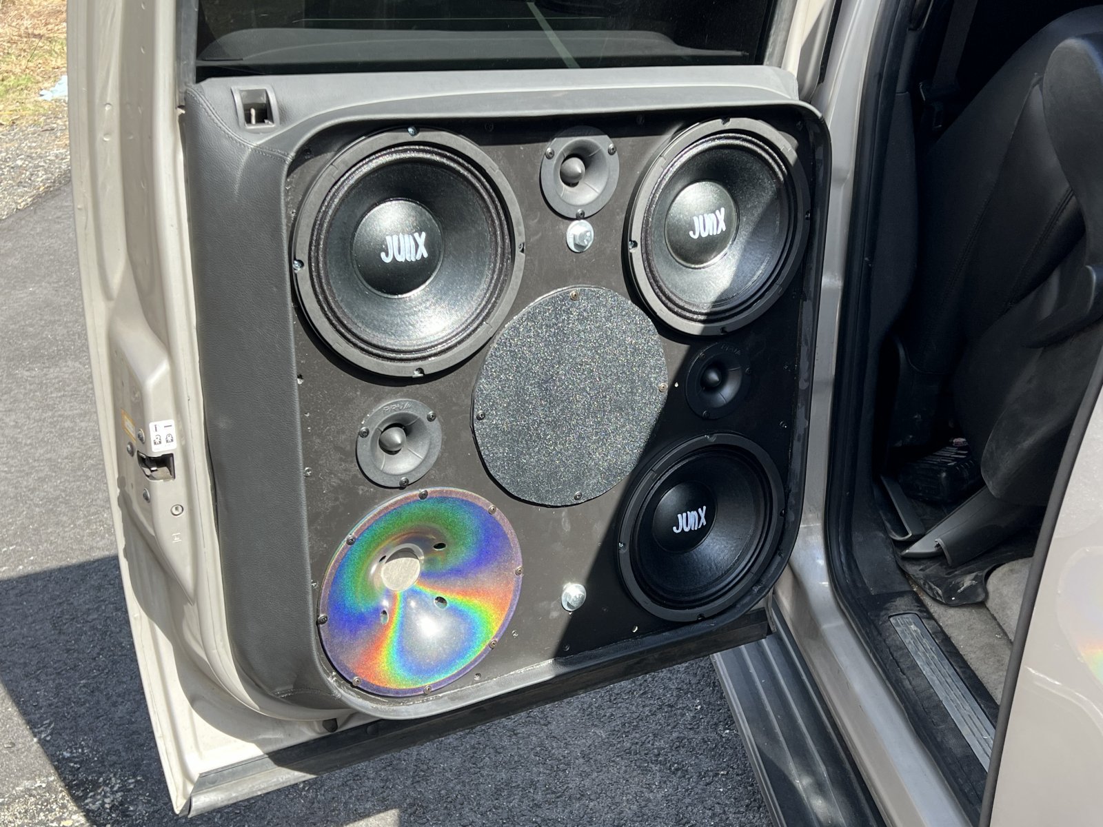

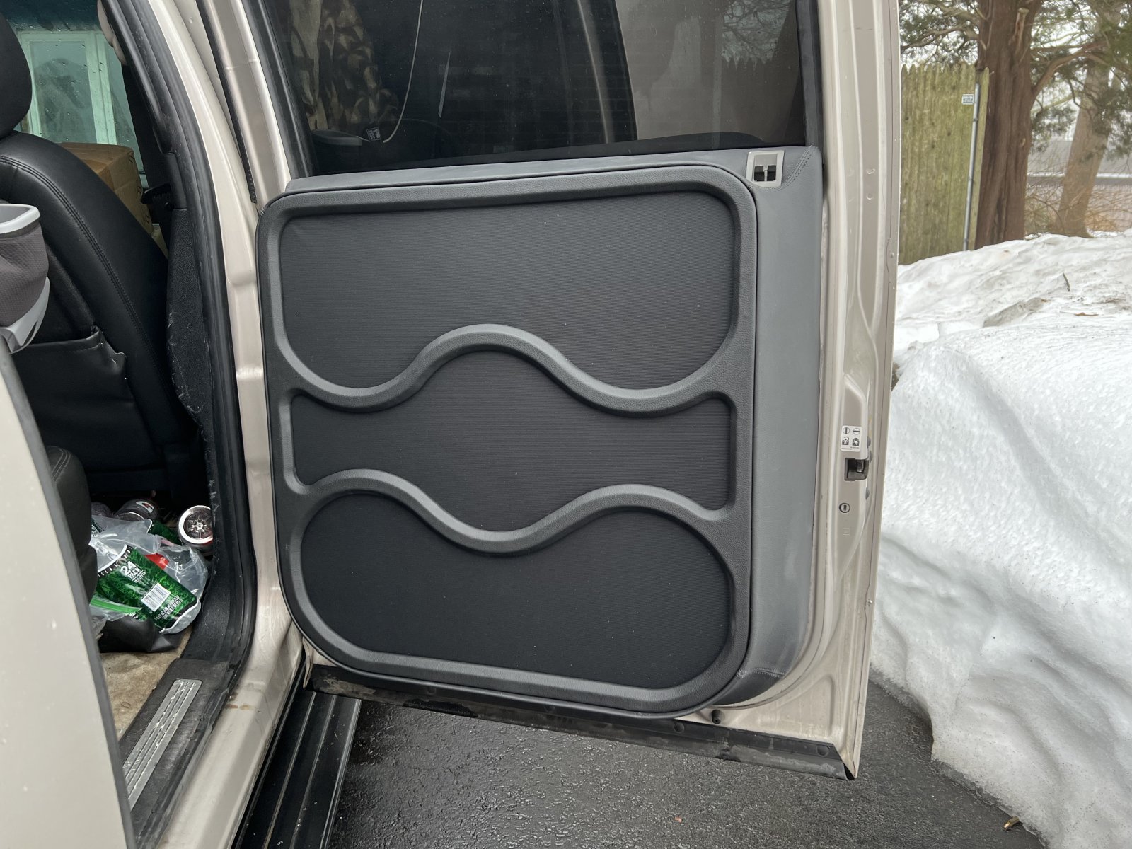

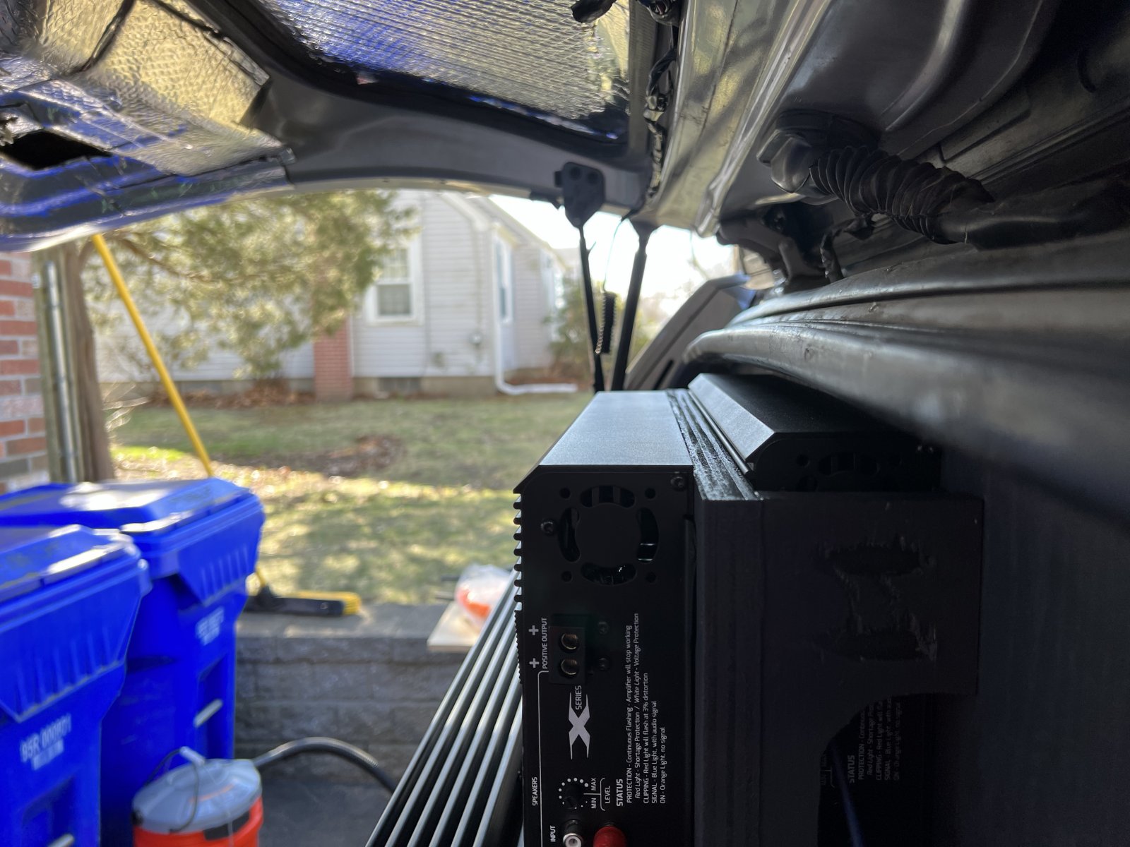

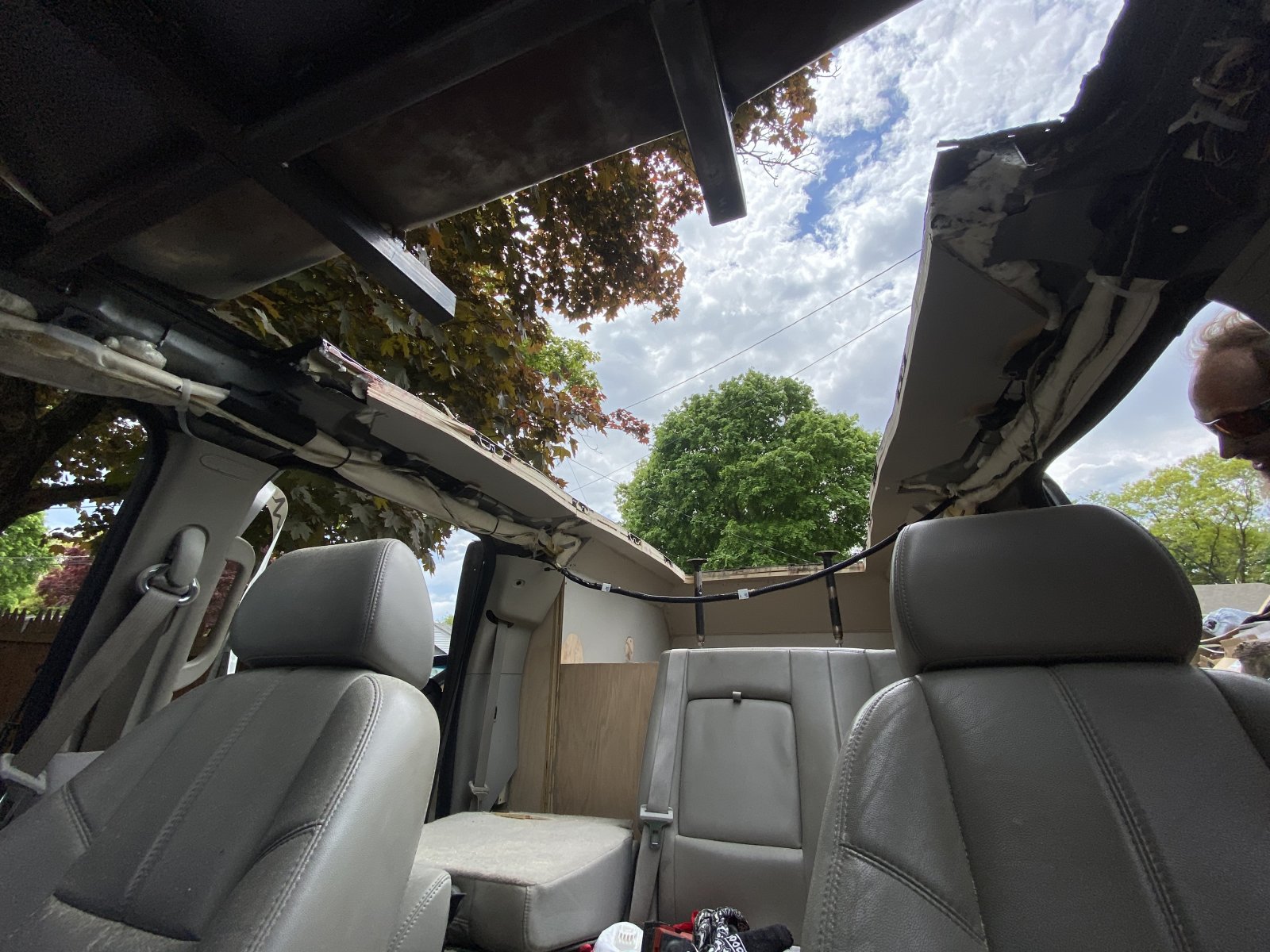

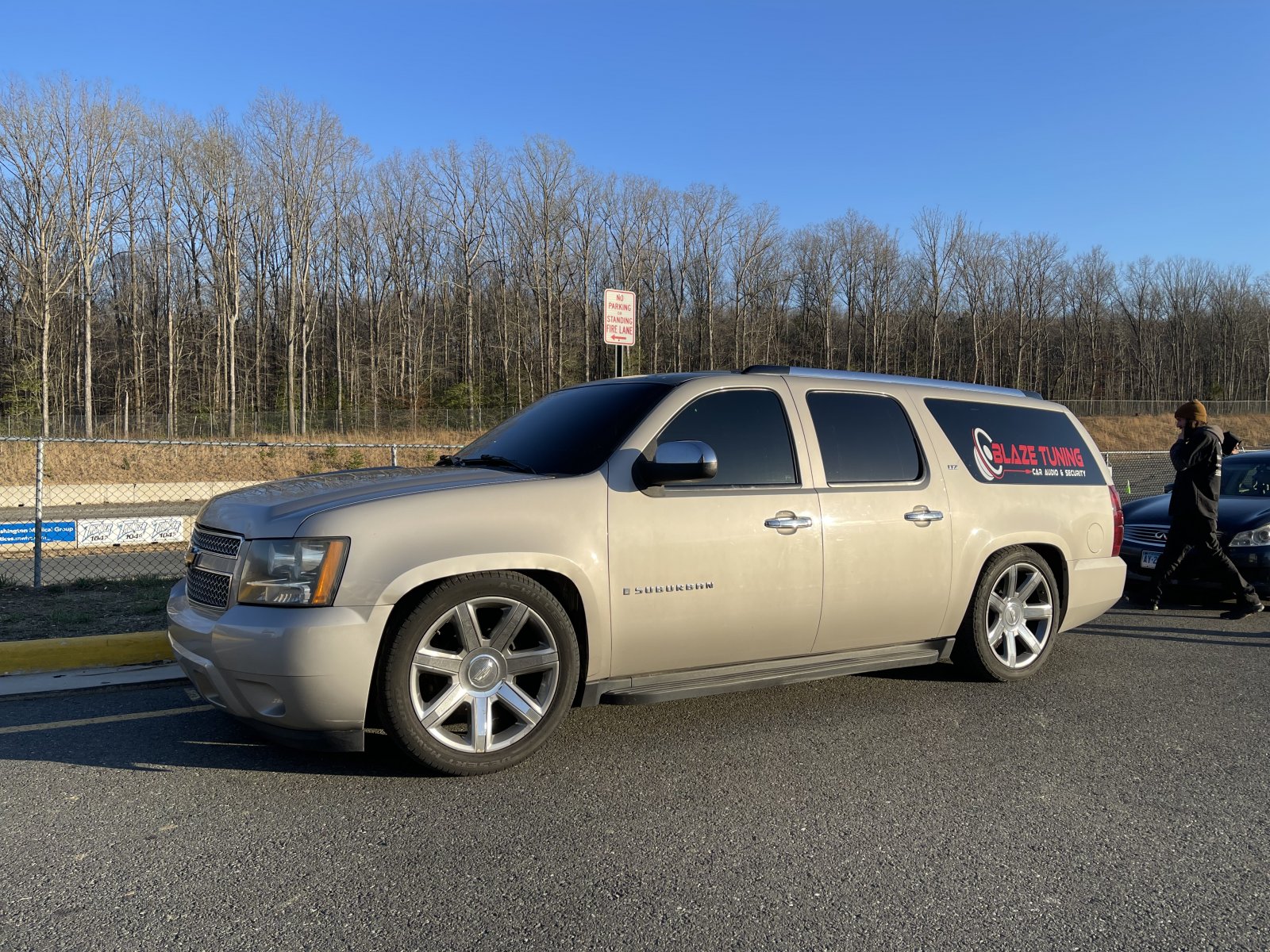

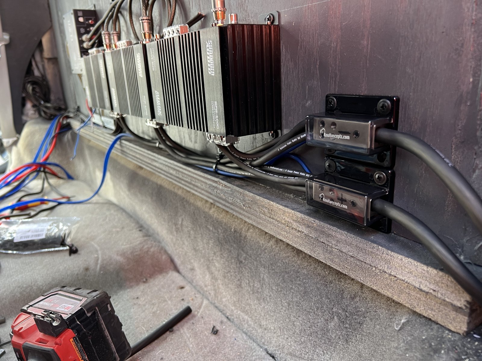

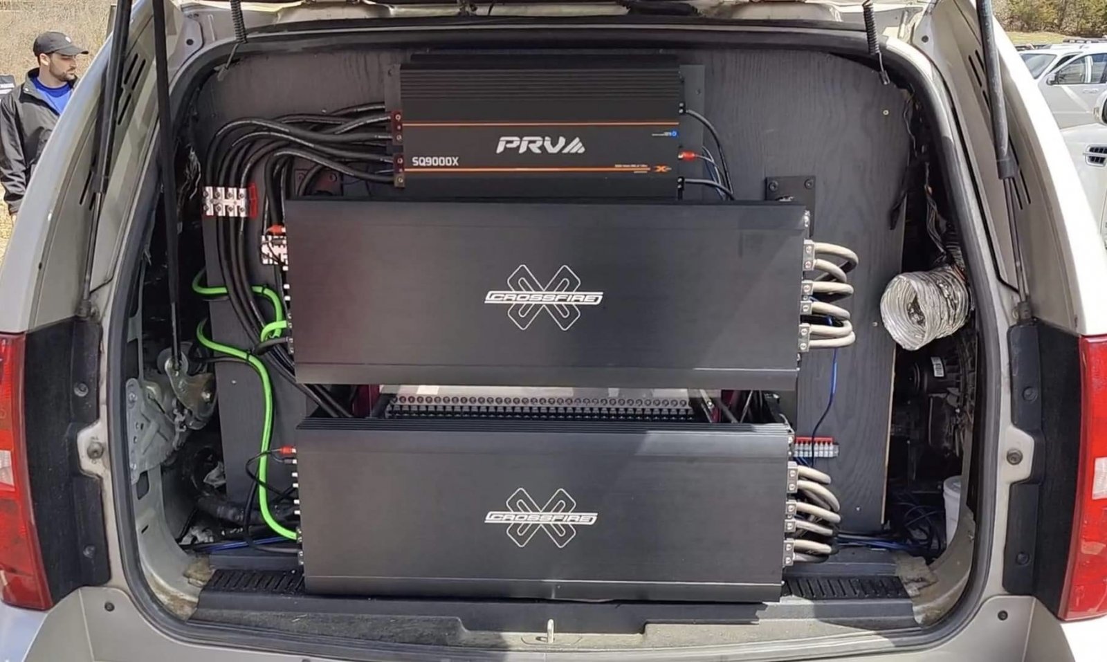

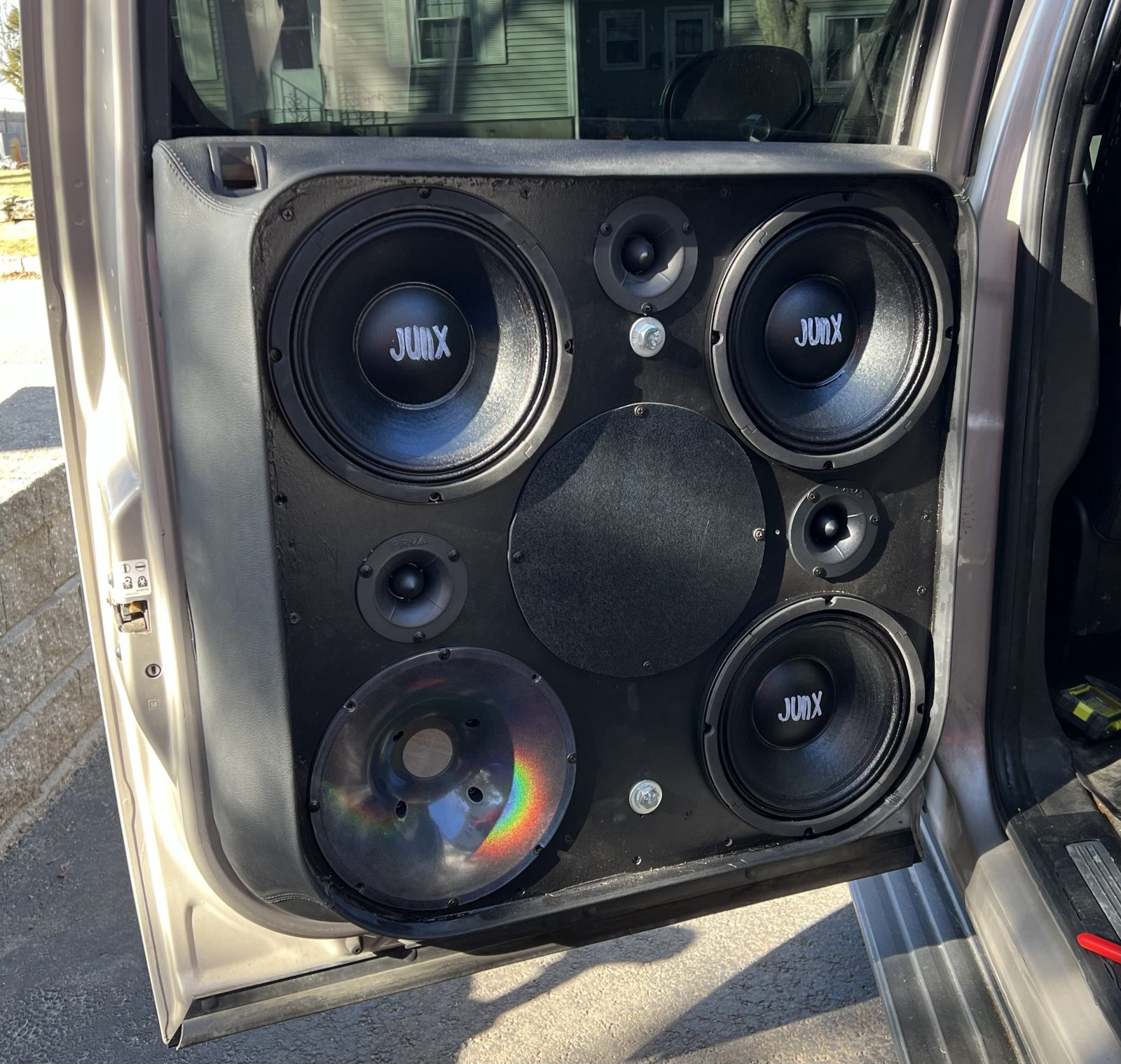

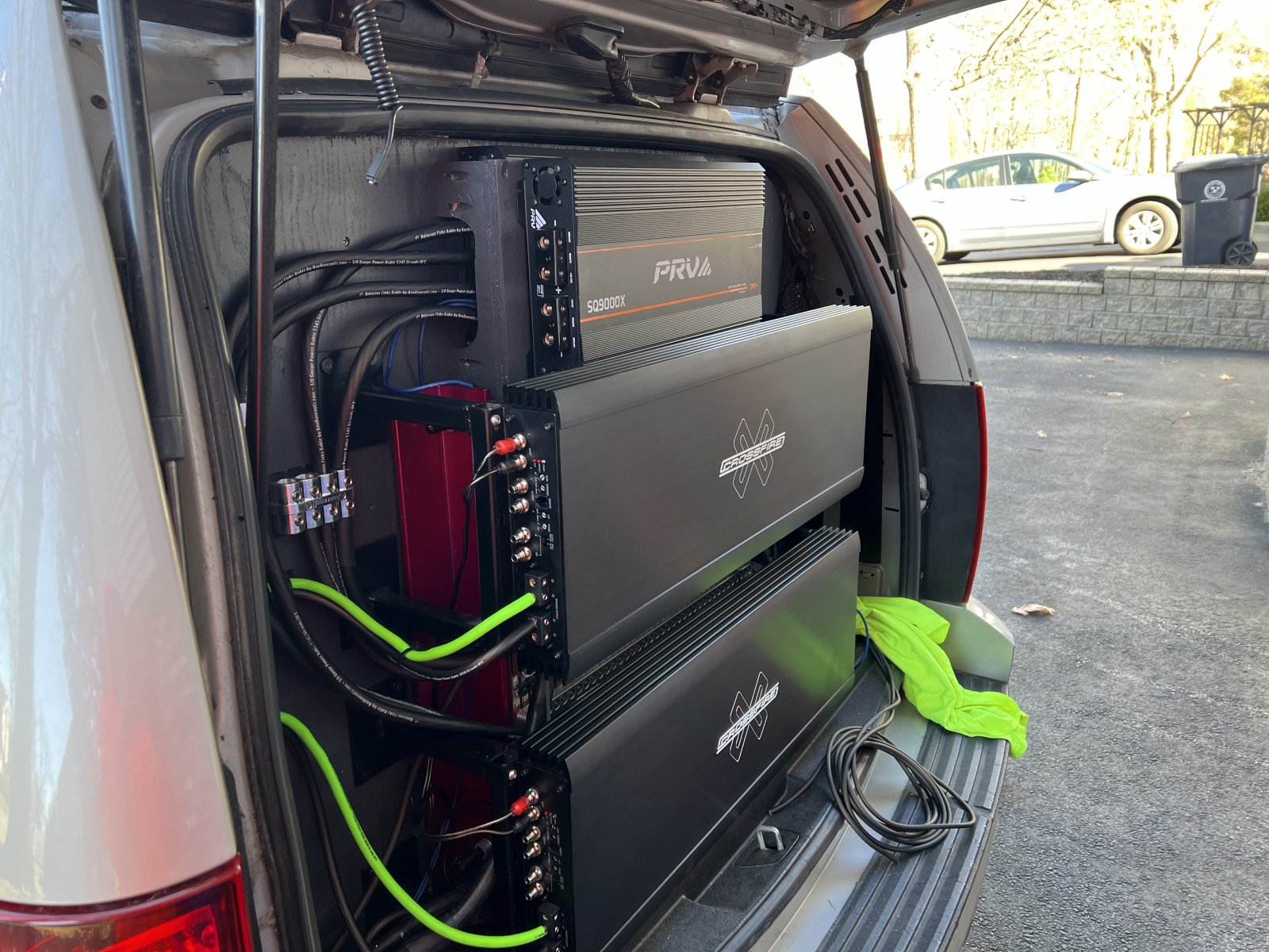

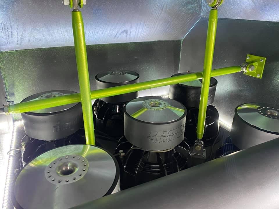

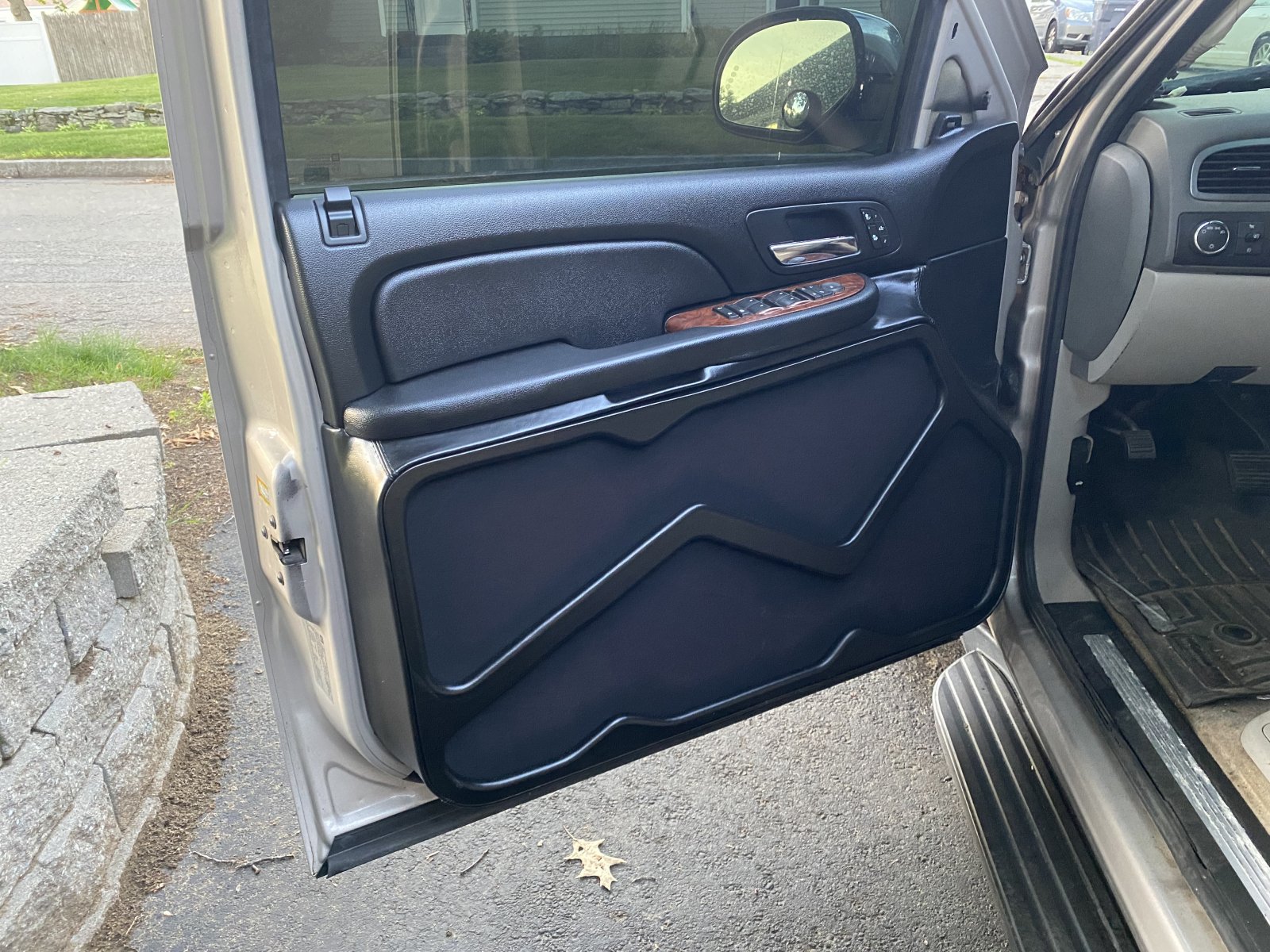

This poor truck is busting at the seams (literally). It’s hard to fit this much equipment and still seat 5 people but we got it done
12 10” midrange
12 tweeters
4 horns
6 15” subs
~40,000 watts total

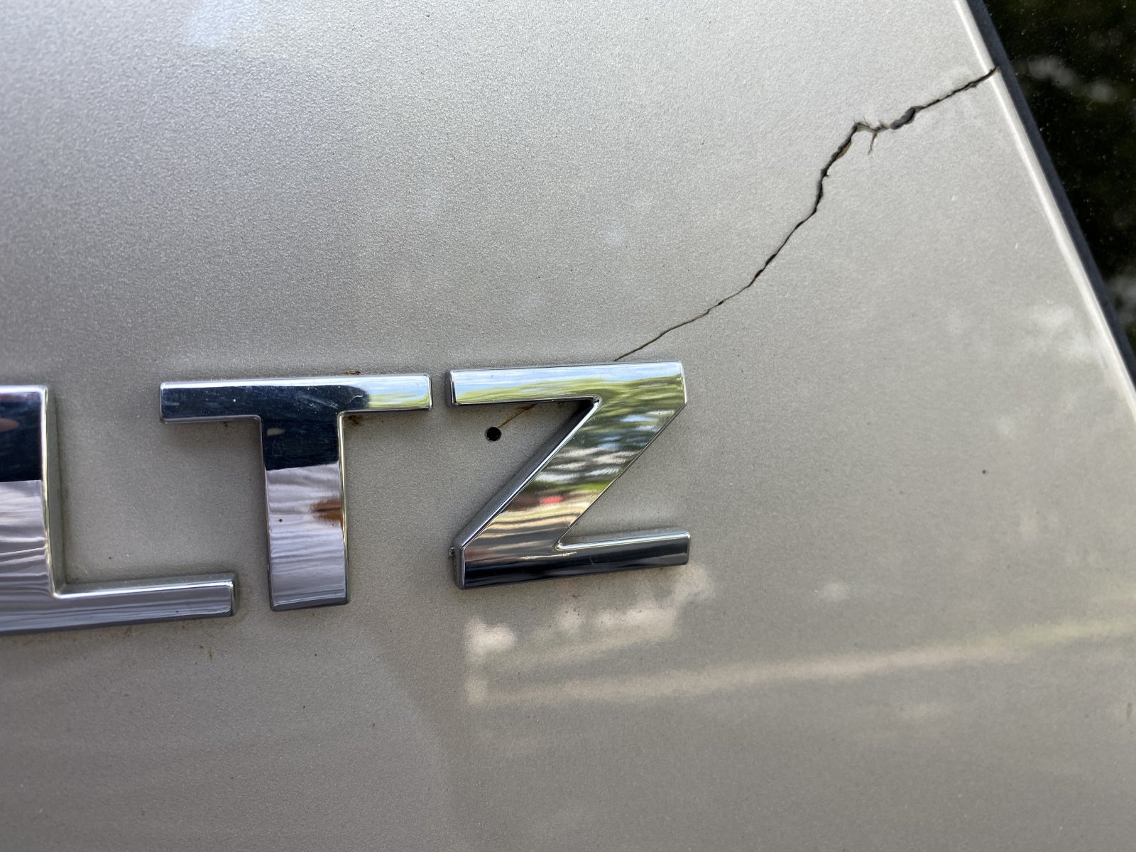

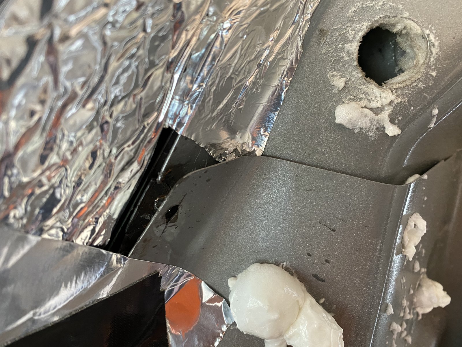

Wow...I've never seen a c-pillar crack like that.
Something is going on there. Crack appears to begin at a hole drilled into the body and radiate out from there. That may be more than coincidence..? Strange for sure.

The hole is a stop-drill hole to prevent the crack from spreading further. It appears to start at the window frame and they drilled the hole where the crack ends. It's standard practice to use that same technique to stop cracks from spreading on aircraft fairings and such. What I can't figure is what would cause the c-pillar to crack like that. Must be some stereo! Lol.

Never knew that.
I appreciate you helping me learn something entirely new here!
Maybe the cabin pressurized enough to "raise the roof", literally.

Is it a truck or a big a$$ stereo system on wheels? The vibration from the bass is probably what is shaking it apart. If you amp up a fart it will break glass! Image what your truck(?) will do!
