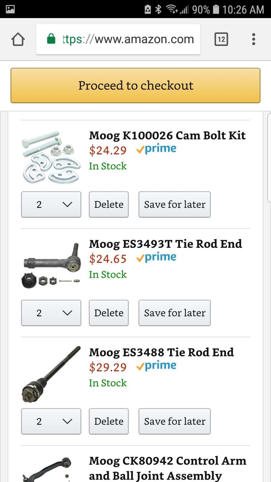

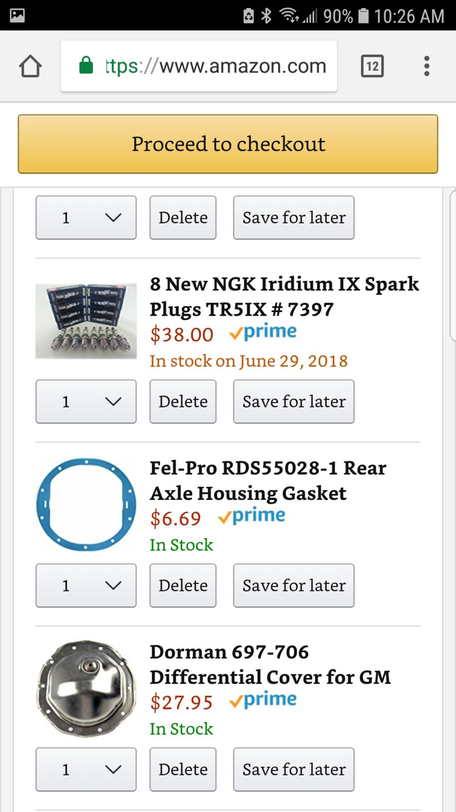

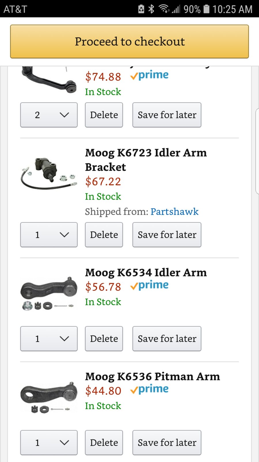

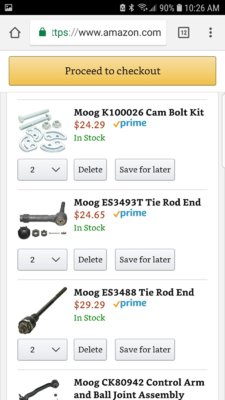

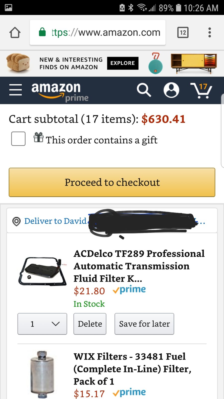

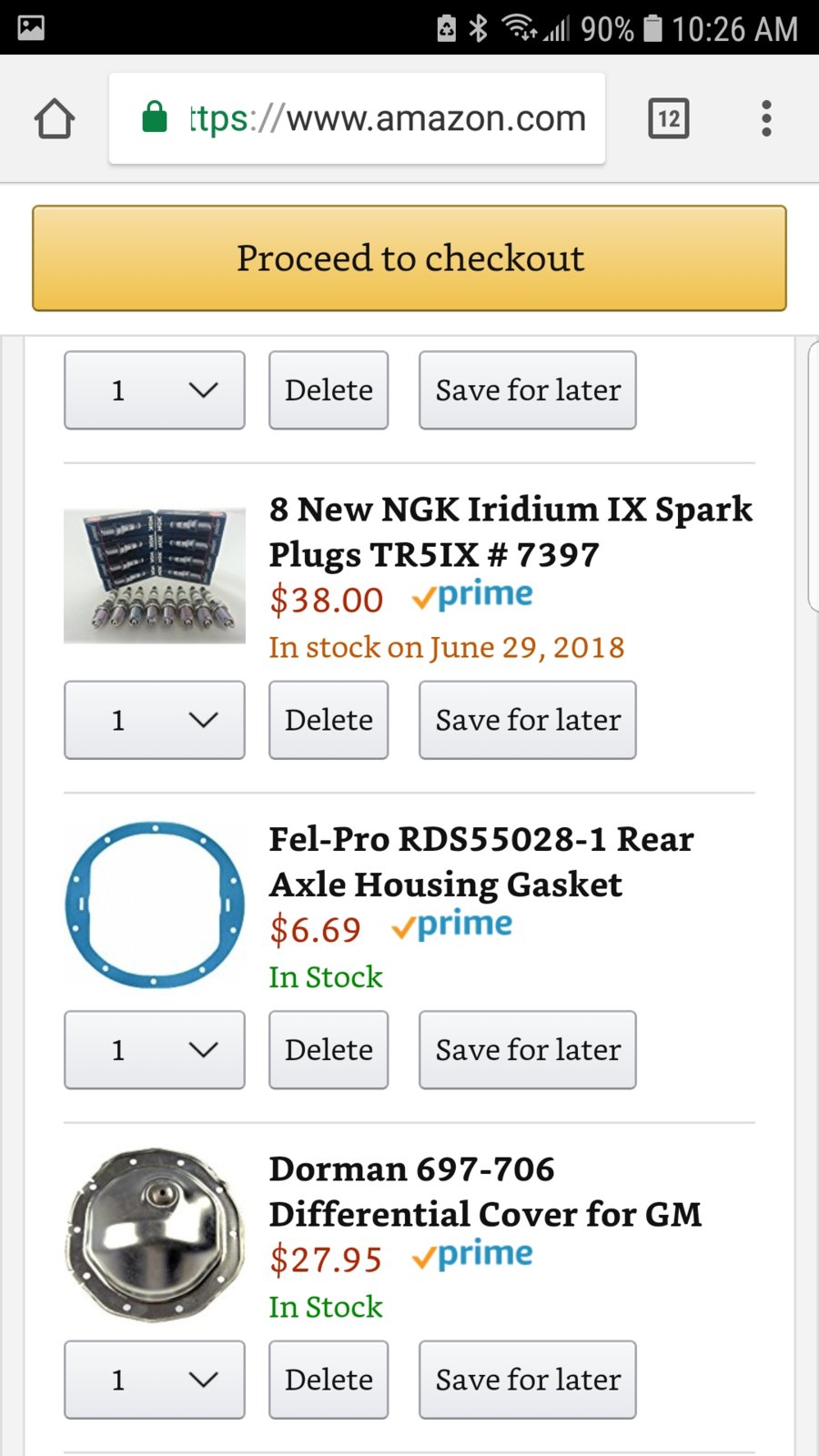

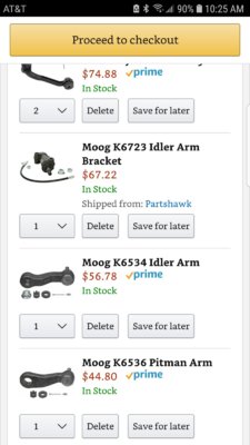

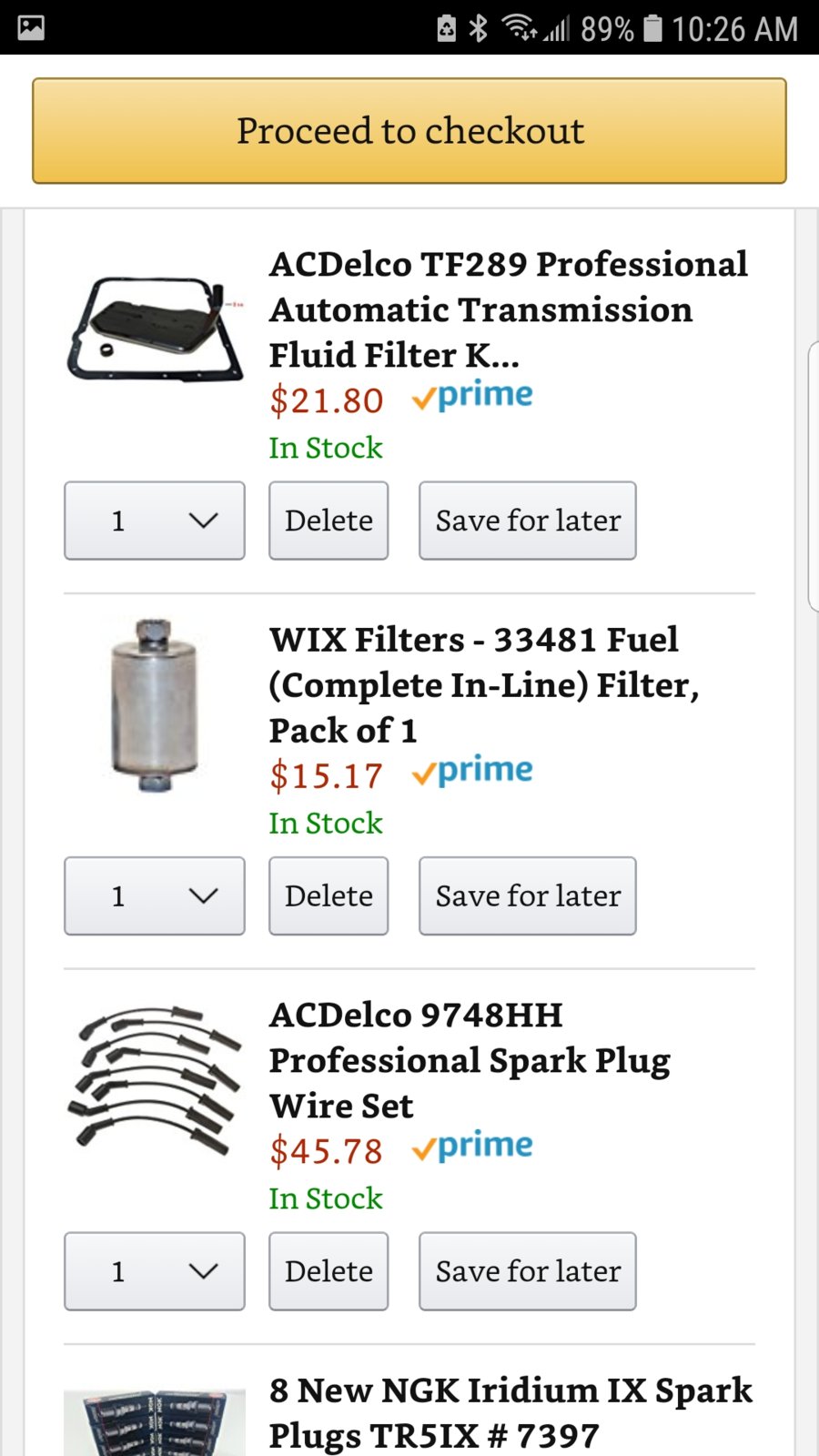

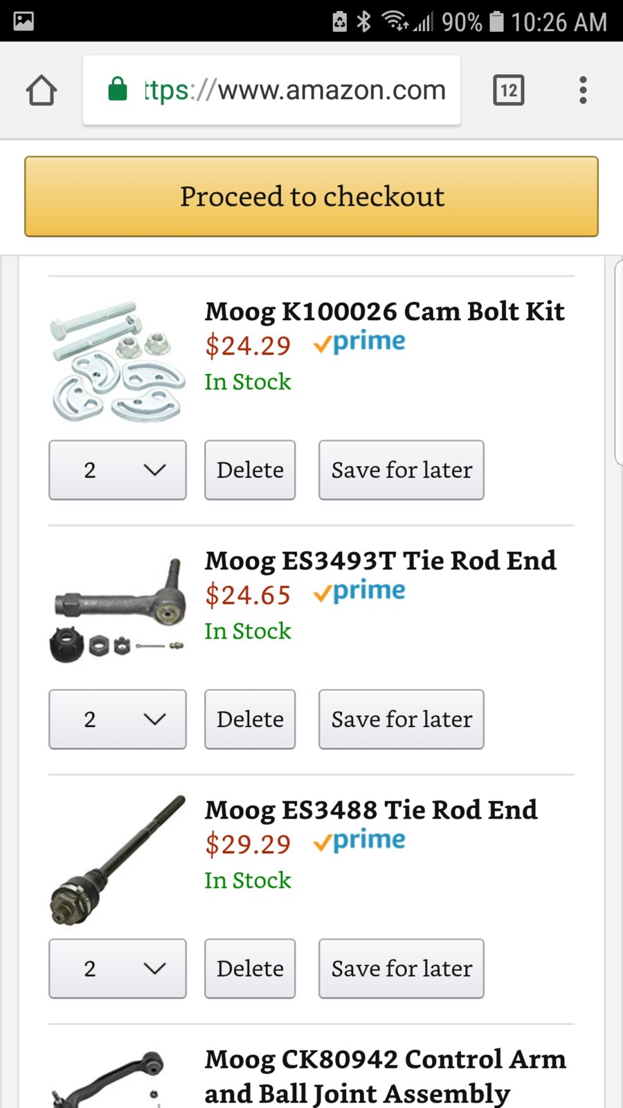

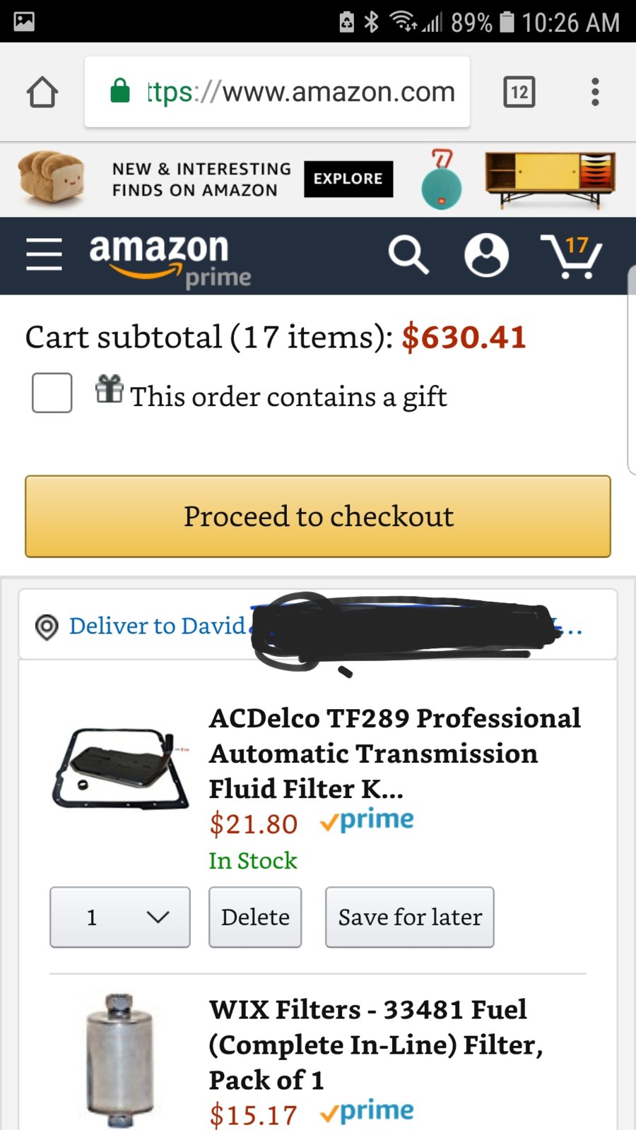

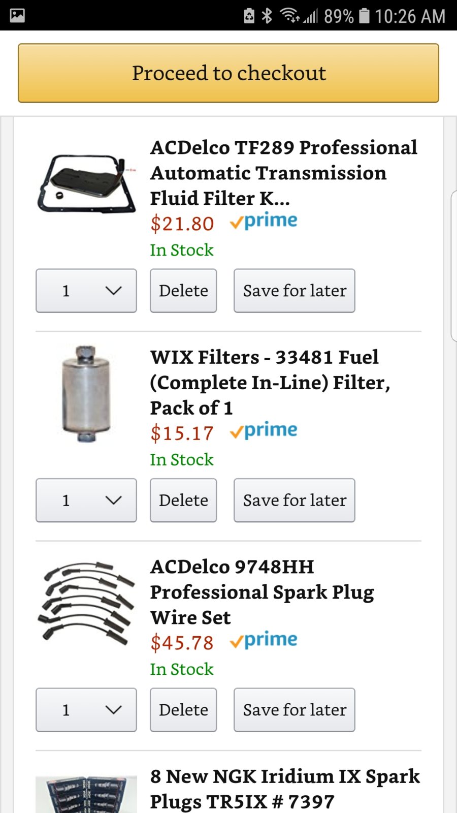

Thanks for all the info. I did a quick Amazon search for a lot of parts and so far I'm at $630 lol

My OCD is kicking in because all of the parts are Prime except for the idlers arm bracket....

Two things I see.
Forget that fuel filter. Your truck doesn't have one. Yours just has the pickup screen in the pump. Also, do a little search on the moog arms. There have been fitment issues with one of them I can't remember if it's the idler or pitman. Guys were using AC delco pro for that one part instead of the moog.
