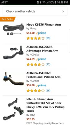

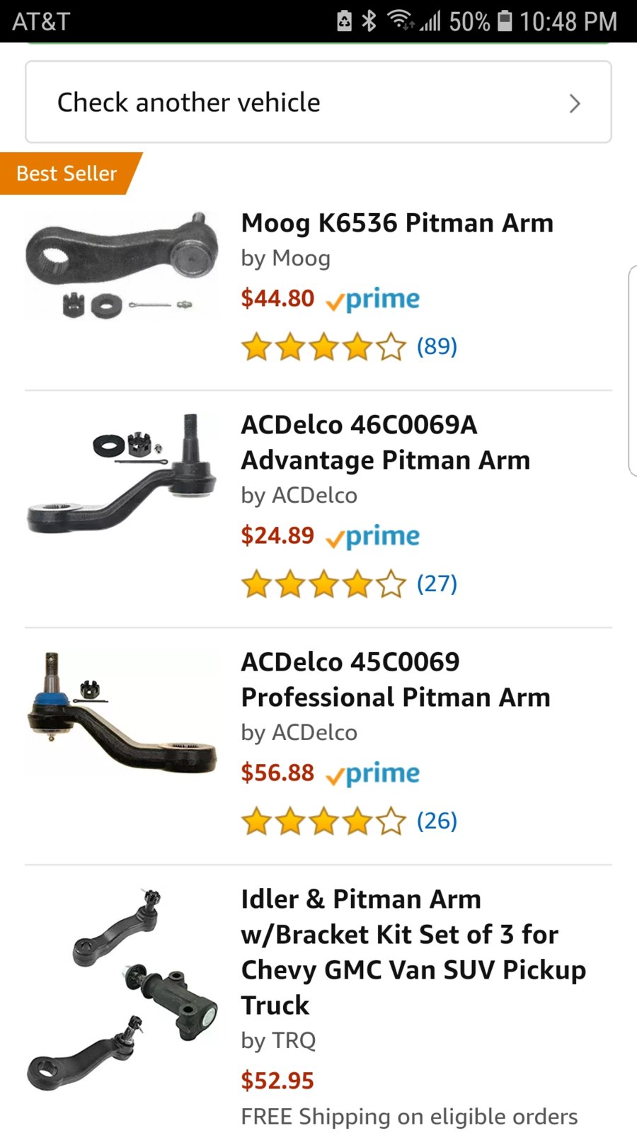

Two things I see.
Forget that fuel filter. Your truck doesn't have one. Yours just has the pickup screen in the pump. Also, do a little search on the moog arms. There have been fitment issues with one of them I can't remember if it's the idler or pitman. Guys were using AC delco pro for that one part instead of the moog.
Cool thanks. I'll remove the fuel filter. That's good to know.
Is the moog problem because people were getting the 3 groove instead of the 4? We need the 4. I can see fitment issues with the 3 groove

No, I'm pretty sure it is a legitimate "won't fit" situation. Do some searching, you'll see it.

That's interesting. Is that a new thing? I've been watching some videos and they use moog. But if the ac delco is recommended I'll swap that out

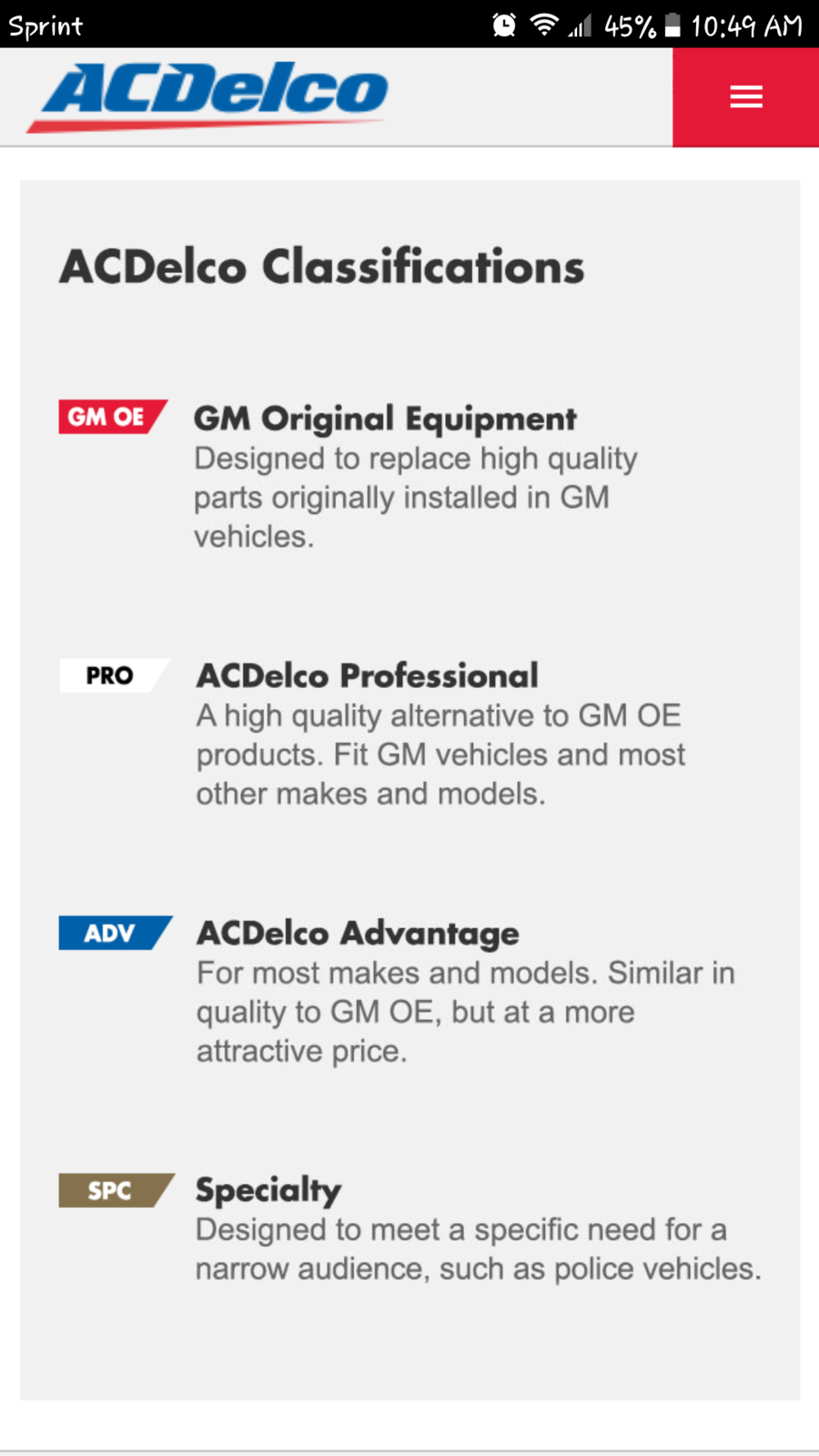

@HiHoeSilver
Ac delco professional?
And is it worth twice as much as the advantage?

Just want to say my OCD wants to thank you. I swapped the pitman, idler arm and bracket to all ac delco professional and they are all Prime lol
Not new. I haven't done mine yet, so I'm just citing what I've read by others as I've researched my job /mod list.

Yes. "advantage" is a subpar line. OE or professional, imo.

Again, not sure if it's the idler or the pitman. It's one of them. I know you've been open about not searching... But you need to search, bruh. Lol.
Lol I searched for the suspension stuff just not what is recommended for 100k service lol.
Plus I'm pretty knowledgeable with a wrench lol I appreciate you're advice tho I was unaware of the moog problem. I've had great luck with moog so far at least the problem solver line up
No doubt. Problem solver all day. Just looking out as there have been threads dedicated to ONE of those parts not fitting right.
