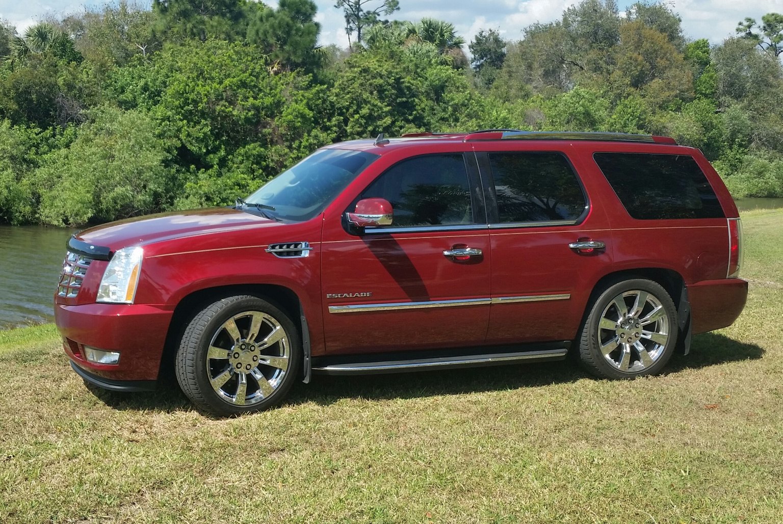

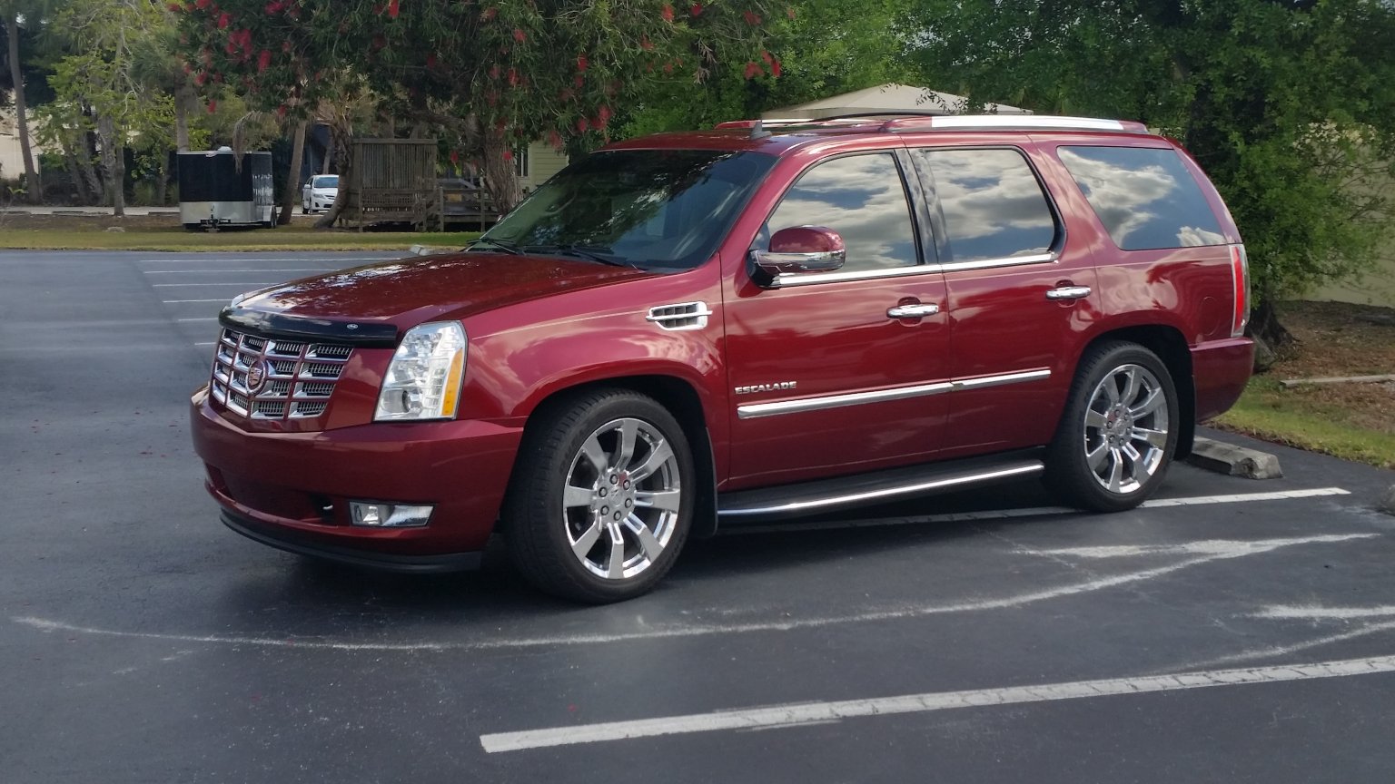

Here's some picks, not radical but nice daily driver
Fosscore
Apr 16, 2014
10,866
19,745
The 375s look good on there. Bug shield is definitely a personal preference item but that Esky is sharp.

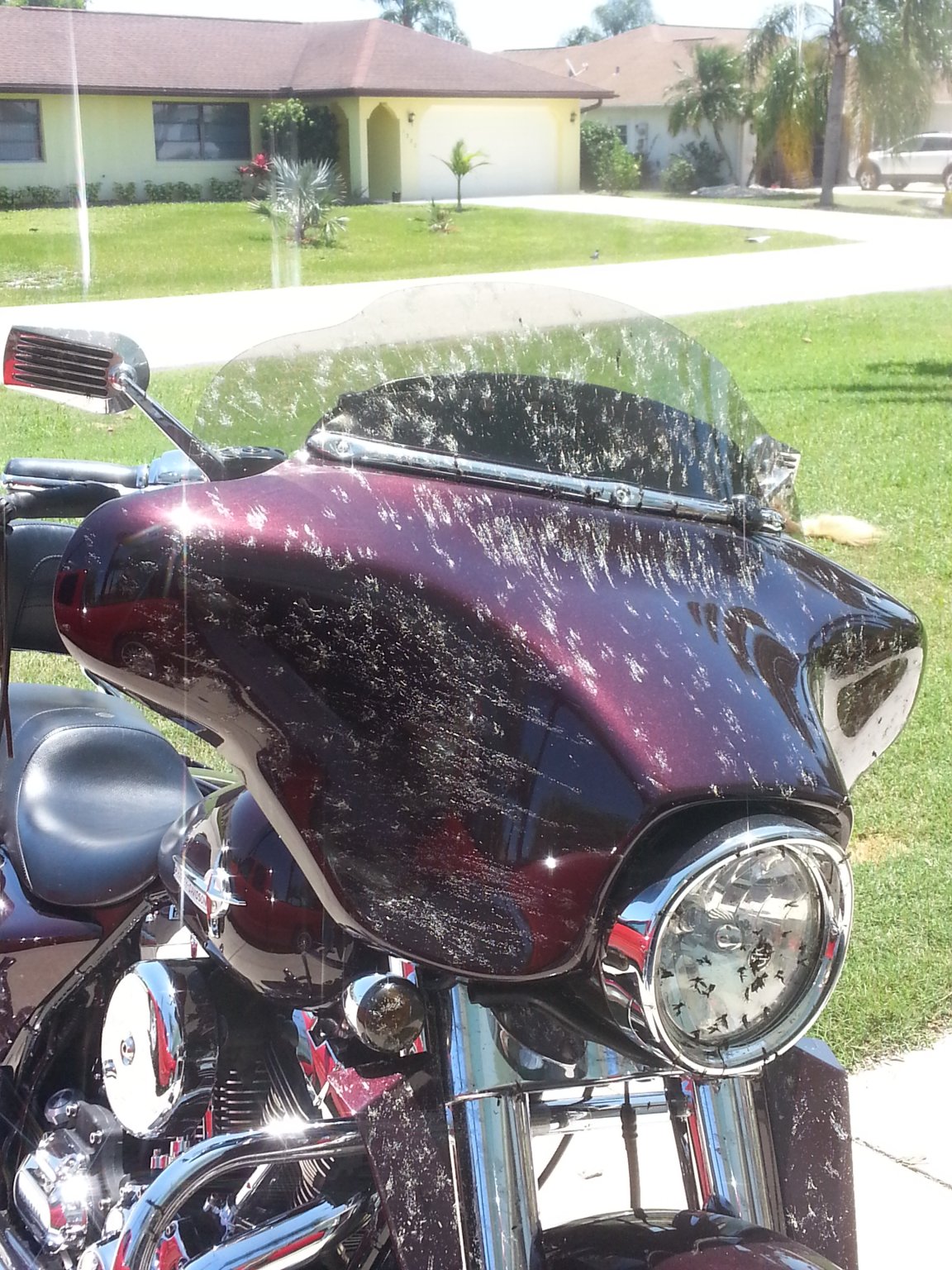

i live in florida and even a short trip to the store can be an adventure with bugs and you don't even want to know about love bugs
T
tom t
Feb 8, 2017
14
Check out my bike after a sunday ride in love bug season. These things will melt into your paint if ya don't get them off... little trick we use is dryer sheets, wet them and wipe off the bugs

And I hear you on bugs. Sunday rides during the summer can get messy in the evening during bug season
