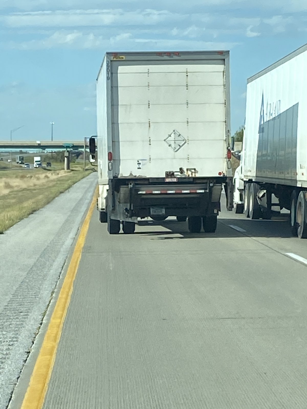

Thanks so much I had no idea about thrust alignment.
Yeah, you don’t want your truck tracking like this.

Exactly. When you have rear leaf springs one of the most common causes of dog tracking was a sheared leaf spring center bolt and the only thing holding the leafs together was the tension on the u-bolts attaching the spring pack at the axle. That can be very dangerous.
