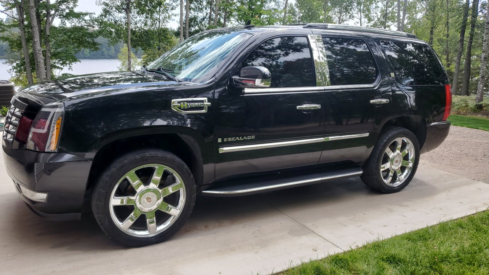

Thanks for the replies and troubleshooting tips. I had a friend stop by and check the engine oil since I'm out of town. Seemed like the quickest way to get some peace of mind by knowing the problem. And y'all were right. The engine oil level is way over filled per my friend so I'm guilty of doing something I've never done in hundreds of self oil changes! Still beating myself up over that one! The good news is that I doubt any harm was done to the trans. I only moved it a few feet before shutting things down. I see that Dexron VI 20W is what it calls for. Any recommendations on which brand to use? Here's a pic

clean looking truck.

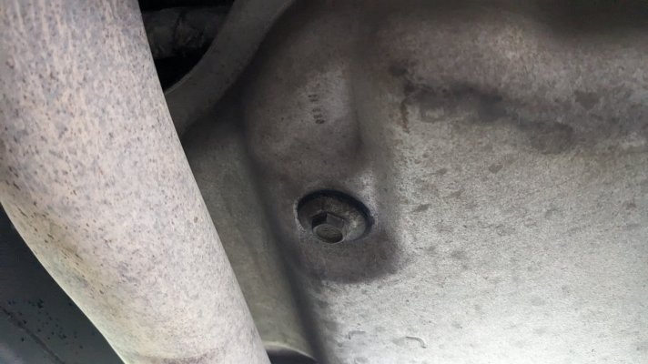

so this is the oil pan drain plug.. it's closer to the front of the truck.

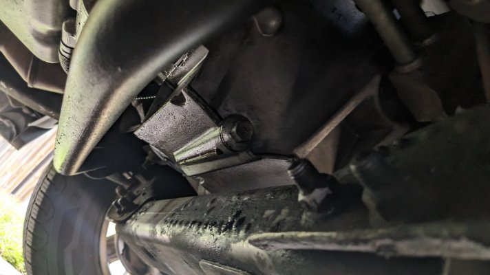

this is the tranny pan drain plug.

Thanks for the pics. Very helpful. I definitely drained the trans fluid. The plug was on a flat cover pan. And I recall the first and only time I did an oil change, it was on the side and upfront. Given that my friend checked the engine dipstick and said it was way over filled, I'm confident that's what I did. Still can't believe it but that's what I get for being in a hurry and not paying attention. Oh well... Thanks so much for the pics.
