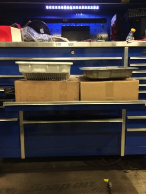

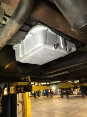

Make it easier on yourself for the future. Add a PML pan with a drain plug. It holds more fluid and is finned to help with cooling. It’s a messy job and can be a pain in the ass depending how you maneuver the exhaust.
I drain and fill 30k and the next time I do a complete trans service with a filter the next time trans is due.

I will keep that in mind when I decide what is my best choice. I just want to make sure I make the right choices when it comes to maintance on my Tahoe. Thanks for the help.
