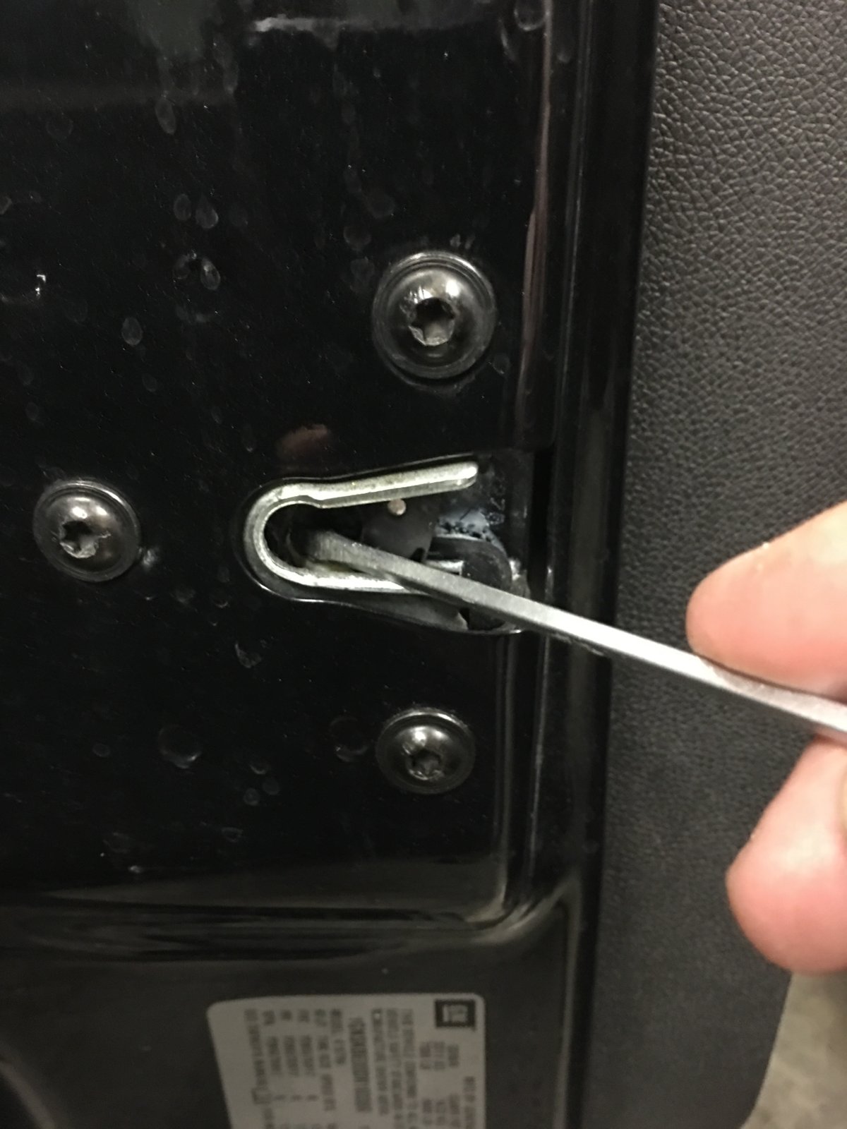

I have looked all around the door and the door jam and do not find a door switch anywhere. Any suggestions?
kbuskill
Mar 11, 2017
5,861
9,931
NE. FL.
It's in the latch. Try spraying some WD40 or something in the latch and opening and closing the door a few times... it may help.
