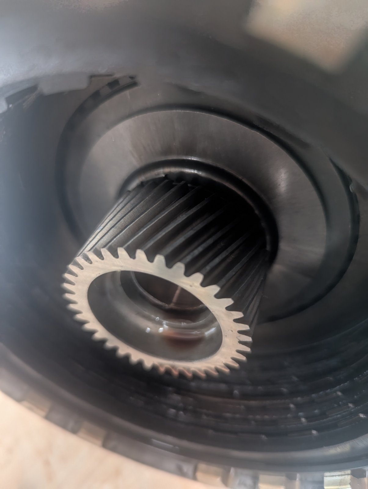

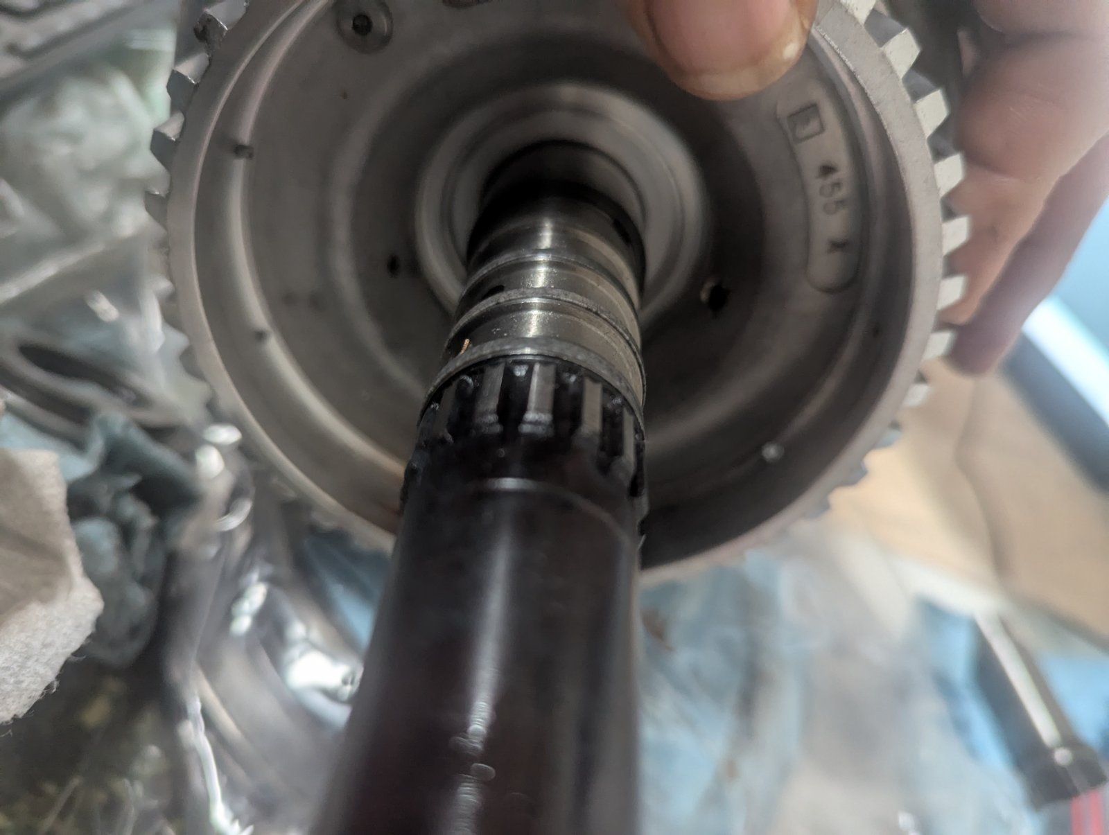

I'm working on rebuilding a 4l60e out of our 08 Tahoe. Teardown went well for my first time, putting together a parts list, and I'm inspecting a few hard parts that barely concerning to me. Posting pics for reference as soon as I figure out how to haha

I don't pretend to know anything about automatic trannys but I seem to read looking at drums for cracks and stuff more so than gear teeth issues.
seems there's a few common things to look for damage in each different tranny. I don't know what that is thou on yours.

Yeah, I used his teardown video for reference. I just am not sure about if these are within any sort of tolerance. I've never seen known good parts as this is the first time I've taken one apart

@NickTransmissions picking your brain just a bit. I've been reading a lot about stepped cut rings being inferior to solid Teflon rings. I'm torn between picking up a stepped cut set and trying out one of the lower cost optioned sizing kits and seeing how it goes. Would the quality of those sizing kits be bad enough to warrant just getting a stepped cut set? Also, is that wave on the splines of the indicative of some other damage I should specifically look for? I didn't see any waving on the planetaries but am definitely curious.
