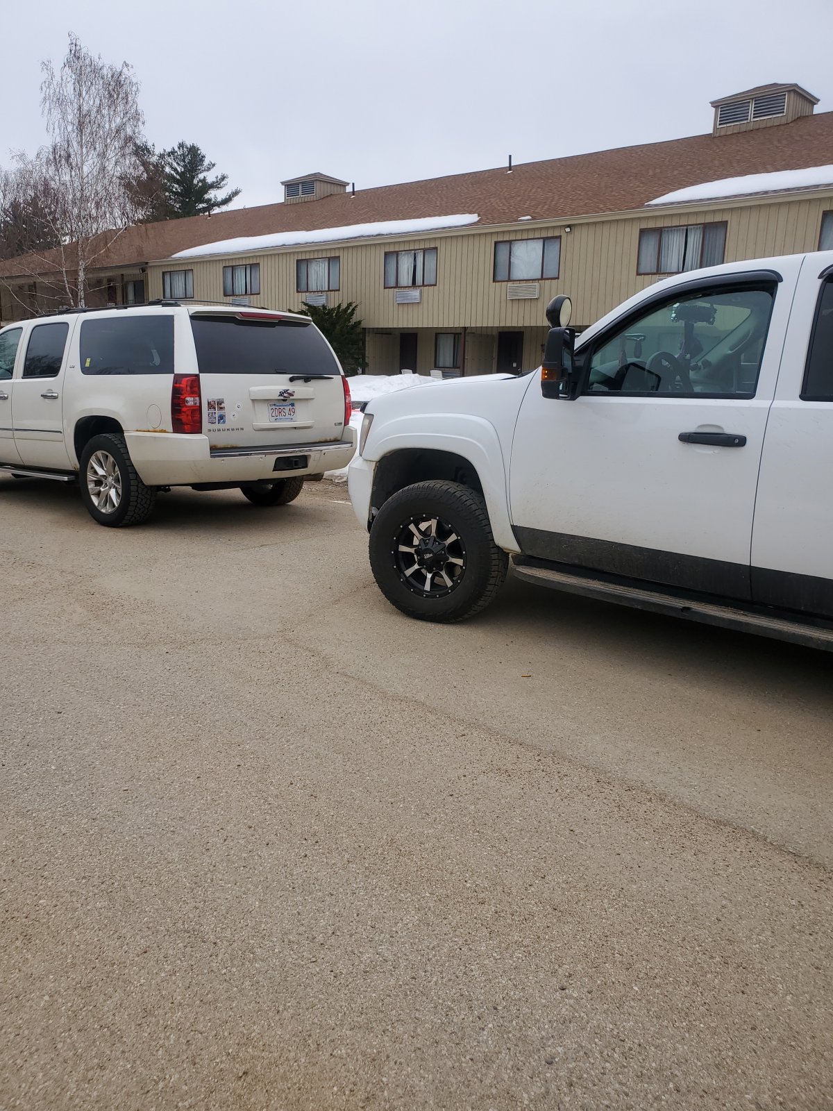

I saw a 07-14 Chevy Suburban that was parked next to mine. Now, I don't know how many different shades of white the GMT900 Tahoe/Suburban came with, but I could clearly see a total difference between the two. See attached picture. mine is the one on RIGHT.

That's White Diamond Tricoat AKA White Diamond Pearl, Code 98, GBN or WA800J.
