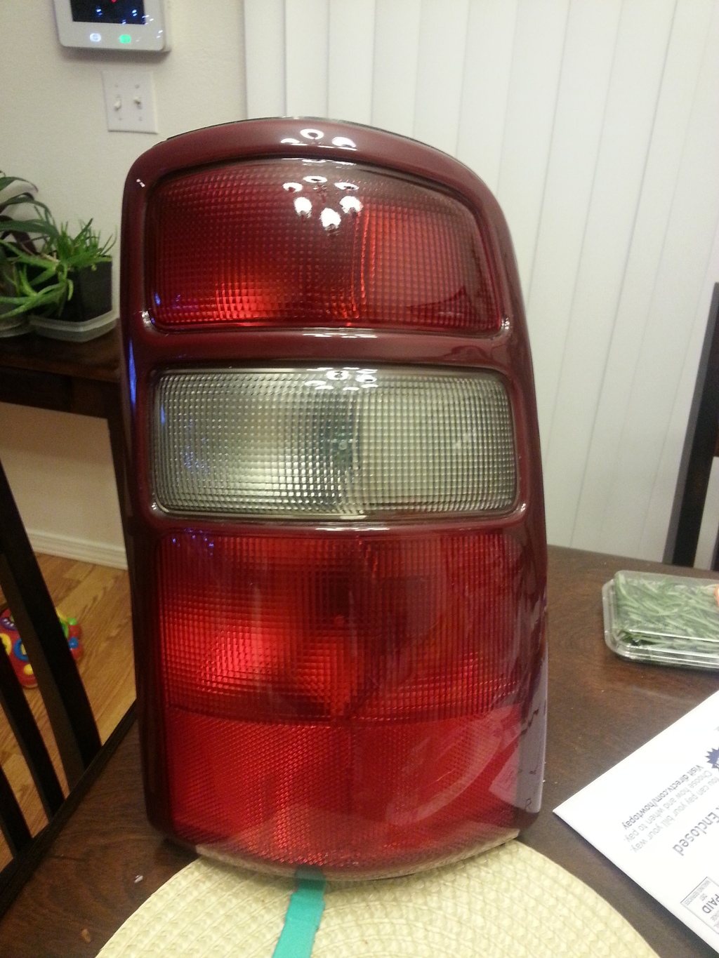

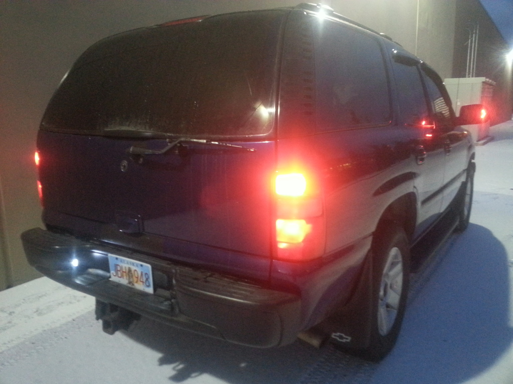

Candied the orange, nothing new. But what is new is I switched the 3156 plug for a 3157 plug so now I have top and bottom as constant on parking lights and still have turn signal up top and brake on bottom.
Parking lights only
Turn signal

Yes, the plug is a 3156 which is just 2 wires-negative and positive.
I changed to a 3157 plug which has 3 wires-negative and two positives.
The extra wire is brought down to the bottom light and wires into the running light wire
You will have to shave a small amount of the plug tabs, I recommend not shaving the actual housing , that's what most do....but I figure plugs are cheaper than lights lol.
Anyway it's the same method as the front drl delete mod

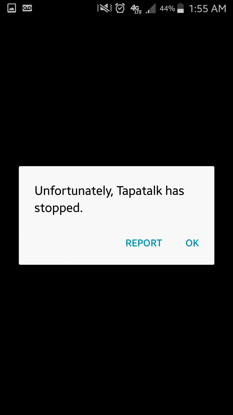

I just can't win, either photobucket or Tapatalk quits on me constantly through the day. Most time can't upload pics on mobile site with my garbage ass phone. Never easy , but I won't quit on you guys lol.
