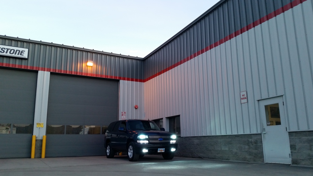

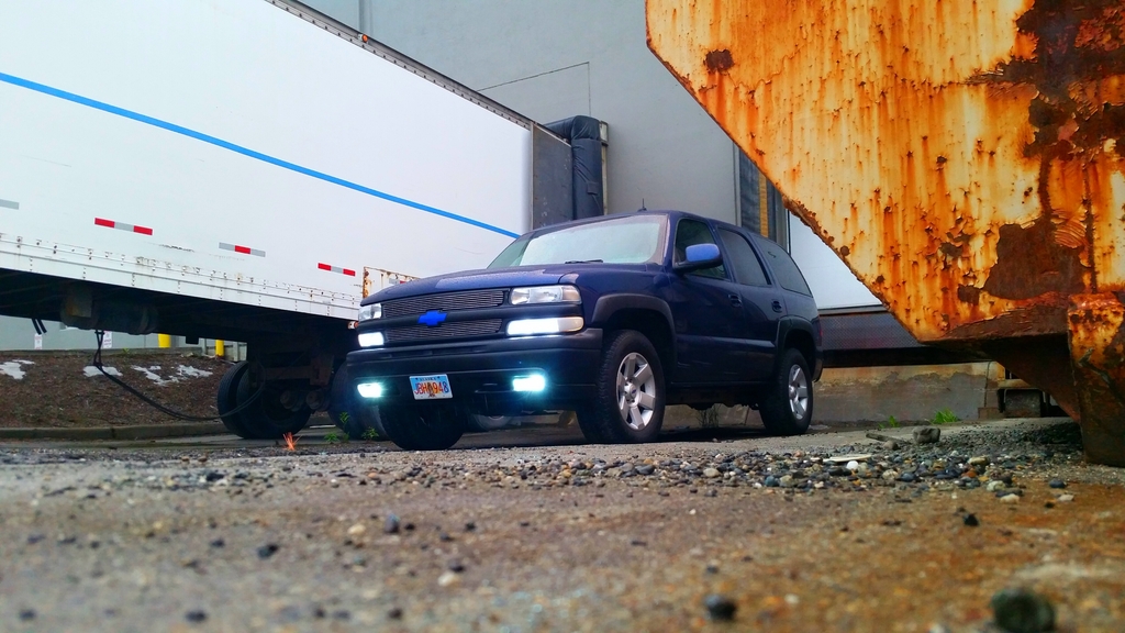

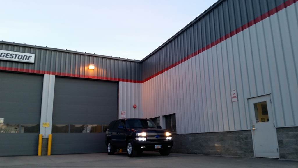

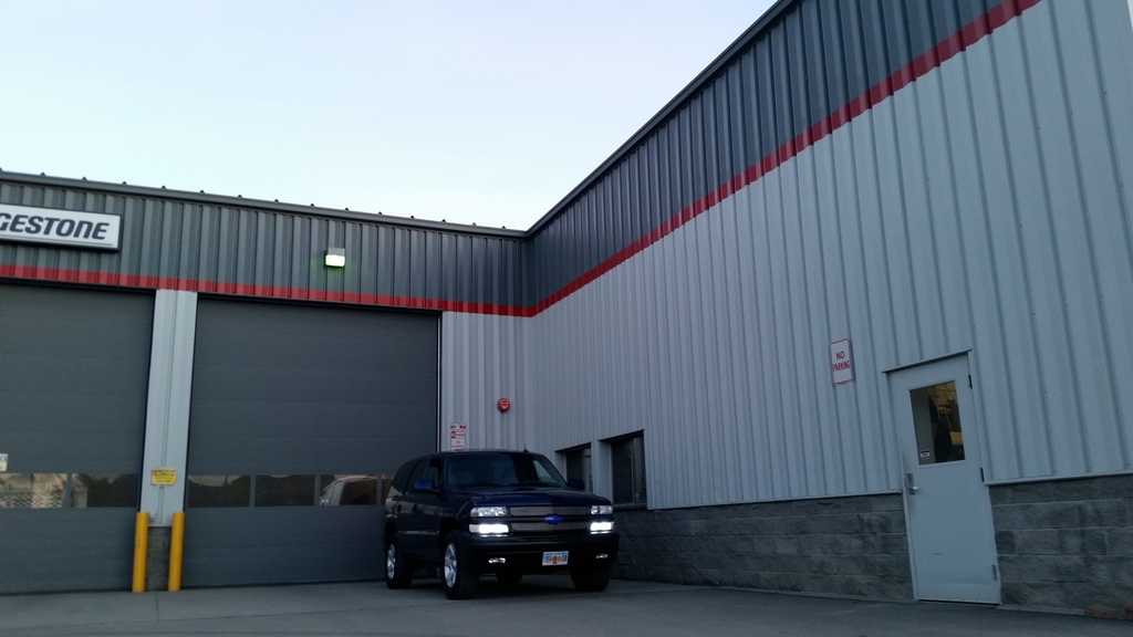

Couple pics.
With winter 3000k fogs
And now with summer 6000k fogs.
I really need the 4HI mod
6000k lows
Halogen highs
6000k switchbacks
