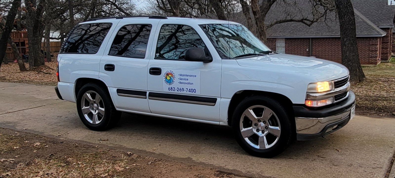

Hey guys I lowered my 04 2wd in the rear with 4230's.the springs are pretty compressed so I'm swapping them out for belltechs tahoe 3'4 coils.
I don't know what air assist bags to use.i plan on hauling 5-6000 pounds behind it from time to time.any advice appreciated

I have the AirLift 60742 kit installed in my Yukon that's lowered 2"/4". They work great when I was pulling our camper with it. Hardly any squat in the back at all

Like @drdave81, I have Air Lift #60742 bags in mine, lowered 4+ inches. I've towed and hauled.
