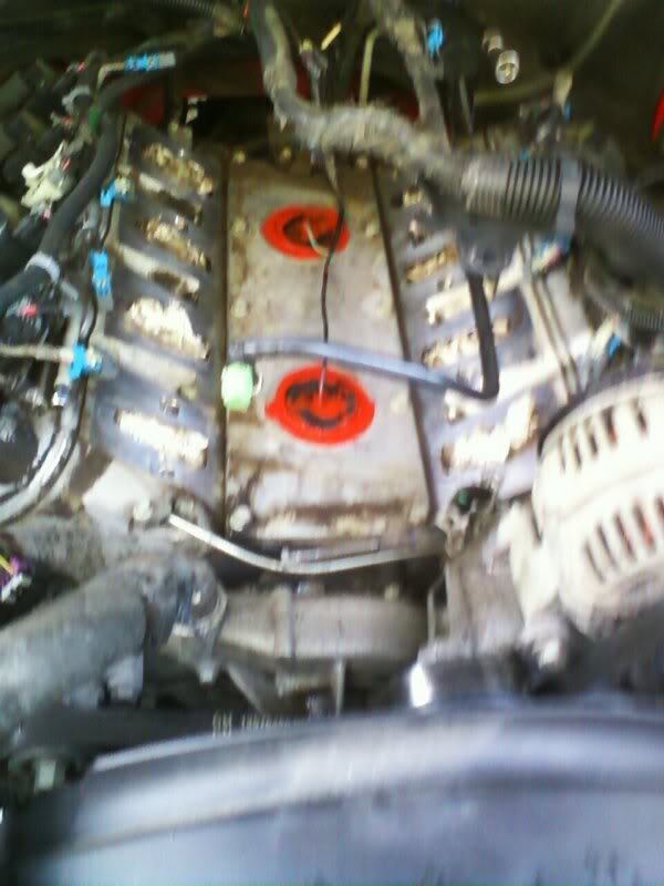

im not implying you aped em in there at all. but 14 fp is like nothing. why it matters.
if you had them foam pieces under the intake toss them, and rtv the foam seals to the valley cover to keep water out of them.

I believe I did toss the foam. I did seal the covers with rtv. So that will be fun to remove. Lol
