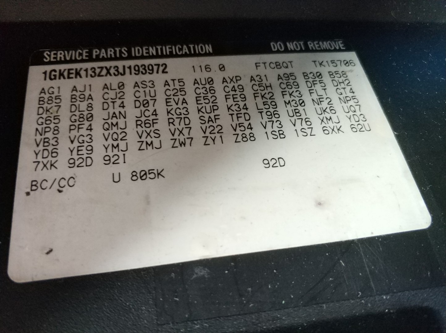

Hi
Here's the pic.
Thanks

Thanks
However I've found this and now I'm confused a bit :) it says "premium"
UQ7 SPEAKER SYSTEM,BOSE,PREMIUM PERFORMANCE
Wysłane z mojego MI 6 przy użyciu Tapatalka
Reading your first post a little closer, I'm looking at the wording:
"Not compatible with premium factory amplified audio systems."
I'm guessing this means anything with an amp, whether it's the lux or not. Your Bose system would fall into the "amplified" category.

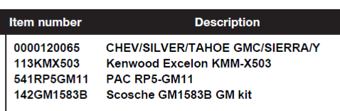

My '04 has the same Bose speakers and amp that you do, but not the same radio (I had a 6CD changer). It's not the higher level Bose (as @HiHoeSilver provided RPOs for that). Your amp and sub woofer should be in/under the center console.
Here's what I just installed in mine, and it works great. Crutchfield FTW. Keeps the steering wheel controls and the sub.
EDIT: your UB1 code is:
AM/FM STEREO, SEEK/SCAN. AUTO REV MUSIC SEARCH CASS, CD, AUTO TONE, DATA SYSTEM, CLOCK, ETR
Thanks. I think, I'll order this RP5-GM11 :)
Unfortunately I can't buy this Crutchfield guide, as I'm not from the US. and it seems they don't send it through e-mail...

What "guide" are you wanting? The Crutchfield fit guide is all online. If you're looking for the installation instructions ("Master Sheet") PM me and I'll email you the PDF.
K
Konrad
Mar 7, 2019
20
What "guide" are wanting? The Crutchfield fit guide is all online. If you're looking for the installation instructions ("Master Sheet") PM me and I'll email you the PDF.
Yes, I meant those installation guides :)
Thnaks, I'll PM you.
