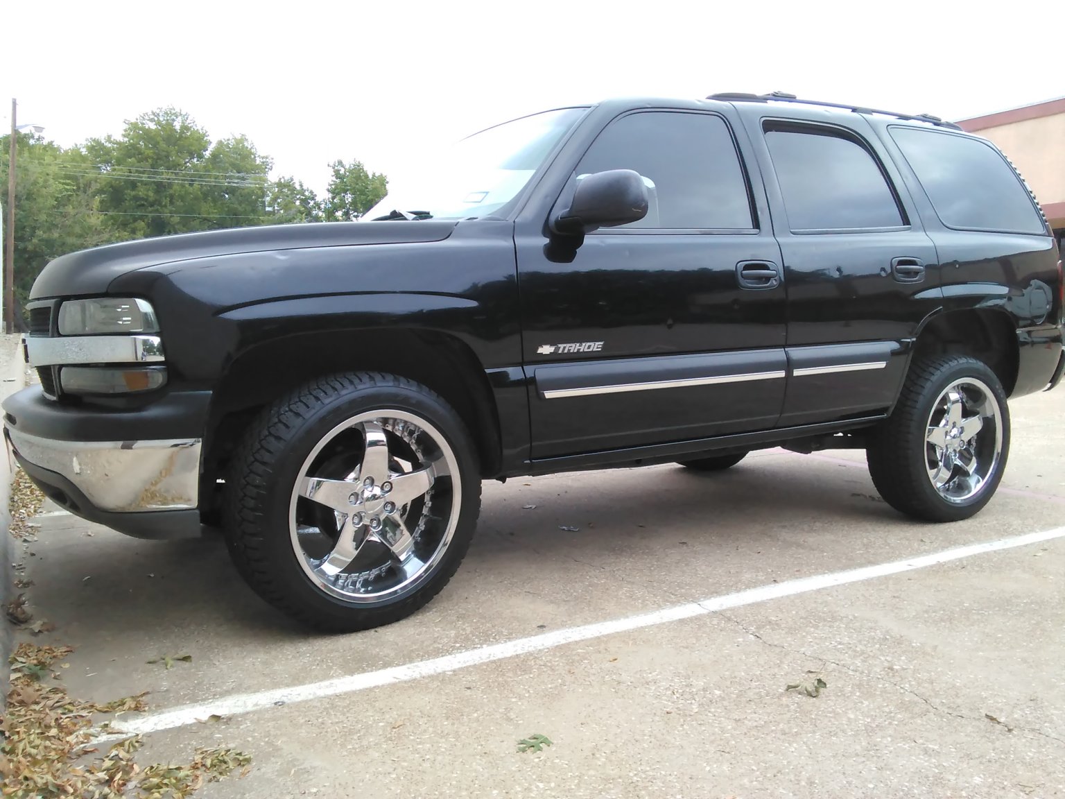

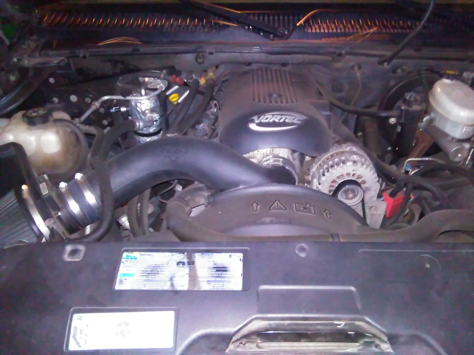

Documenting project on 03 tahoe.
Spyder smoke lights all around
Halo projector
CAI
57 series catback
63019 rear springs
5100 shocks all around
Polyurethane rear 1" spacers
Keys cranked 1 1/2"
2's with 285/45/22 A/T
HD hood (unpainted)
HD grille (trimmed for bumper)
Next
3" lift spindles
2 inch wider stance front
Decrank keys to stock
Front and rear sway bars
Polyurethane bushings front and rear suspension
Moog wheel hubs around
Bump stops
Tint all around
2003FatSo
2003FatSo
Apr 12, 2016
59
107

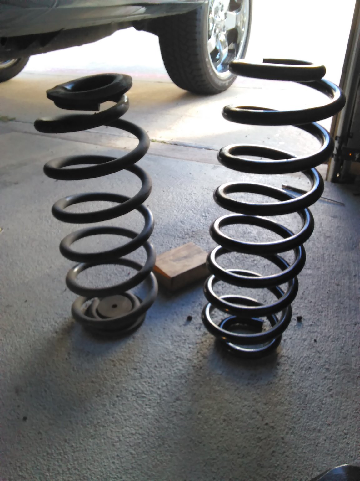

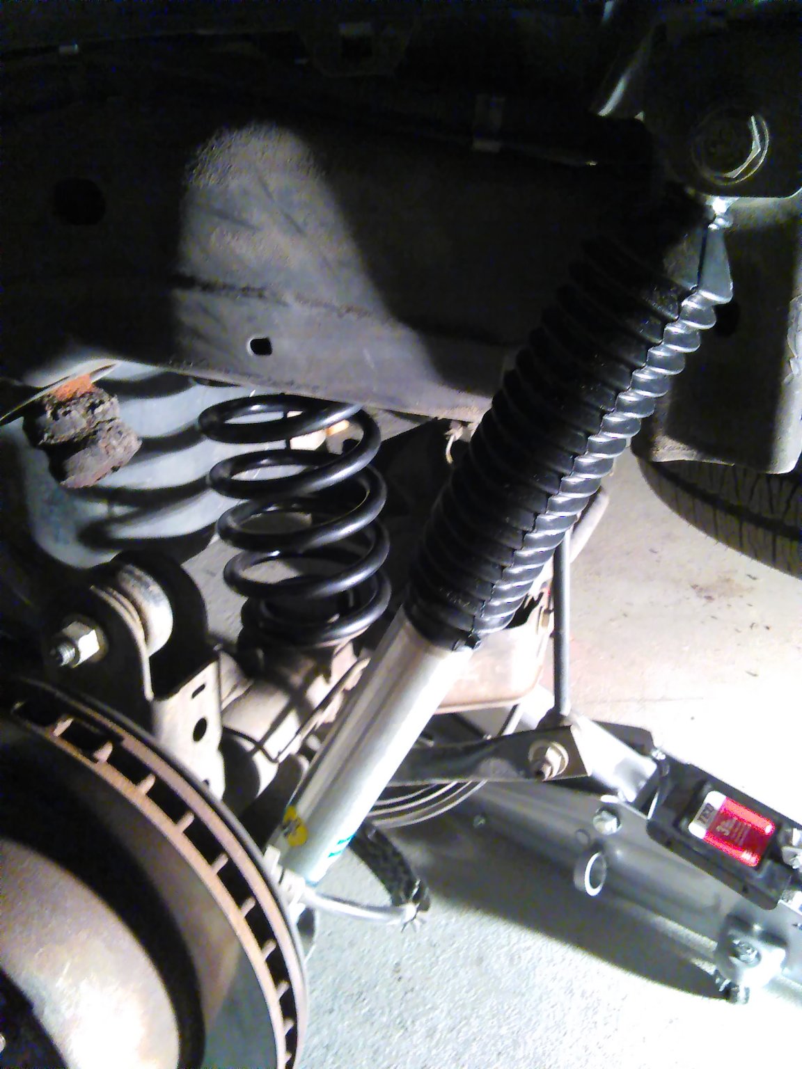

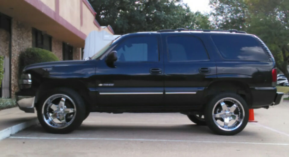

Back lifted 2", 1" spacer, z71 springs
Front 1 1/2" keys
Rear fenders at 40"
Front fenders 37", expecting 38 1/2"

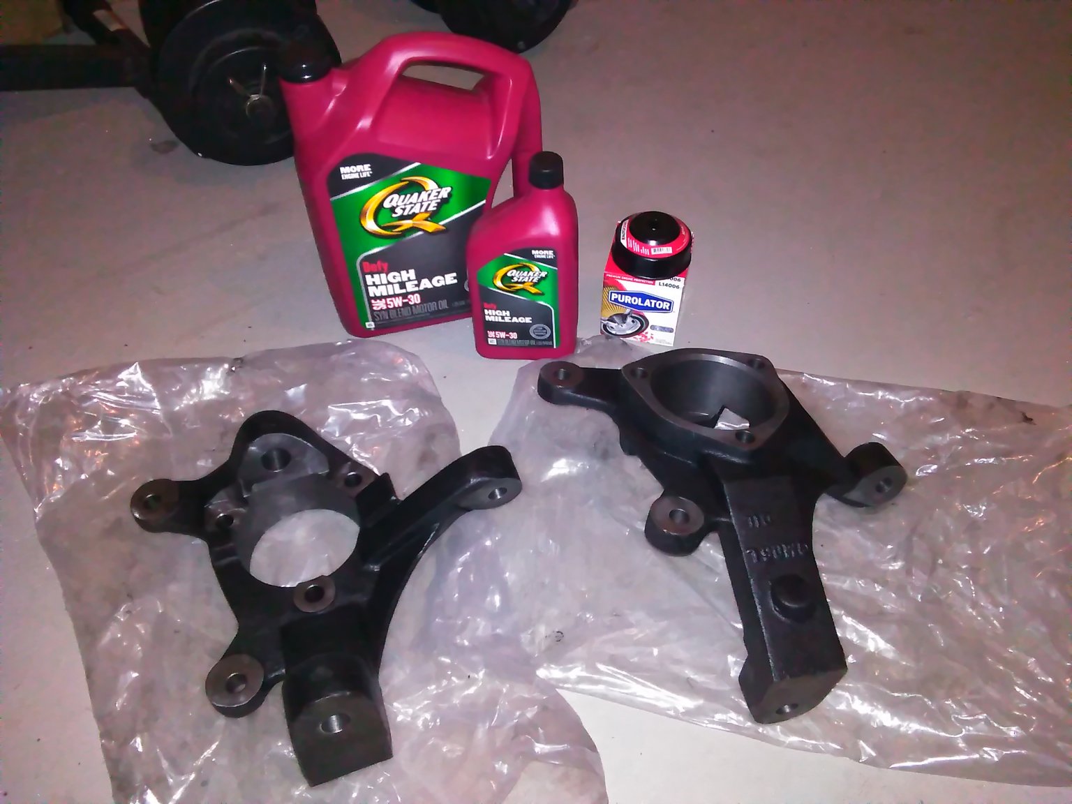

Spindles going to lift higher 1 1/2" after decrank keys. Going to ride smooth. Waiting on hubs and sway bars
2003FatSo
2003FatSo
Apr 12, 2016
59
107

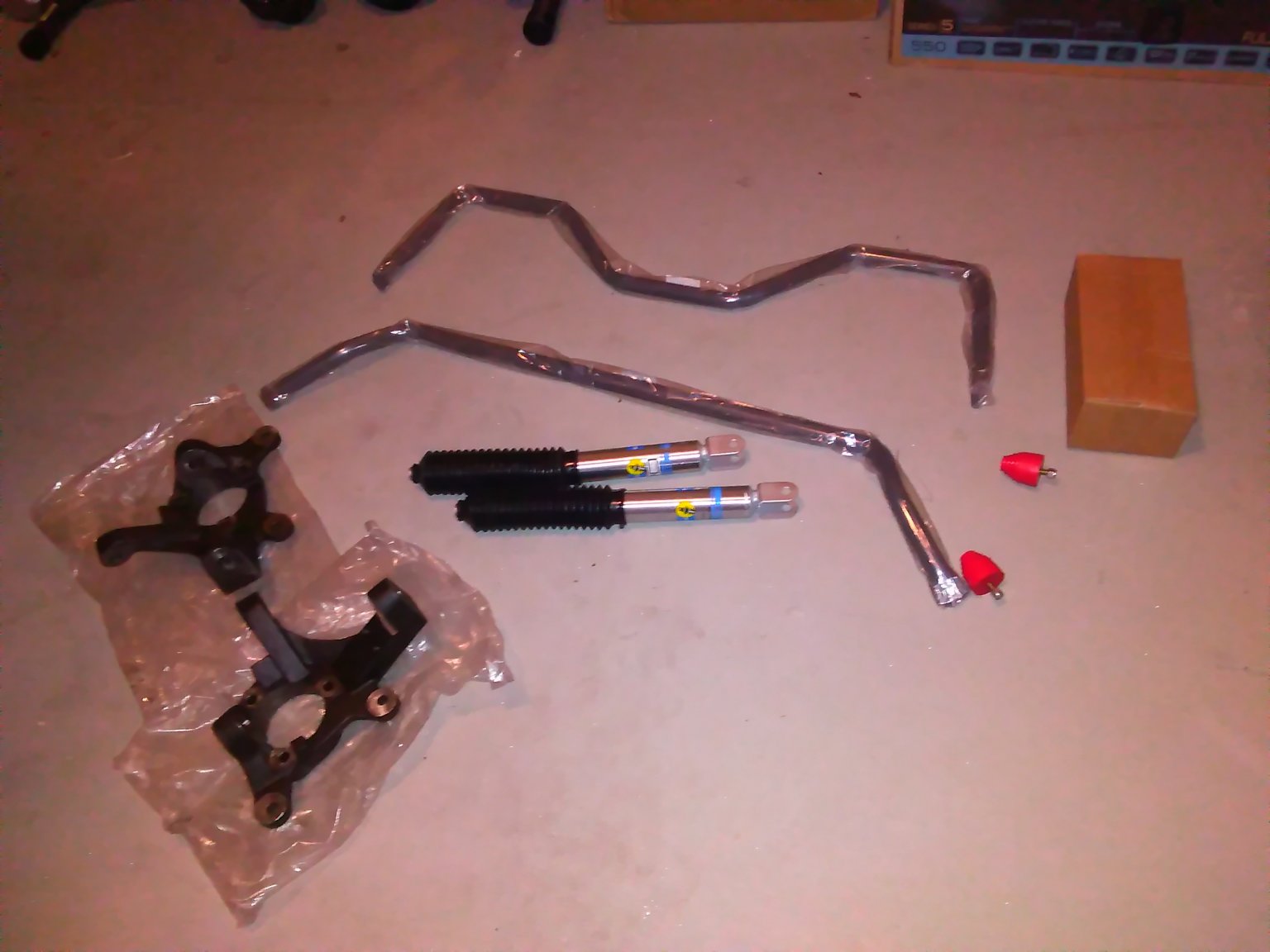

Sway bars and bump stops just came in. Waiting on front hubs and all this is going in. Majority in front. Bump stops and rear sway bar for the back. thinking 2" wheel spacers in the rear. Front track width will increase by 2" per side with spindles. They will only be for rear.

Bell tech sway bars with hardware and bushings.

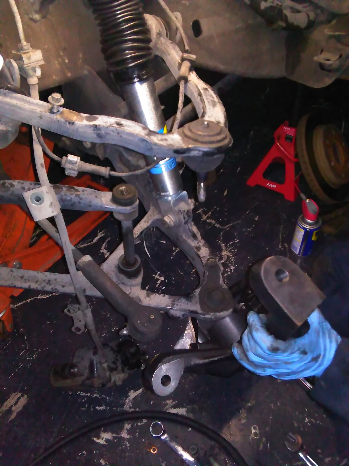

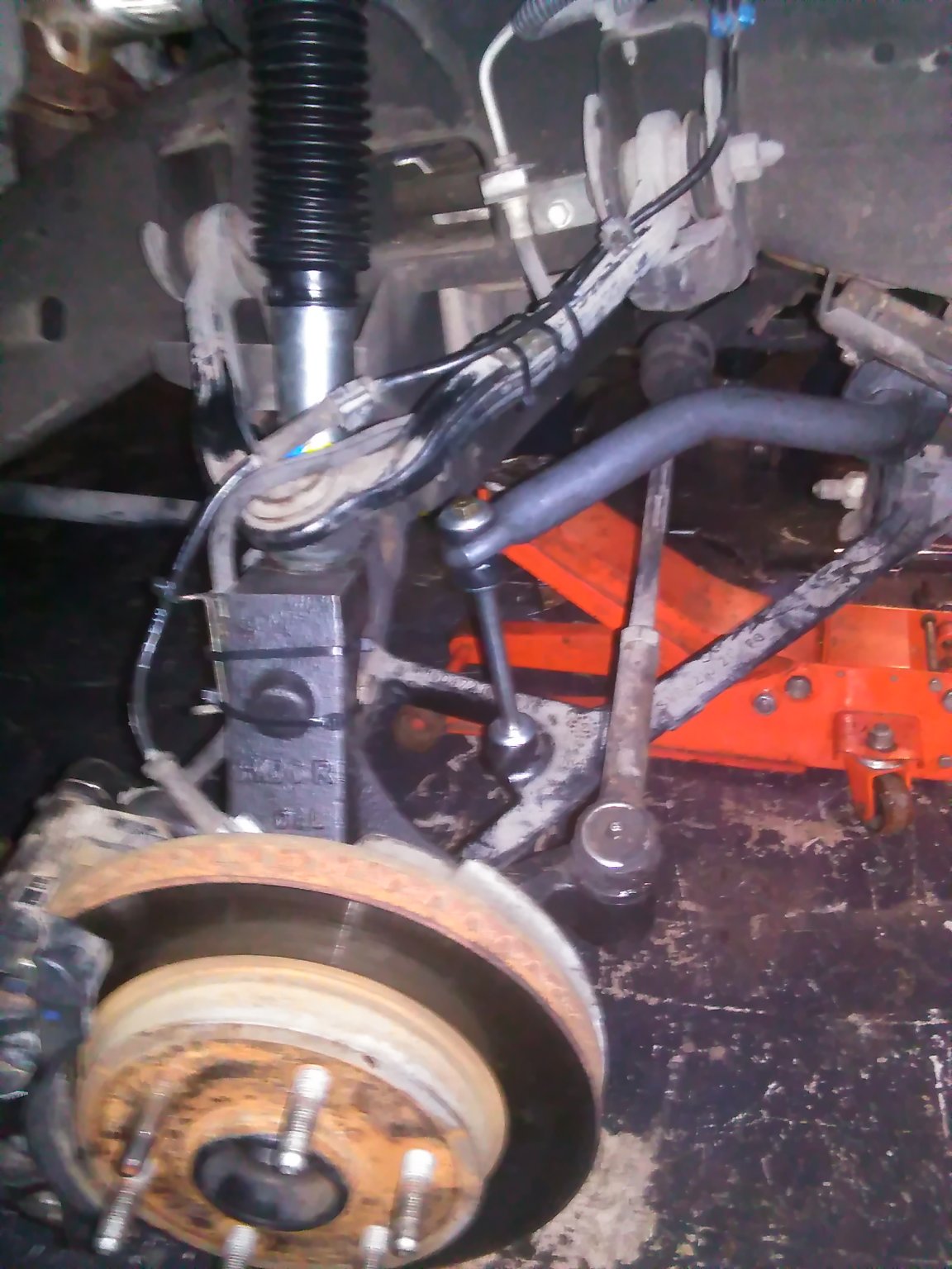

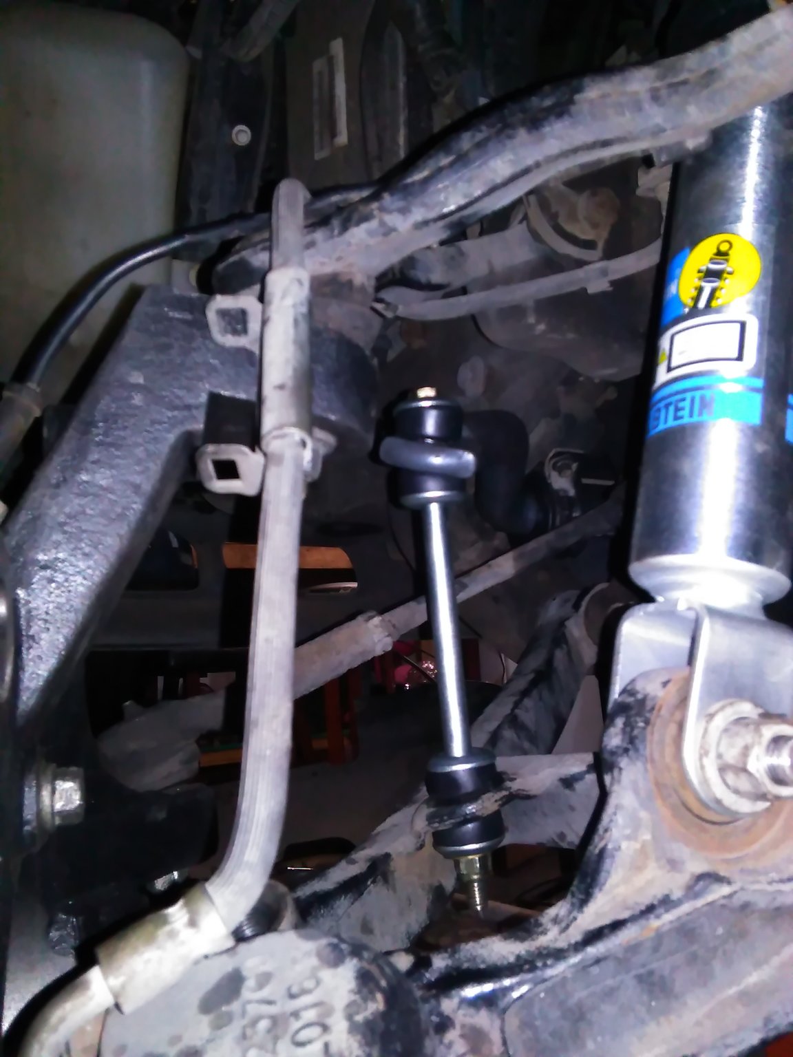

Switched out alternator this morning. We finished front end also. Put in 3" lift spindles, Bilstein 5100s, and belltech sway bars.

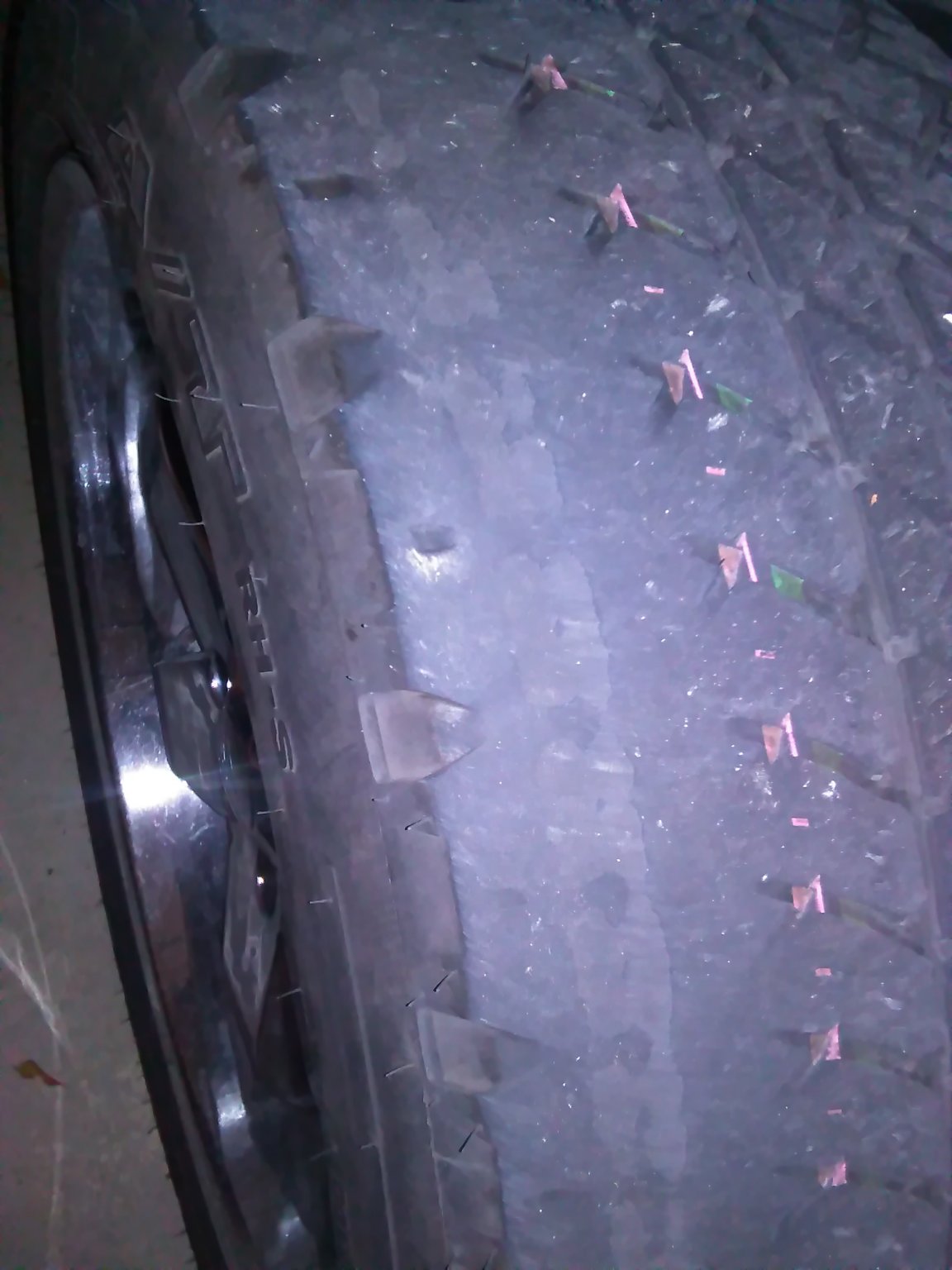

I drove 250 miles without alignment on newish all terrain tires and rubbed bald. Smh. importance of an alignment
