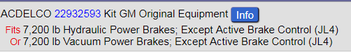

anyways, i am on rockauto and there is a DORMAN 919153 {#22932593} Kit i want to buy.
it has all 9 lines for my Tahoe.
but it say "w/o RPO code JL4 (active brake control)"
https://www.rockauto.com/en/catalog...1412244,brake+&+wheel+hub,hydraulic+line,1820
is this the correct kit?????

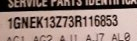

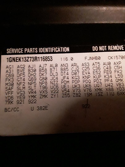

You need to look in your glove box at the RPO codes. Look to see if you have the JL4 code. If yes, then get the active kit. If not, you need the other one.

i dont see any JL4 code
so i guess this is the correct kit
Looks right to me. If you want to verify visually, take a look at the brake lines where they hop over the center of the rear axle. If there are 2 flexible lines, you are JL4. Otherwise, there will only be 1 that splits to the 2 rear calipers.
