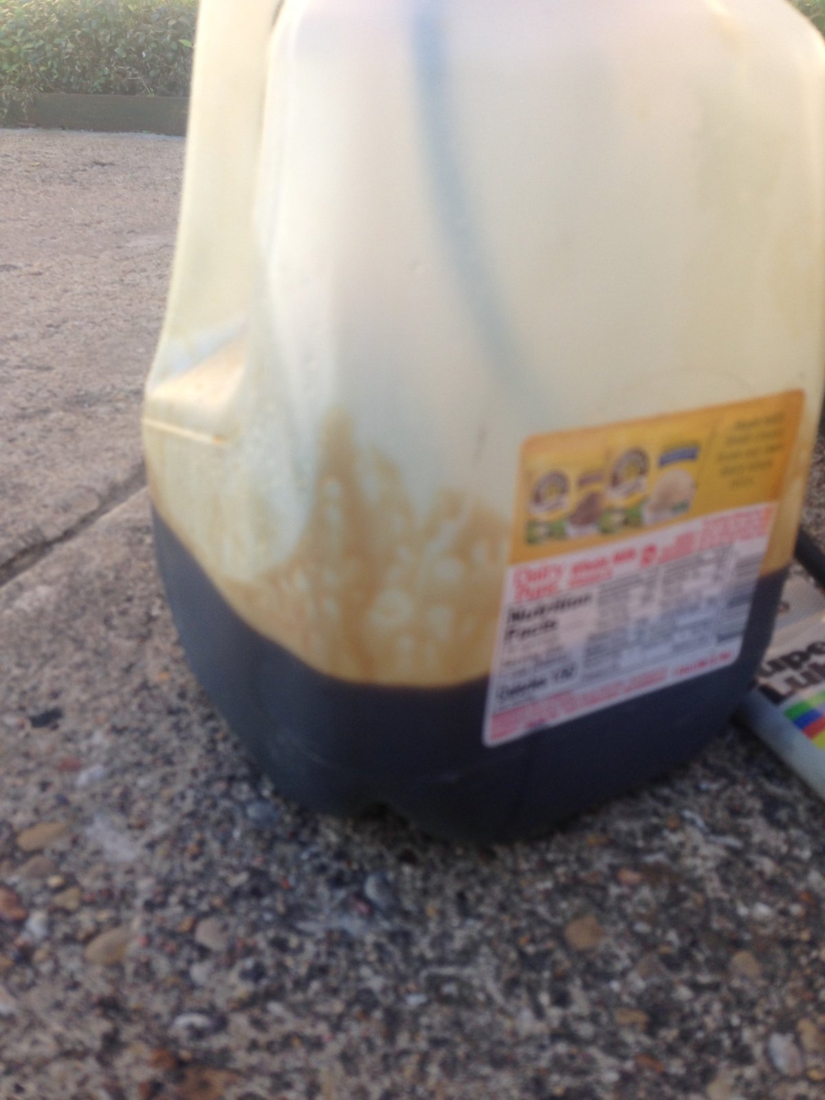

Oh, is there any way to know if that guy completely flushed the brake fluid? I would not assume that somebody has the integrity to go the extra mile, espc if it's a service that wasn't requested by you or rec'd by him (mech.)
I replaced pads/rotors on all 4-corners but the biggest difference was felt after the orig brake fluid was flushed out of the resv & pipes, then completely refilled with brand new BF. 15-year old, black, water-logged hydroscopic hydraulic fluid is ... Well, almost useless. Easy to check, the hardest part is getting the proper sized clear tubing.
You might give the dude a call/text & ask about it. But you would need a turkey Baster or vac pump to clear the resv, correct sized tubing and 2-qt brand new dot3, all at the very least. I wouldn't necessarily pay that guy to flush the BF if he wouldn't do it in the 1st place while he was replacing everything else @ whopping $4 grand.
This is what I pulled from the reservoir. BF, when fresh, is clear as water. Shocking. I wouldn't say "pointless" but you understand replacing pads & rotors for $$$hundreds, then disregarding $10 in new brake fluid and 45-mins of your time... still it's all hypothetical assuming your mechanic took care of you.
Words of wisdom: don't use the first empty BF can to collect water for cleanup while the 2nd new can is currently in use. Easy to confuse and you will prob end up pouring water into the Master Cyl. I was 2nd-guessing myself until I taste tested each bottle and got it all figured out again
