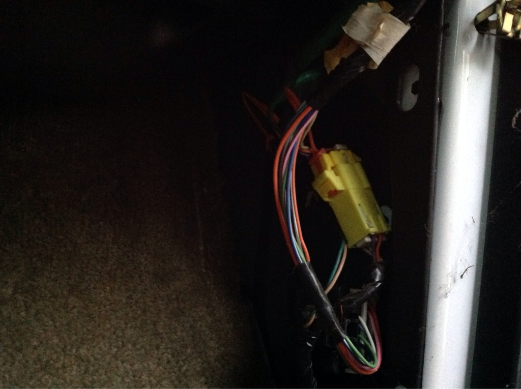

Sorry for the bump. When soldering to the wire in the plug on the drivers side.
Are you guys removing that wire stripping a section of wire
Wrapping the new wire around the bare wire
Soldering
And shrink wrapping /sleeving that connection?

Great work Cameron, looks great.. I'd like to have the lights on whenever the truck is on. Do you happen to know which wire in the box that you tapped into, will let me do what I wanted to do? I thought about hooking it up to the fog light push button switch over there, but that a) isn't easy to splice into and b) has way too many tight wires to screw with.
Any help would be great.. Patrick
