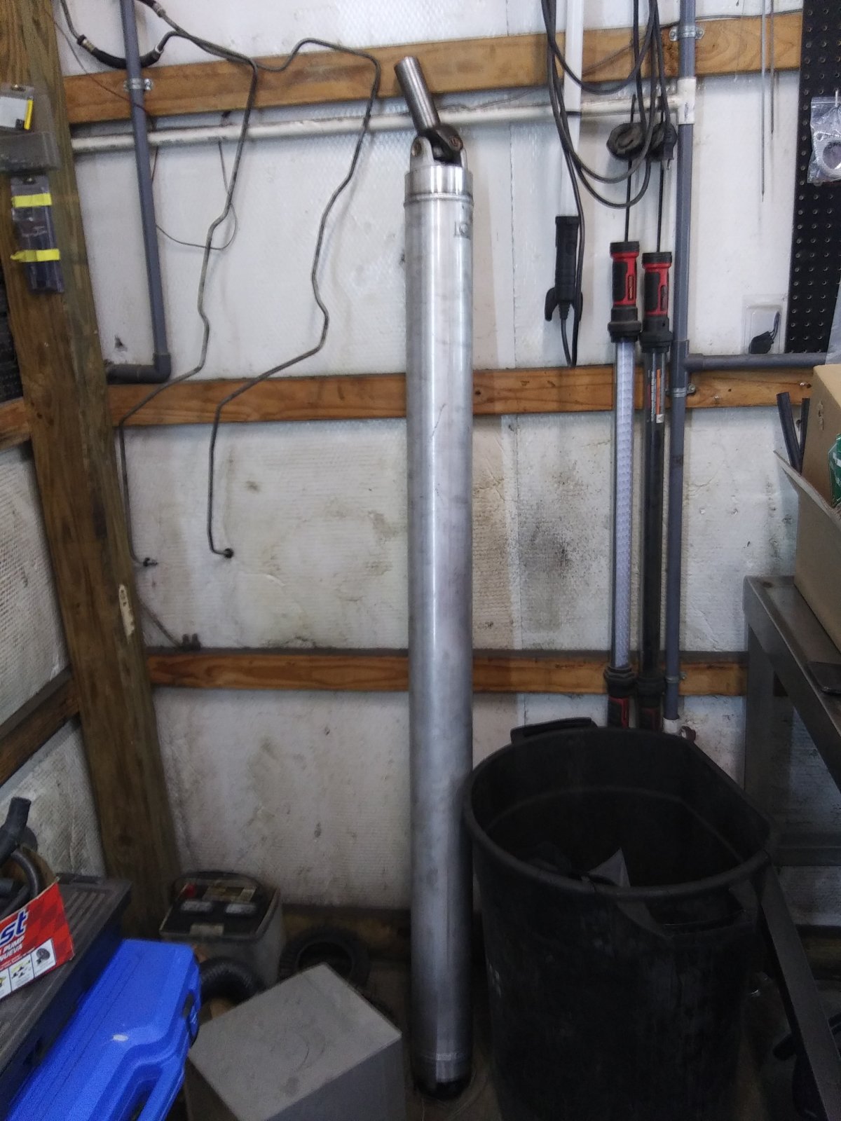

Waiting on driveline shop to get the new driveshaft done "suppose" to be ready friday but have already came across customer service issues with them

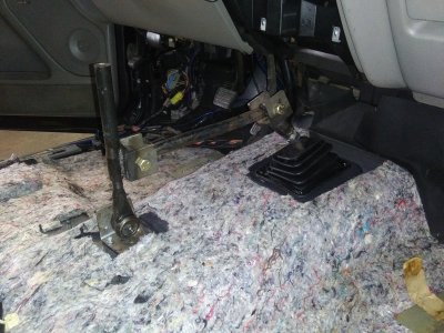

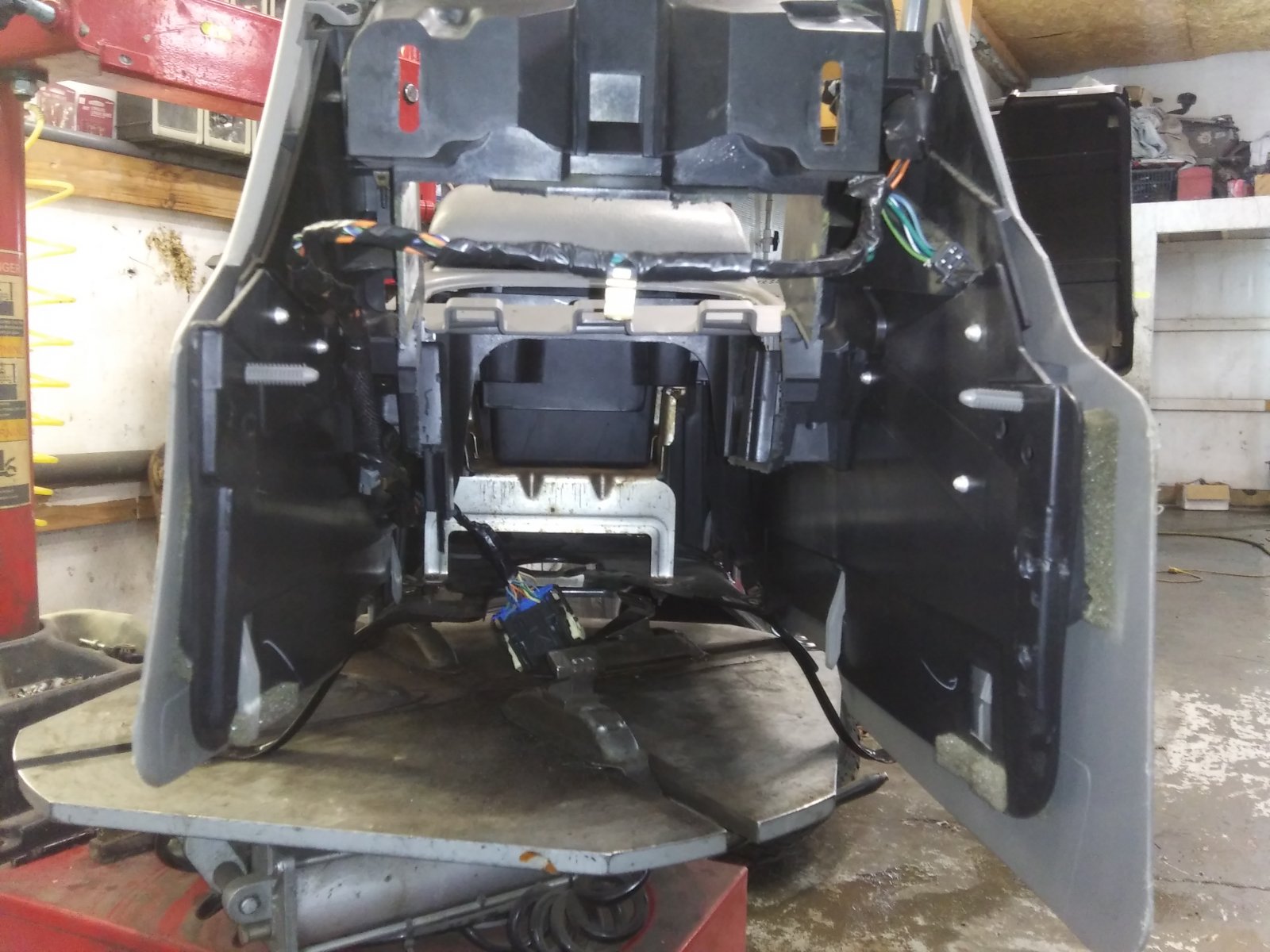

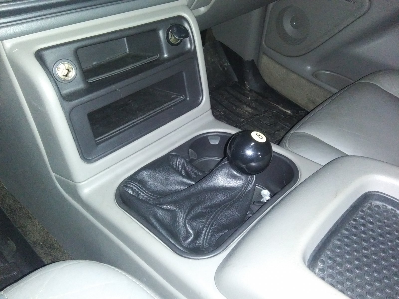

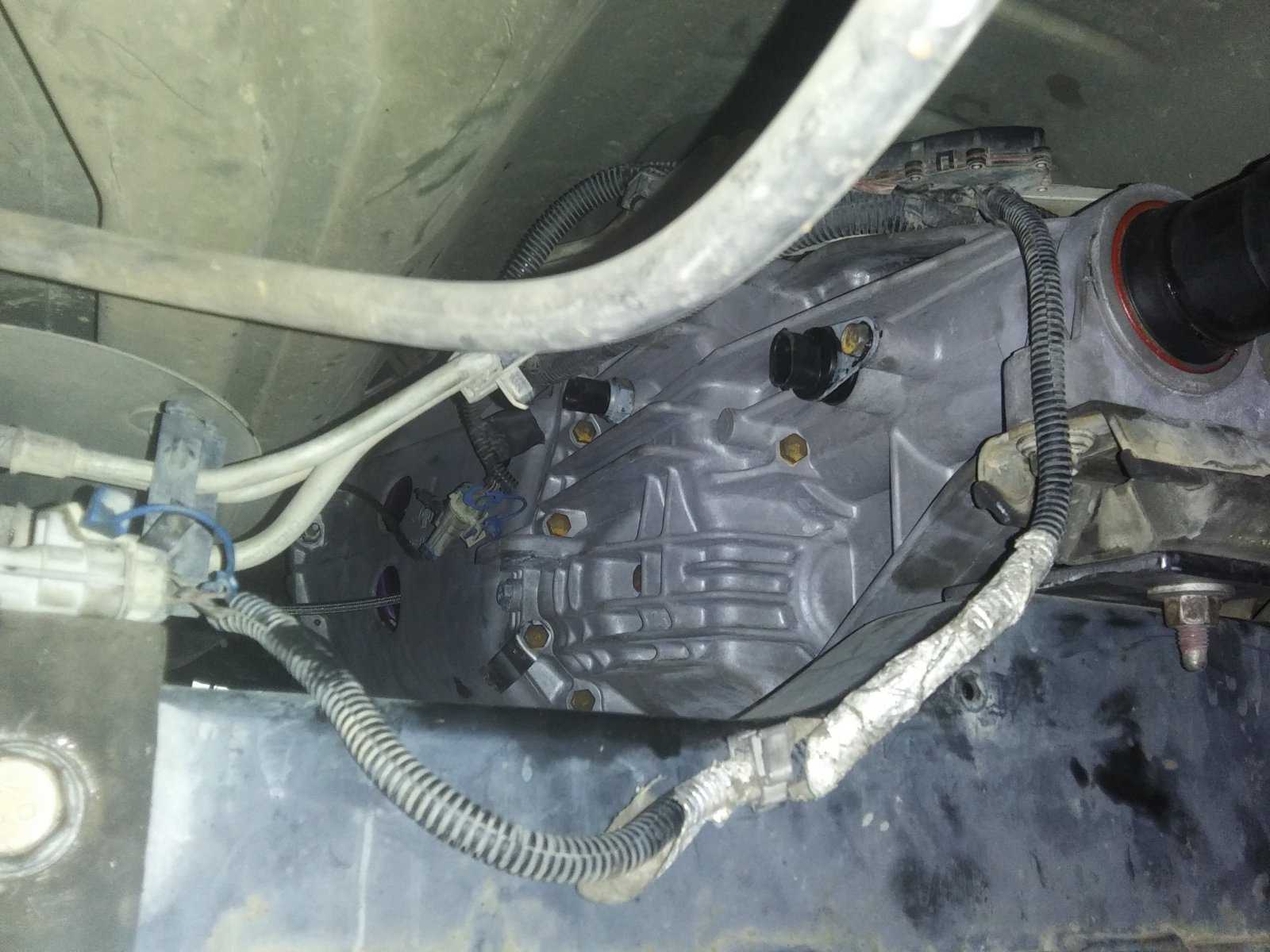

5 speed swap is complete drove home tonight with no driveabilty issues

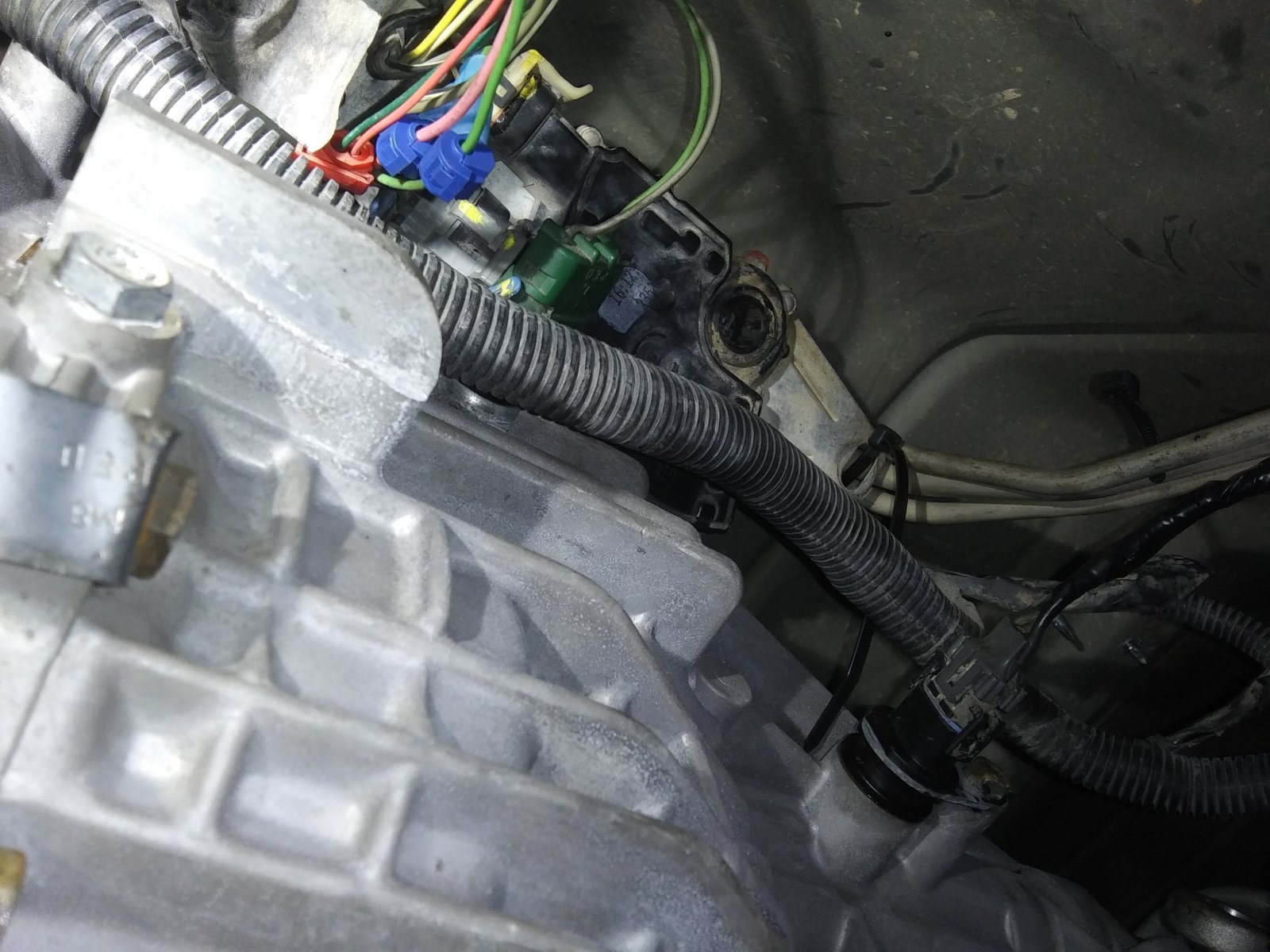

Sloppy tapped wiring for starter circuit and back up lights from my diagrams but no back up lights so I'll check circuit get that fixed then I'll get some nice pigtails and get rid of P/N safety switch
Now on to the pics. Will try to get a video soon if anyone is interested

Its not bad at all my remote shifter mechanism is a little tight but I expect it'll loosen over next few days
Pulls way harder then with the automatic and it hardly takes any throttle to keep crusing speed

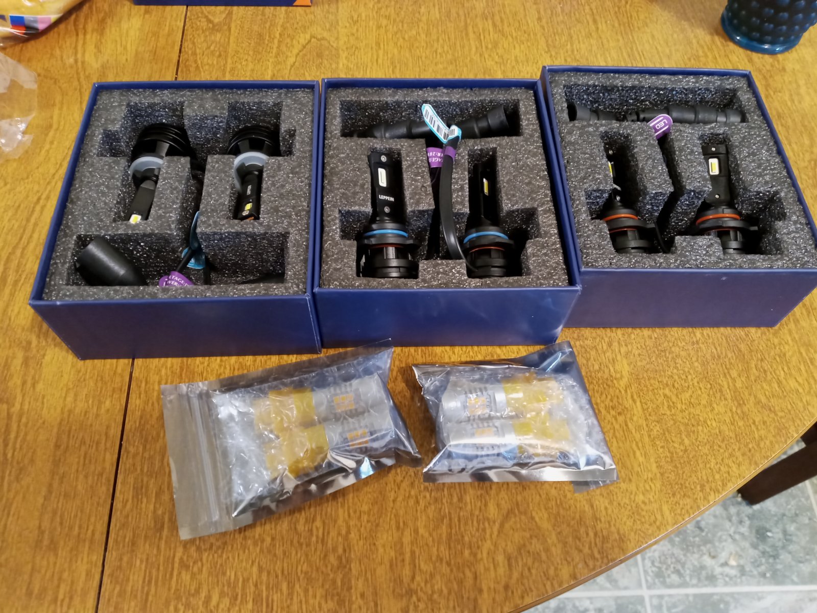

Also treated the front to all led light to match the rear
