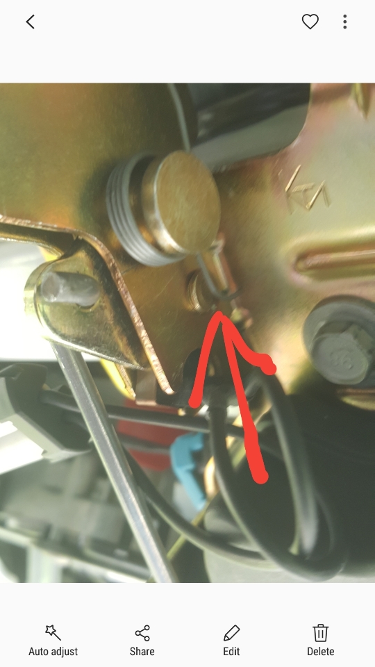

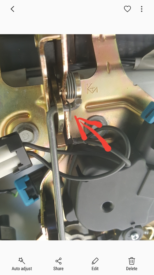

Hey...i figured it out. The actuator and door latches are fine the issue is on the glass latch from where the rod connects to the latch hole and to the lower black plastic holder. When I push down on the rod the dome lights go out. When i let go it gives slightly and lights come back on. I'm guessing it could be spring tension because the switch under the point where the top of rod connects isn't contacting the switch there.

Does it help if you hook the spring tail on the pin head protruding about in center of spring tail last pic? Otherwise I would suggest looking for a slight mis-alignment of the assembly. Try loosening bolts and rocking to one side and re-tighten. I think you are on the right track, It's just liking you massaging it and wants more.

Hah!...i finally figured it out...the end of this spring in the latch has a purpose!!! It goes over the metal rod...problem fixed!

Nice catch! Thats gonna help me later I think.
