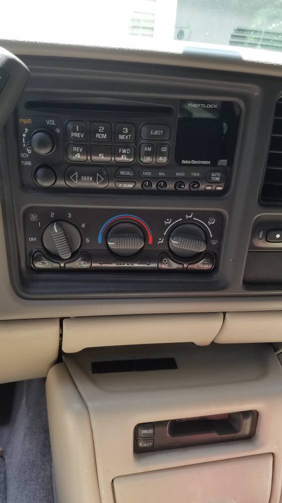

Thinking of replacing the head unit on our '01 but need to know how to tell if it has the Bose option.
I have Onstar, although it doesn't work because way back when they switched to a digital system they said it couldn't be converted.
It has the CD player with the tape player seperate and below the 12v outlets
I have a rear subwoofer
No steering wheel controls
I'm looking on Crutchfield and it gives the following options:
-with Bose and Onstar
-with Bose, without Onstar
-without Bose, with factory sub
-without Bose, without factory sub
Also, if I don't have Bose, is there still a factory amp? The rear sub stopped working and the sound coming from the door speakers has no bass.

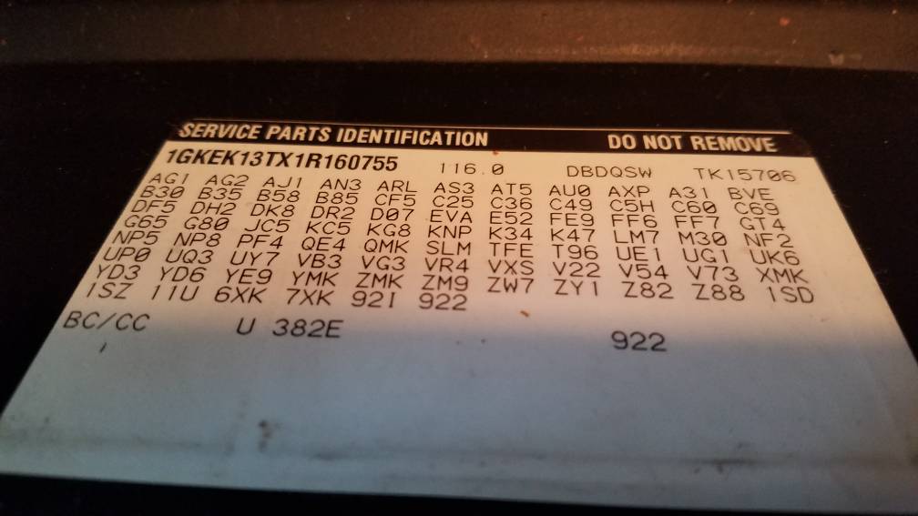

What are the RPO codes for the different options?

if you have bose it will say it basically everwhere, speaker grills, tweeter grills, and on the radio face (usually), 01 should have a amp behind the glove box

If it's not Bose would it still have an amp somewhere?
Trying also to figure out why there's no bass and why the rear sub has seemed to stop working
I'm guessing it's not Bose, doesn't say it on the head unit

Noticed on that listing it also says
"enhanced speaker system (option UQ3)"
I'll also look at the RPO codes

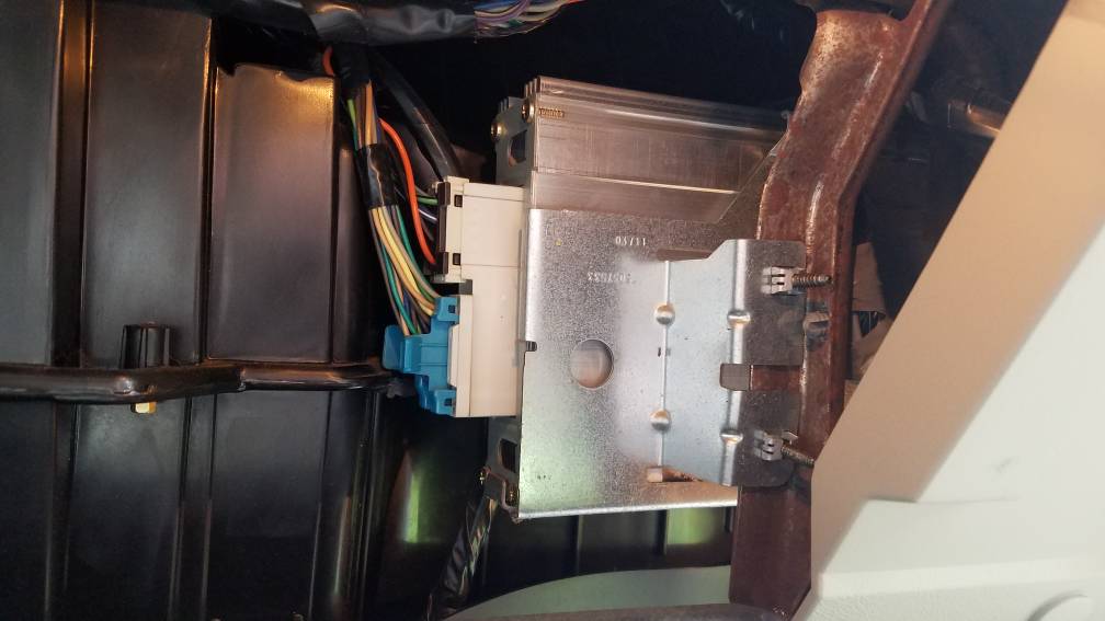

My 2001 doesn't have any identifying "Bose" on the radio or speaker grills.
It does have that amp behind the glovebox and RPO UQ3

same thing my 00 had, most likely the subwoofer speaker went bad in back, replacement options are limited but can be done, there is a couple shallow oem type replacements out there, you can remove the old subwoofer speaker and connect any speaker to the terminals to confirm there is still a signal.
