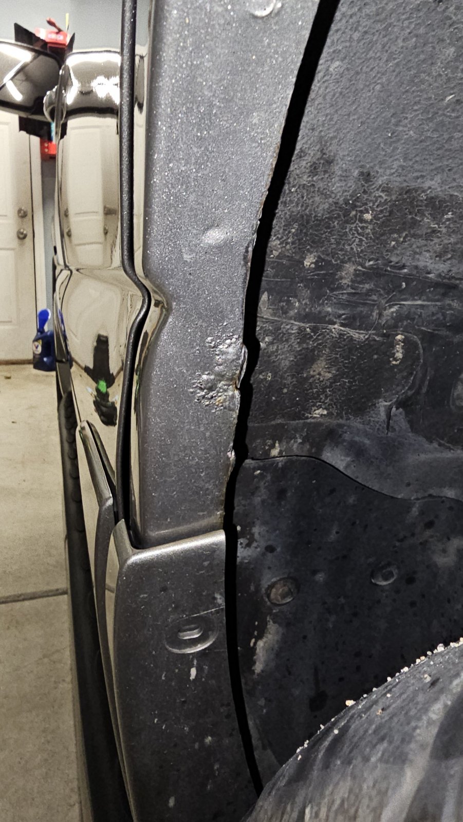

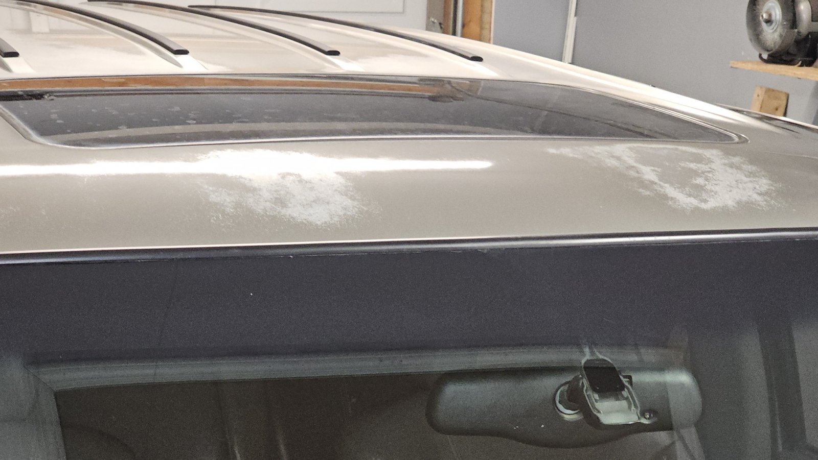

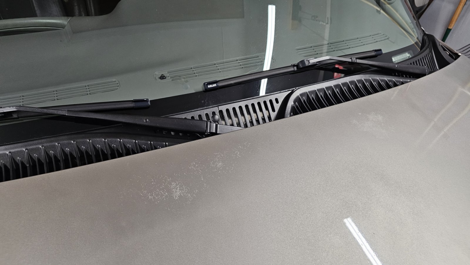

I need to start planning ahead for what I want to do with the body of this. I never really liked the color a whole lot, but repainting isn't exactly cheap, and a TON of time, even if I do most of the work myself. BUT, I did find a couple small rust spots on the rear wheelwells that will need to get addressed sooner than later, so I'll have to start figuring out what I want to do with this thing. There are a lot of spots that need the paint addressed. The roof has clearcoat issues, the hood has issues, a fender, etc.
