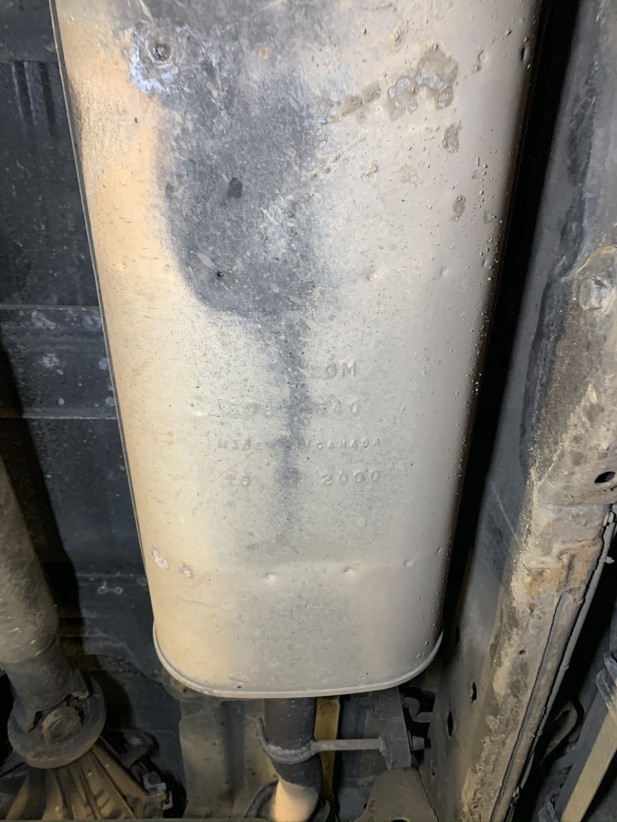

Now my following question. Because I've a muffler bigger than a truck, you can barely hear the beautiful v8. In some cases it's actually handy but I really want better sound, and if possible with my budget, a exhaust that can give some extra power and torque in combination with the tune incoming. My exhaust:

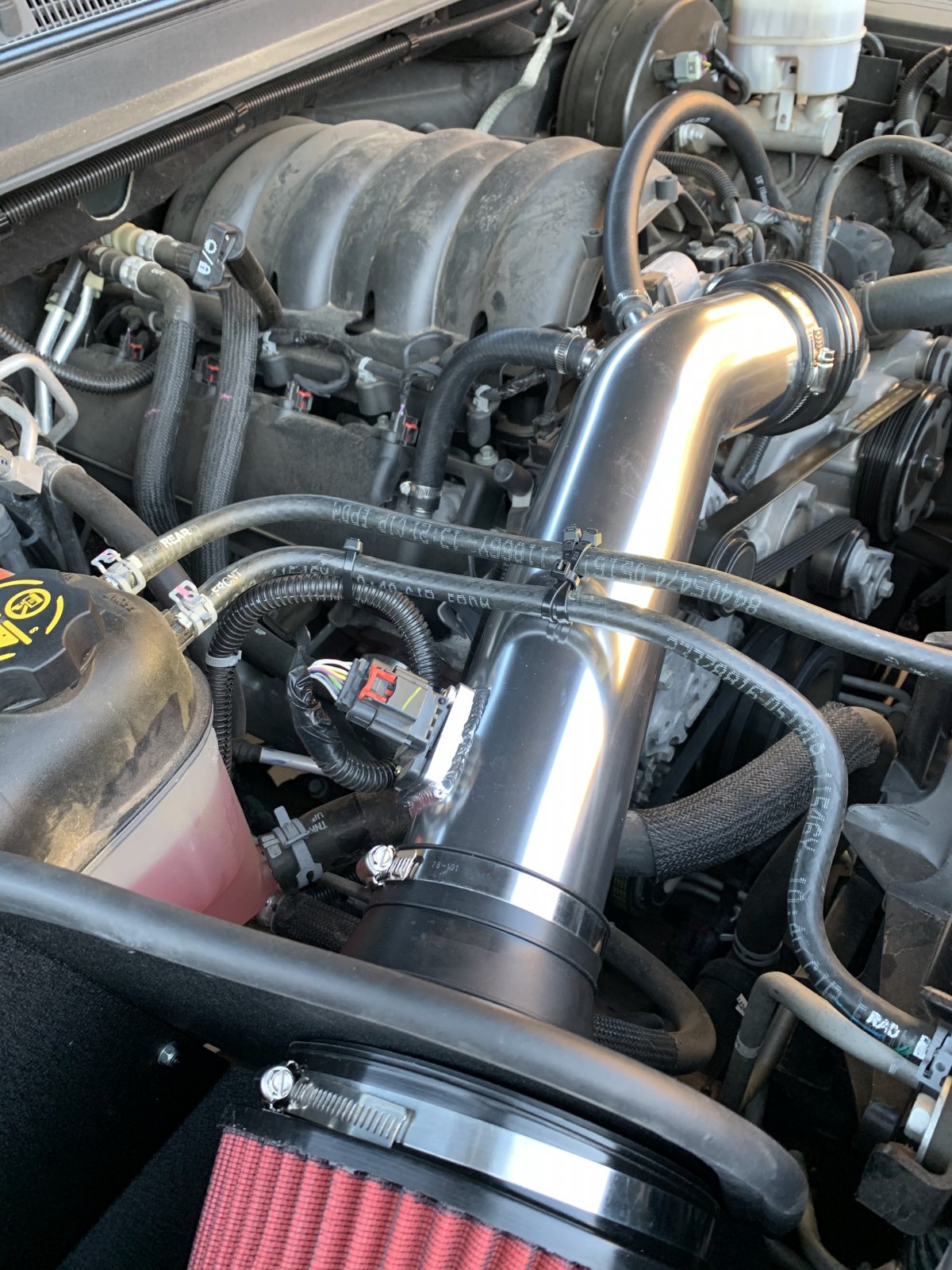

https://www.amazon.com/MooSun-Intak...eywords=moosun+cold+air&qid=1609083992&sr=8-2 I bought and installed this for under 60 bucks looks great and easy to install.
Thanks for the input, looks good for the money. But for me it will be €125 with shipping and taxes. When my cousin gets the opportunity to get to the Netherlands I will order the Airaid 200-912 and a AEM dry air filter from AEM and keep de original box as described in the following post:

My stock exhaust sound, in between two houses. Filmed in June 2019.

This is what you'll get and it'll be quiet as stock when cruising. It's a beautiful thing. lol
The muffler isn't really a terrible restriction for most any normal driving. Due to it's design, it does slow the flow a little at WOT and higher RPM, so there's room for improvement. A few horses were sacrificed in the name of quietness. But, you can get a free-flow muffler that operates much like the intake tube- It won't be much louder when idling or normal driving, but will have a strong growl when you put your foot in it. The Magnaflow #12589 is such a muffler. The next step up in aggressiveness is the #11259. I get the clones of these, made by by AP Exhaust in their Xlerator line, since they are half the cost. The clone to the MF 12589 is the XS2589 and the clone to the MF 11259 from is the XS1259. I'm now running both of these mufflers together, in series, since it got so loud after removing the cats.
I know but that is why I want to change it too. Since I want to tune it to go to 5800/5900 rpm shifting point. Unfortunately I can't get these mufflers in Europe you mentioned. https://www.celtemp-services.nl/3in...7_2557.html?osCsid=7po8dfuvd1i48of7feulevkes5 this is my chose for 3 inch in NL for Magnaflow. But is for example this muffler from Flowmaster Flow FX https://www.ajspeedshop.nl/a-574228...lowmaster-flowfx-mufflers-2-25-2-5-en-3-inch/ a good choice? Also freeflow and €85 euro, is $68 dollars. Because the Magnaflows you mentioned I can only get via ebay and will be like $150+ dollars plus including shipping and taxes. Thanks for your proper information so far :)
