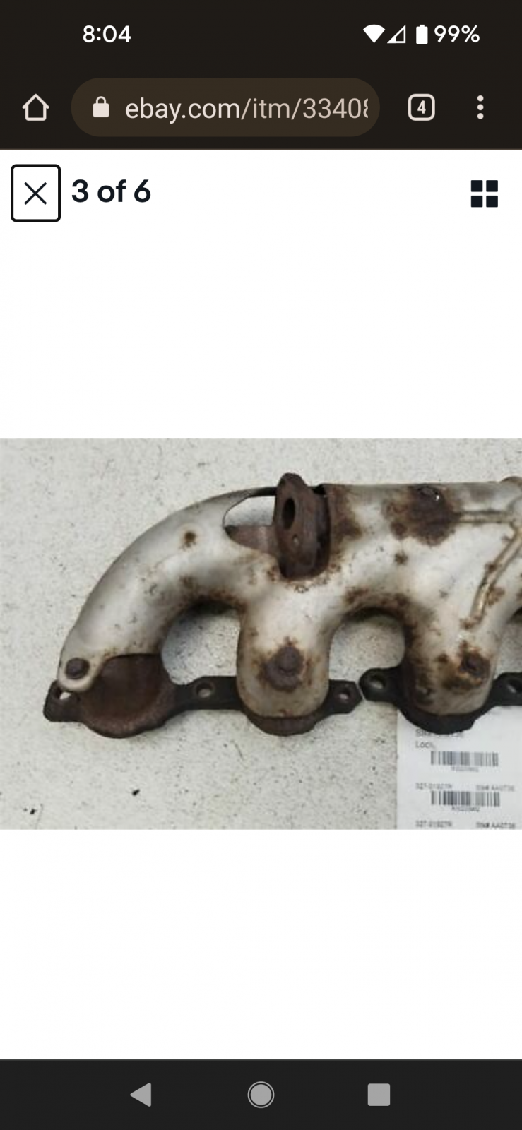

00-01 the egr was different, but that was up at the passenger side exhaust manifold.
