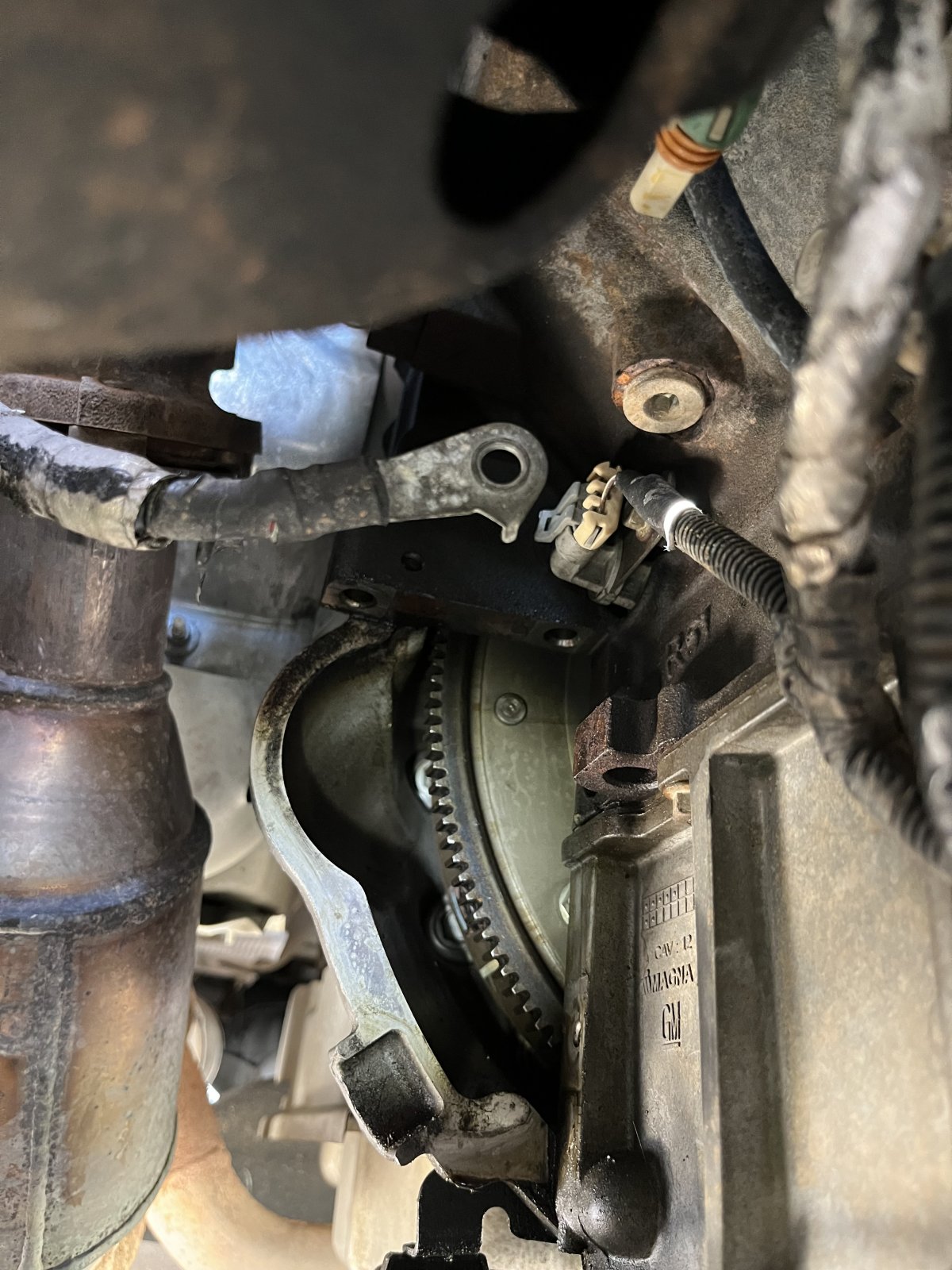

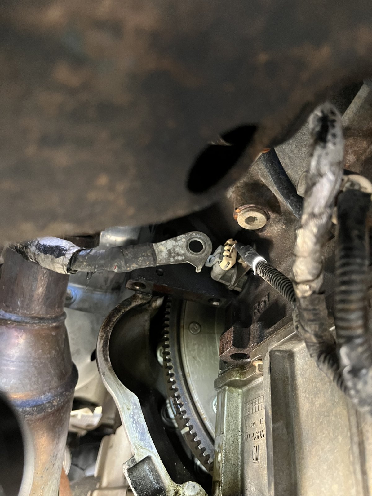

2013 Tahoe Lt 5.3 with 155k. Just noticed a ticking/rattling from lower part of engine. I have a constant regular ticking(lifter-rocker-rod…?) you can hear in video, but the new sound is the irregular rattle (most audible at 22-26 sec mark). The rattle will increase with acceleration from a stop but becomes inaudible over 10ish mph- not saying it stops, just can’t hear it over the engine. I changed the upstream 02 sensors a week ago coincidentally. Looking for any advice.

Them's the teef! How about the three bolts where the torque converter bolts to the flex plate? Gonna have to look way up in there towards the center to check for cracks. They usually crack around the six bolts that mount the flex plate to the crankshaft, often in a ring around the bolts.

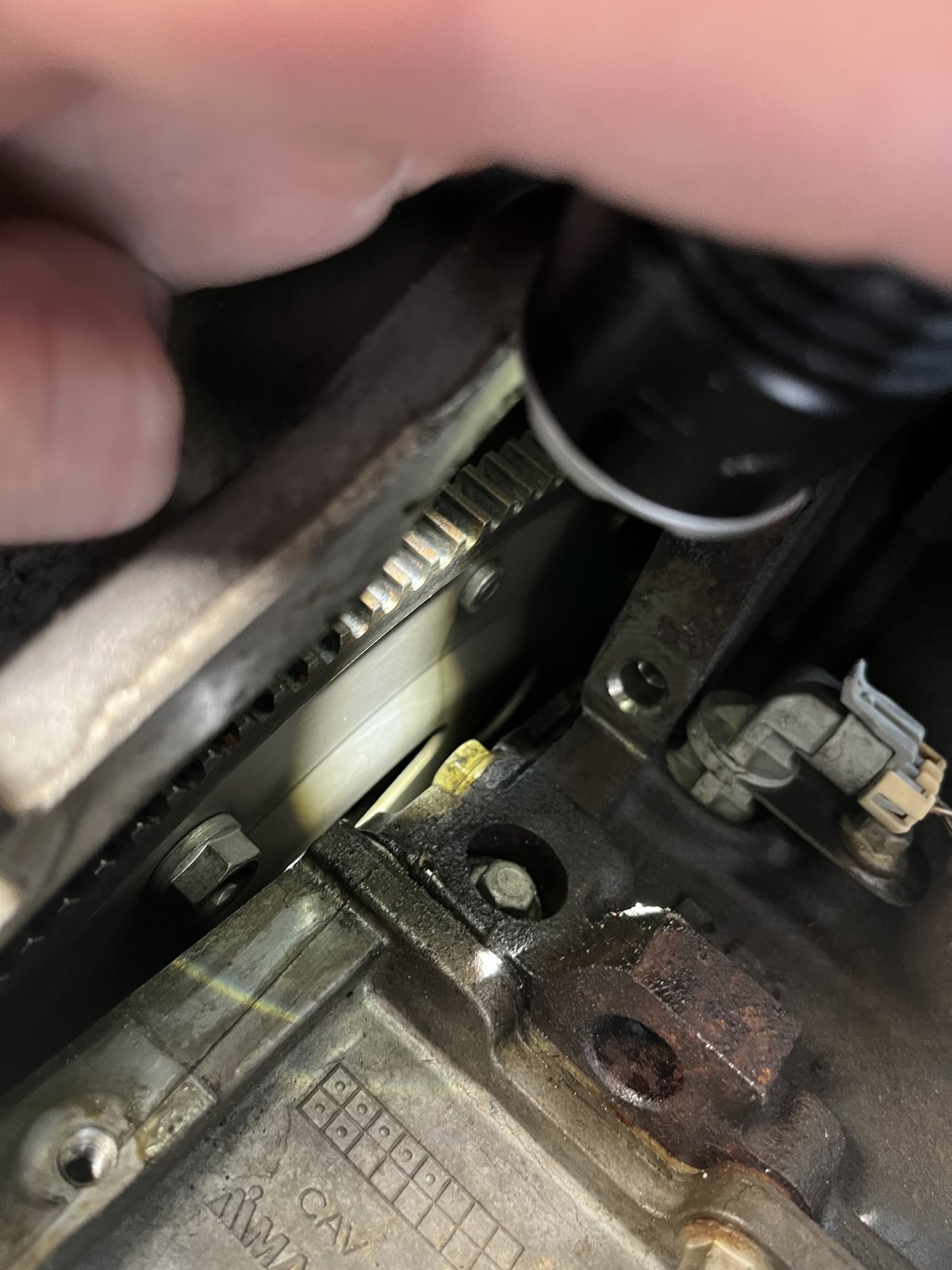

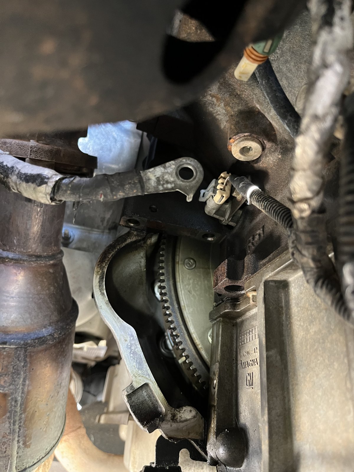

That’s after dropping the transmission though right? I don’t know if I want to wade off that deep without a lift. Monday I should have one.
You should be able to see up in there. You can see one of the three torque converter bolt bosses in your second pic. It's a somewhat thin gap to look through while trying to get your flashlight just right, but you can see the six bolts up around the center that bolt the plate to the crank. Should be plenty able to see cracks.
