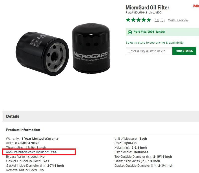

I just spoke with the mechanic. He claims that the noise I’m hearing is rocker noise and is common to Chevy. I’ve been driving the truck for a year and I’ve never heard it. How serious is this and how concerned should I be? Could this lead to bigger problems down the road?
As the oil begins to circulate from a cold start, it goes away. I just listened to it and it sounded like it did before I hear the loud noise that I’ve described as a knock or rattle. He also said I was using a cheap oil filter - microguard and that it might not have the check valve required. I’ve been using Mobile 1 Full Synthetic Dexos 2 oil. My most recent change was about 2 weeks ago and the mechanic said the oil level looked fine.

What oil filter do you use. I think when he says rocker noise he is actually talking about the common lifter noise we talked about. You can leave the oil in it and change the oil filter and top off oil level as needed. Let us know about the coolant leak test results.
Moderator
16,665
34,502
People's Republic of Colorado
If you're using the recommended MicroGard oil filter it has the check valve.

Sounds like your problem was a cheap filter with a leaky ADBV. Stick to WIX, Fram Ultra (the gold one, don't even look at an orange Fram), K&N or Mobil1 for filters.
