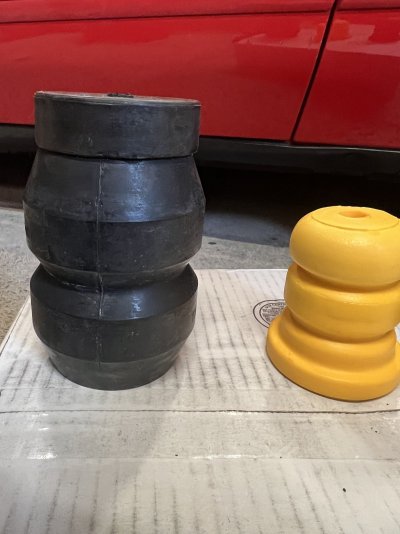

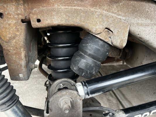

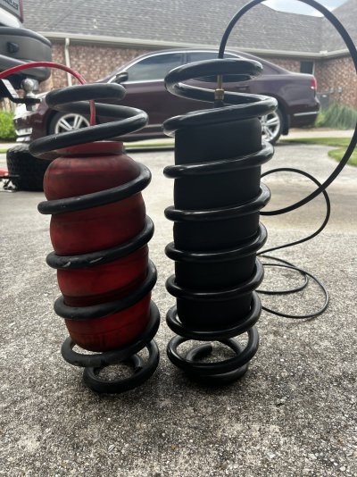

When I refreshed the rear suspension of the 03 Z71, Timbren bump stops were used w/ new Moog Z71 springs and air bags for the Ram 1500 (allow higher pressure than the ones for the Tahoe) - complete PIA to install in springs but worth it (to me).
Springs were direct replacement in this case (old ones just worn out). New ones ~1.25” taller.
Old spring (w/red air bladder) & new (w/black):
Timbren Bump Stop & New Spring Setup:
Bump stop comparison; Timbren vs: Standard aftermarket.

thats some beefy looking parts.
i got them red bags. didnt think they were to bad of a install really.

Do you have a link to those rear bumper stops? I'd like to give those a shot--if they're cheap enough.

Cheap / Cost Effective is all relative…
They are available @ multiple vendors.
I got mine on an EBay “special”…

Agree.
The correct (red ones) did install without too much issue.
The black ones are not designed for the Tahoe and are thicker and taller. I fought them tooth & nail during the install.
Would not have been able to install them with the springs mounted on the truck.
