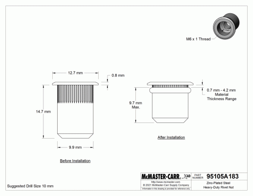

My intention for every mod on my Tahoe has been to be reversible, and preferably on the easy side of reversible. However, now that I'm finally getting around to installing the Yakima rails in place of the factory roof rack...
