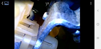

UPDATE 12/2019
I had to replace one more handle and was able to take an additional photo of what you need to look for. This time instead of a dental mirror I used a small USB endoscope that I snaked through one of the holes in the door to point downward at the inside of the yellow clip so y ou can visualize the locking loop and tooth. Place a small screwdriver, like for jewelry, under the edge and carefully lift.
Screenshot_20191227-091127_HD WiFi.jpg Screenshot_20191227-091131_HD WiFi.jpg
