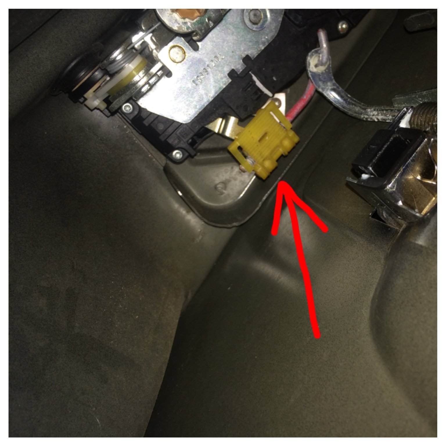

My truck is a 2012 Denali and was wondering if somebody could tell me how to release the clip for the rear door handles? Which side should I pry from? These are not the same clips my 08 Tahoe had.....those were simple to open up lol! Thanks!
I spent over an hour trying to get this clip open and unable to find anything on the internet remotely close, except for this picture (forever thankful)...and no answer attached to it. There will be other sorry chaps who will be looking for an answer to this post and so here is my attempt.

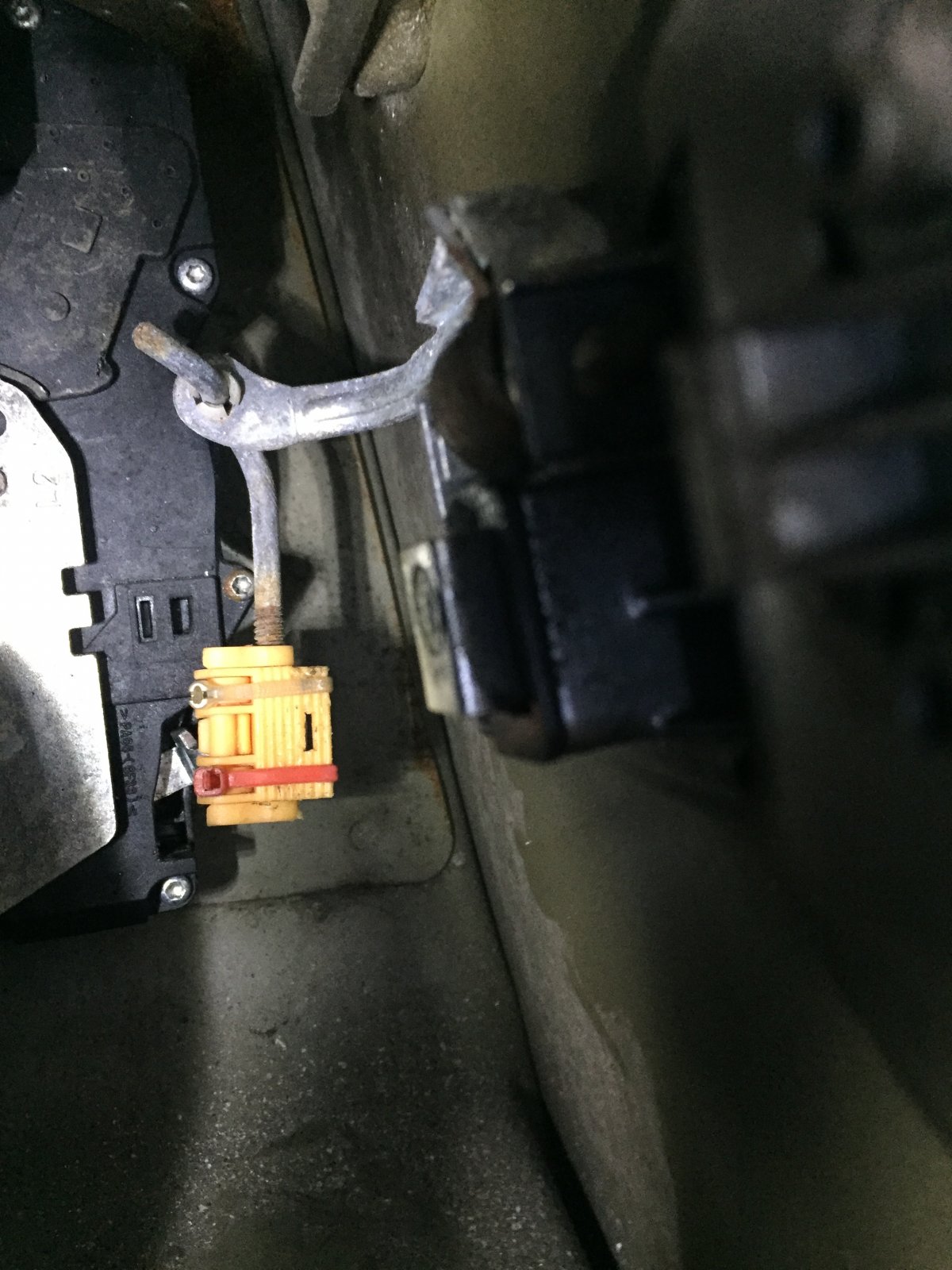

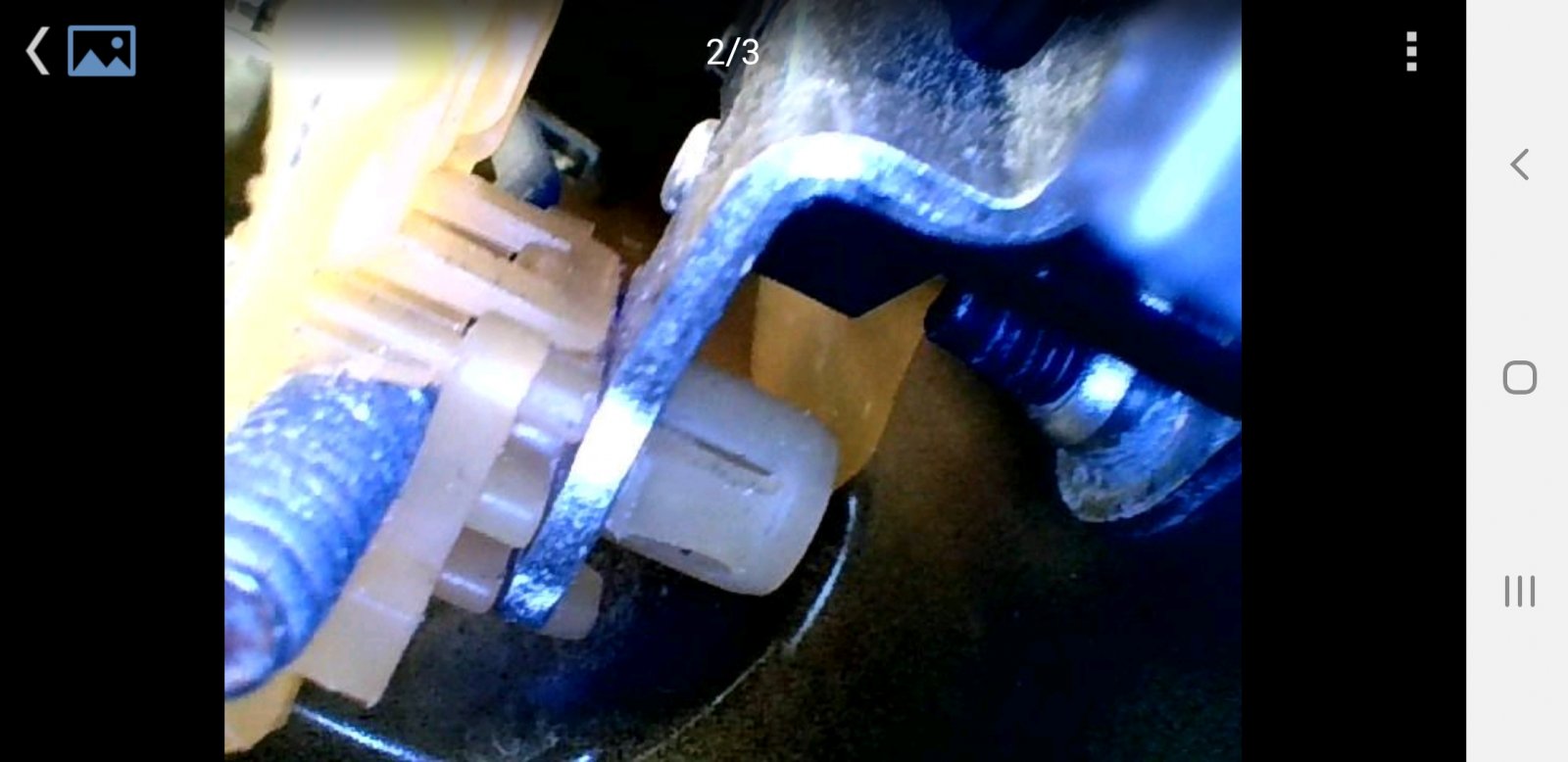

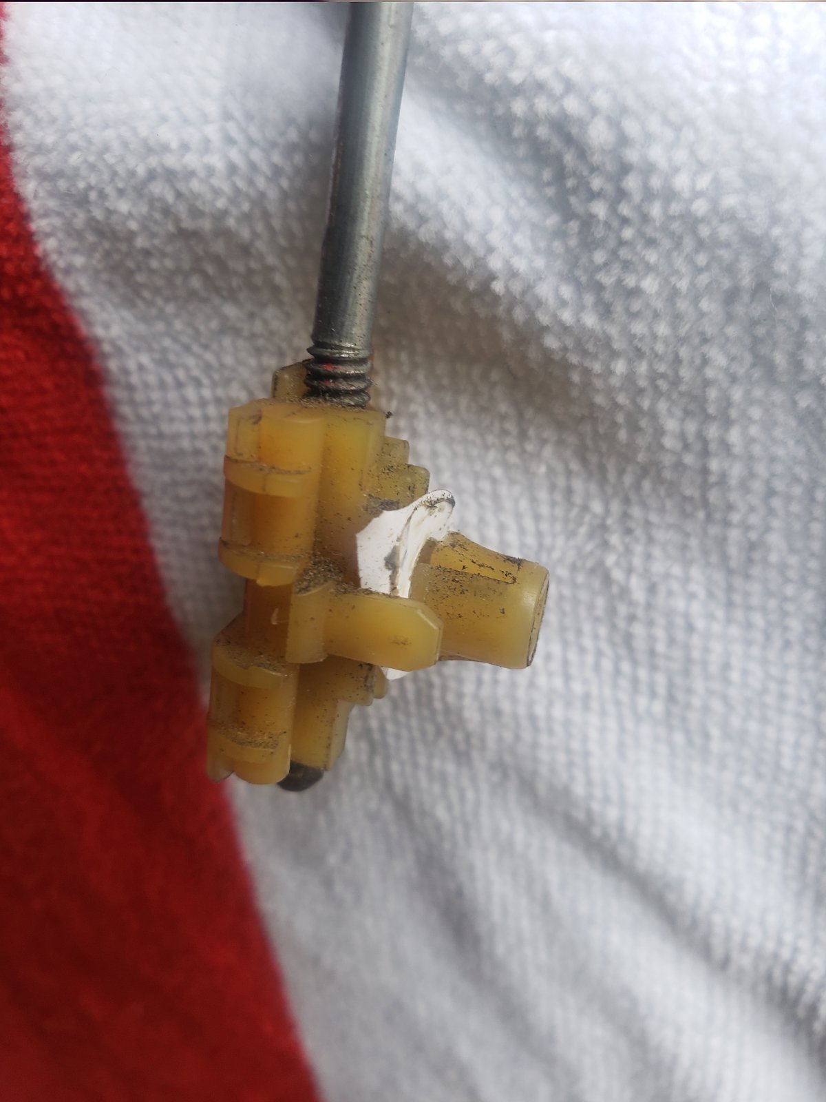

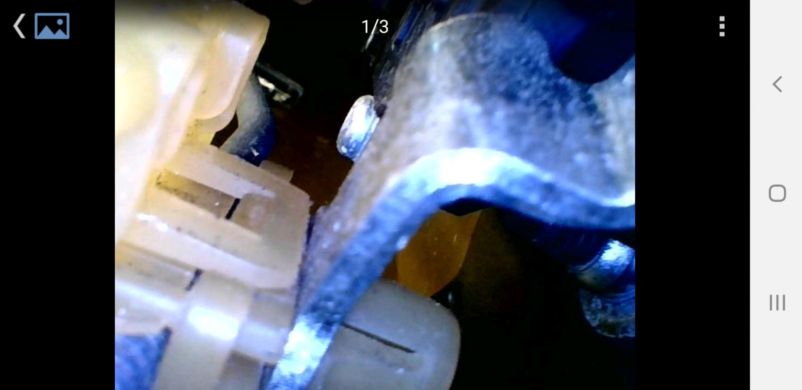

On the lower right side, where the red arrow is pointing to, that is the hinge. You will need a dental mirror and a micro screwdriver. Remove the rubber grommet that is in the door to access the bolt for the handle. You'll need that out to better visualize the mirror. And don't forget a good flashlight to wedge in there. Put the dental mirror behind the yellow clip and you'll see a locking tooth with a clip around it.
From the left side of the clip (as pictured) you'll have to get your micro screwdriver in and behind it and Pop That Loop over that tooth. Then it opens up like a door on that hinge. Now I have 3 other handles to replace and it will take probably 20 minutes a door instead of two hours for this one door.
