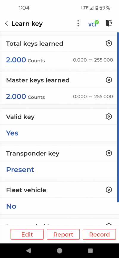

Interesting. Can it read and reset trans fluid life and also program key fobs?
looked around.. got some info on keys, but no programming I saw. it can reset oil and few other things. but didn't seem anything about tranny fluid reset.
under that section it has stuff like oil life, brake breed, and stuff that doesn't work for our trucks, like brake pad sensor reset, steering wheel angle sensor cal, battery reset like the BMW need. it has after tb change idle relearn under there, but I don't try it.
I guess I need to pull the tech 2 out if you say it's going a tranny fluid reset somewhere. Screenshot_20231230-130434.png

the tech2 does have transmission fluid reset

found a tree to it for another model but will be the same just choose right car
Work around procedure with a TECH2 to reset the transmission oil life monitor.
1. On the TECH2, select Diagnostics.
2. 2009
3. Passenger Car
4. Cadillac
5. K
6. Powertrain
7. TCM
8. Module Setup
9. Reset Transmission Oil Life
10. Type 100%
11. Perform Reset

yeah, just took a look. no option for module setup under tcm. Just the trans daps relearn stuff it says to do after a rebuild. I'll leave that alone.
probably a hybrid thing. I looked everywhere else I could think of and nothing.
so that doesn't mean the dongle can't do it, just that I can't find it on this thing.
