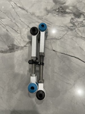

You can max out at +2 inches but you have to be in 4wd low to get there. You can go plus 1” up to 50 mph. If you exceed 50 mph it drops back to neutral. When I snap these adjustable arms in place of the factory ones I will be able to adjust the neutral setting to any height I want.

Interesting, I didn't know those were available. I don’t have the air suspension but trying to find out how I can run a 285/55r22 (1” larger dia) without a huge lift. Still waiting for more level/lift products to come out.
