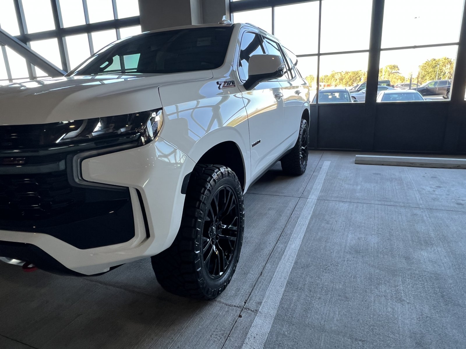

Fit report and question:
22 AT4 XL. I used the switch suspension links and added 295/70/18. They work great. A pain to get the old ones off (I even broke a sensor) but the new ones are easy and then much easier to get to to adjust after they are on.
No rubbing and the ride is great. A little bit stiffer but I like that. Feels more truck like.
One issue I have now is that all corners are set to 39 3/4 at the bottom of the fender well but the rear drivers side won’t go above 38 1/4. Even after several adjustments.
Also, the increased ground clearance level and the 4WD level are not available. You are just riding at that increased height all the time. Entry/Exit works fine. I’m assuming the aero mode does as well.
If anyone has any recommendations for the rear or adjust higher please let me know.
