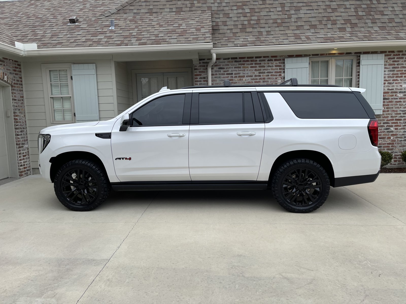

I have the edgymods links and just bought some 35x12.5x20’s. Raised it about 2” with the links and we’ll soon see if the 35’s fit. It’s gonna be close
Good luck man. I hope this works out. I'll be following in your footsteps if so

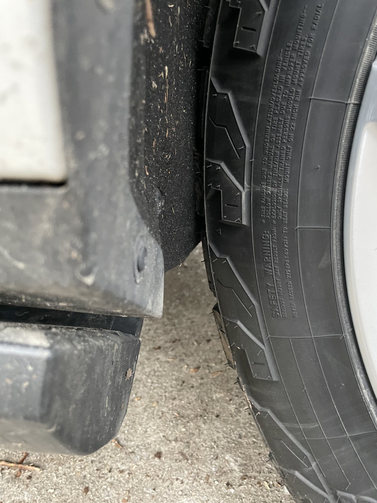

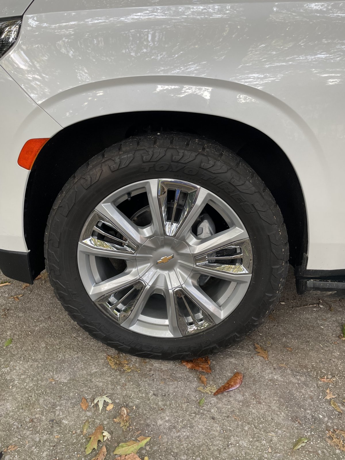

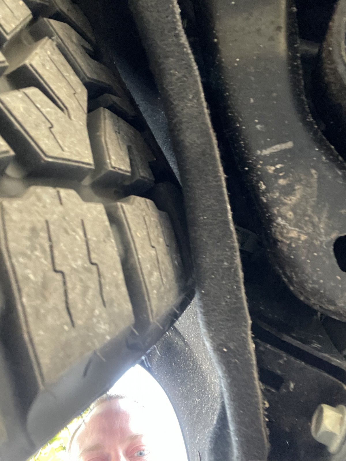

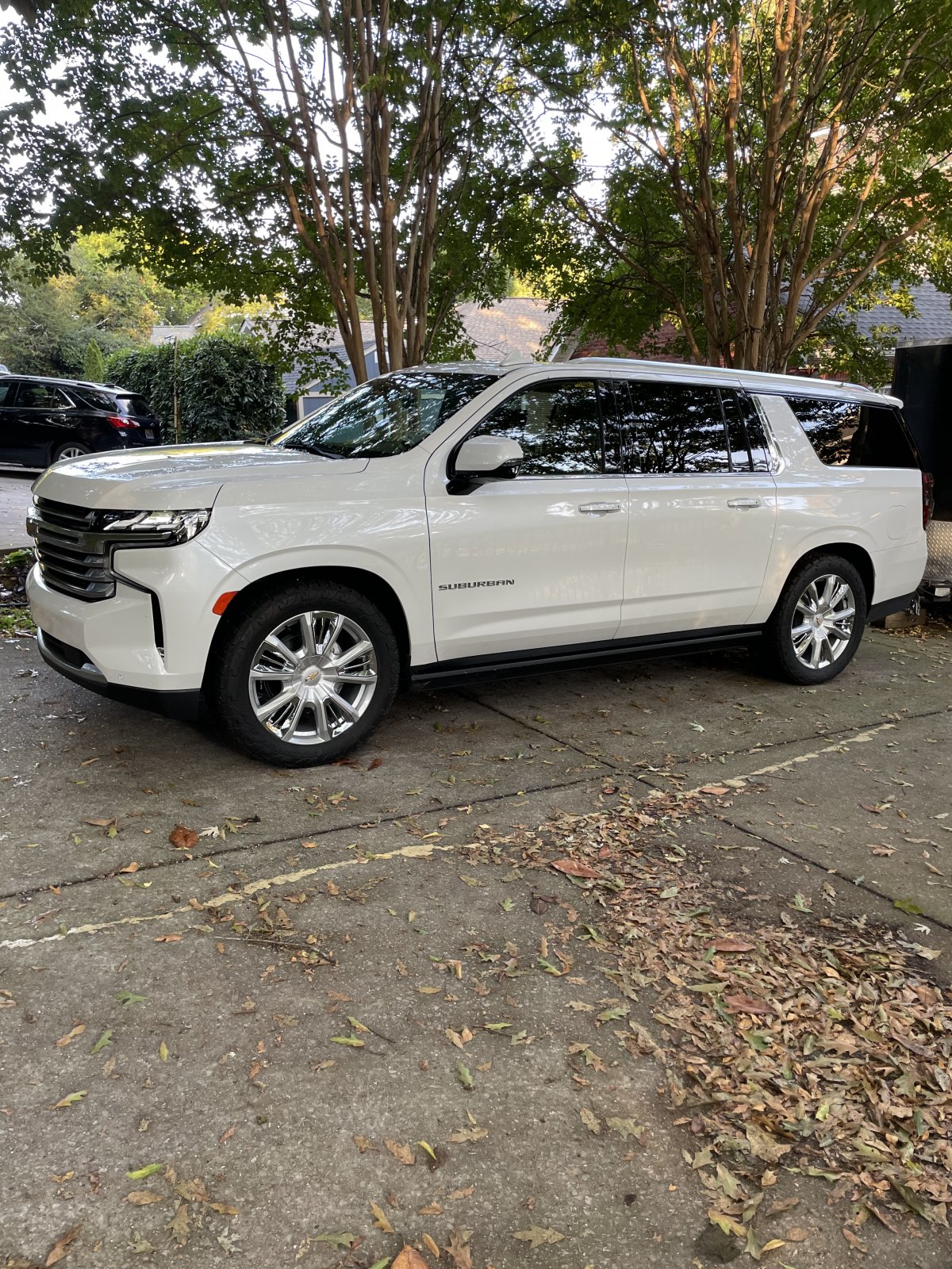

Regardless of how you manipulate the static height of the air suspension, 285/55r22 won’t work with the suspension compressed (big bump or at easy exit height) without removing a bracket from the rear of the front fender wells and cutting/zip tie the fender liner back.
The attached pictures show my 2021 high country suburban with stock wheels, 285/50r22 Toyo AT3 and air suspension at easy exit height which duplicates the suspension compressed during driving on rough terrain. You can see the clearance between tire and fender liner is minimal with the wheel turned, any taller of a tire requires fender liner mods or a lift kit that lowers the suspension components.

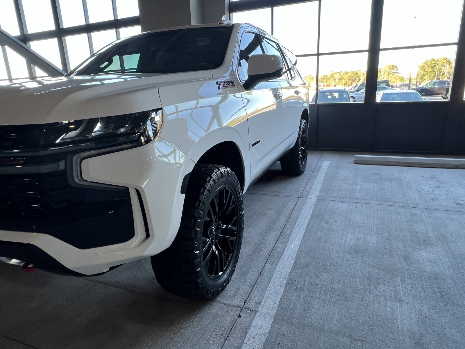

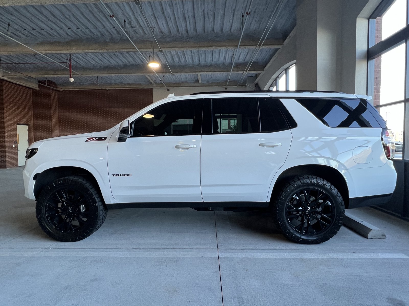

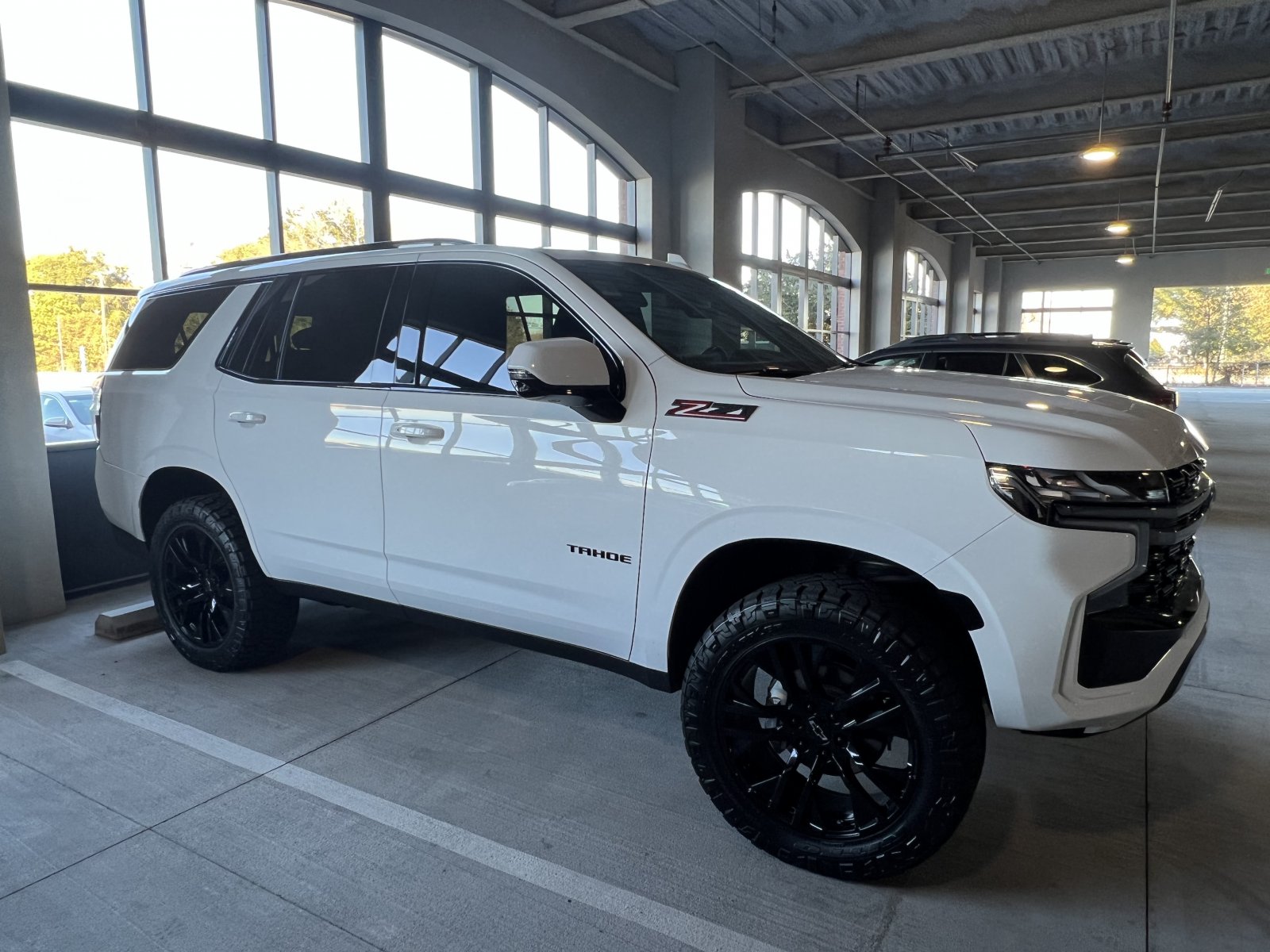

285/55r22 2” RC level, 1.25” bora spacers. No air suspension tho. Minor trimming was required. Rides great.
Just to confirm, these pics are with the 1.25" spacers? Thinking about it...
