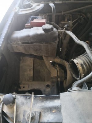

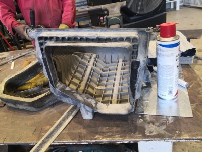

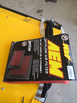

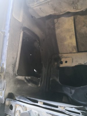

Done
TY and TY @gooffeyguy
WhatsApp Image 2020-12-05 at 16.21.55 (1).jpeg WhatsApp Image 2020-12-05 at 16.21.55 (2).jpeg WhatsApp Image 2020-12-05 at 16.21.55 (3).jpeg WhatsApp Image 2020-12-05 at 16.21.55.jpeg

Yup it was fun. I need to find a muffler that isnt too loud as there is a fine for exhausts that exceed 90dbs.
