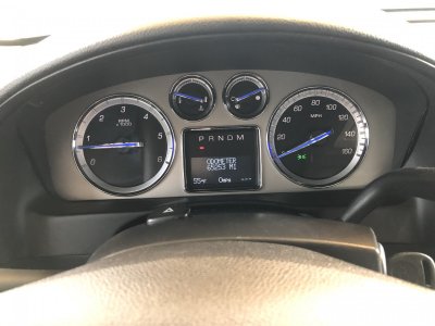

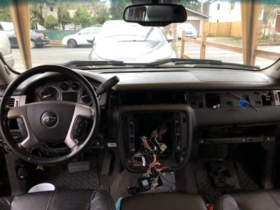

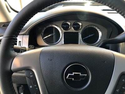

NNBS in a NNBS. There’s a write-up on GMFS but I see their site is down for maintenance. You need to buy or build a harness, and the bezel takes a lot of work to take the two different ones, cut them in pieces and make them into one hybrid. But it sure looks sweet. https://www.gmfullsize.com/threads/escalade-cluster-in-nnbs.304181/
View attachment 259368 View attachment 259369

He asked if his PRNDL would work since the display is different in the 2 clusters so I was showing that it doesn’t matter. Just an example of data displaying the same in clusters that are different from each other. Same idea, different platforms.
