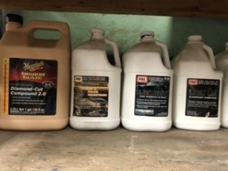

Heres the stuff i use. Got different compounds from gritty to polish, one finisher just for dark vehicles that also has a wax in it. The buffing pads i use are medium (blue) and soft (black) the blue is for the times where you want to really do a deep buff on a scratch and for after wet sanding to get out all the small scratches you put in to remove the big one (kinda sounds dumb haha) the black pad is used to get that glossy shine and to get out minor scratches. Wool pads are not fun, they can leave swirl marks very easily so i tend not to bother with them. Lil buffer helps with the wet sanding and refinishing headlights. D27A2E28-83B2-4AE6-BF17-742AEF705095.jpegF9BD3F91-6DB7-4ECD-ABF8-4404508C65D4.jpeg
