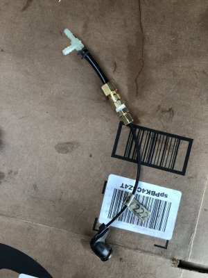

So I just did this exact thing. Fox coil overs,3/4 (didn’t delete auto leveling like I did in the front) xingeering mrc delete and used airlift bladder bags(60769) in the stock shocks and plumbed them to factory compressor. I added 1” spacers out back so I extended my auto leveling links using 10-24 machine thread, I got 4” and cut them down to what I remember to be 3/8” over factory length. I ran the supplied 1/4” air Hose from the Bags to the compressor. Here’s a pic of the abomination of adapters. After deliberation and a few other attempts, this is the best option I came up with. I replaced the factory T and used the factory line to the driver air shock (I figured that might be the cheapest to replace if I ever wanted to reverse this). Attached my adapter thing directly to the compressor. Turned it on, compressor kicked on, and kicked off pretty soon after. Not sure if it will level out correctly. Need to put weight on to test it and possibly adjust link length.
I will try to do a better write up once I get some more time, but feel free to ask any questions, hopefully I can help.
