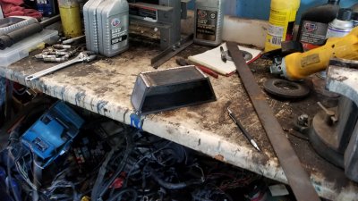

Sorry for the delay, been silently working in the background on this project. Some of the final wiring is done for the harness, just need to get the transmission connector rewired for the 4L60 to 4L80 conversion but shouldn't be long, I hired a guy that is good with electrical so hopefully tomorrow (3/15) will be test drive day. I have a mobile welder friend here now putting the final touches on the transmission lift block, original design has it sitting too low so we fabbed up this bracket to lift the transmission 3in. On another note, the drive shaft fits perfect, so we are down to the wire on completing this Hoe!
Here's some more eye candy to hold you off:
