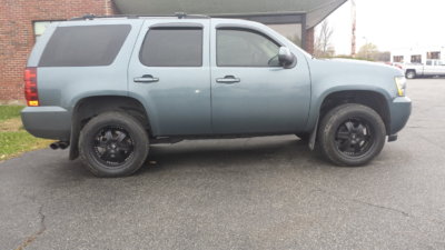

how do you measure how much it lifted? i had a shop do it
Do what the others said here to measure. By the looks of the picture I would be worried about angles also. Everything looks at max angles with uppers on droop stop. If that’s the case definitely need to loosen up torsion key bolts to a safe condition. Post pics of upper arm to confirm suspension travel.
i think the next time i need an alignment ill drop them .25-.50 an inch.

Try like 1-1.5 you’re gonna eff some parts up running like that...
but then its not level so whats the point of having keys? I dont think all of these companies would make torsion keys if it were so bad for your parts
That’s like saying McDonald’s wouldn’t selling you hamburgers if they were bad for you....
You really need to get different upper control arms or decrank.
@01Konvict can you advise on the amount of room there should be between a droop and UCA on a NBS. I know you want level but you’d rather not have your CV’s binding. Those angles look rather extreme.
