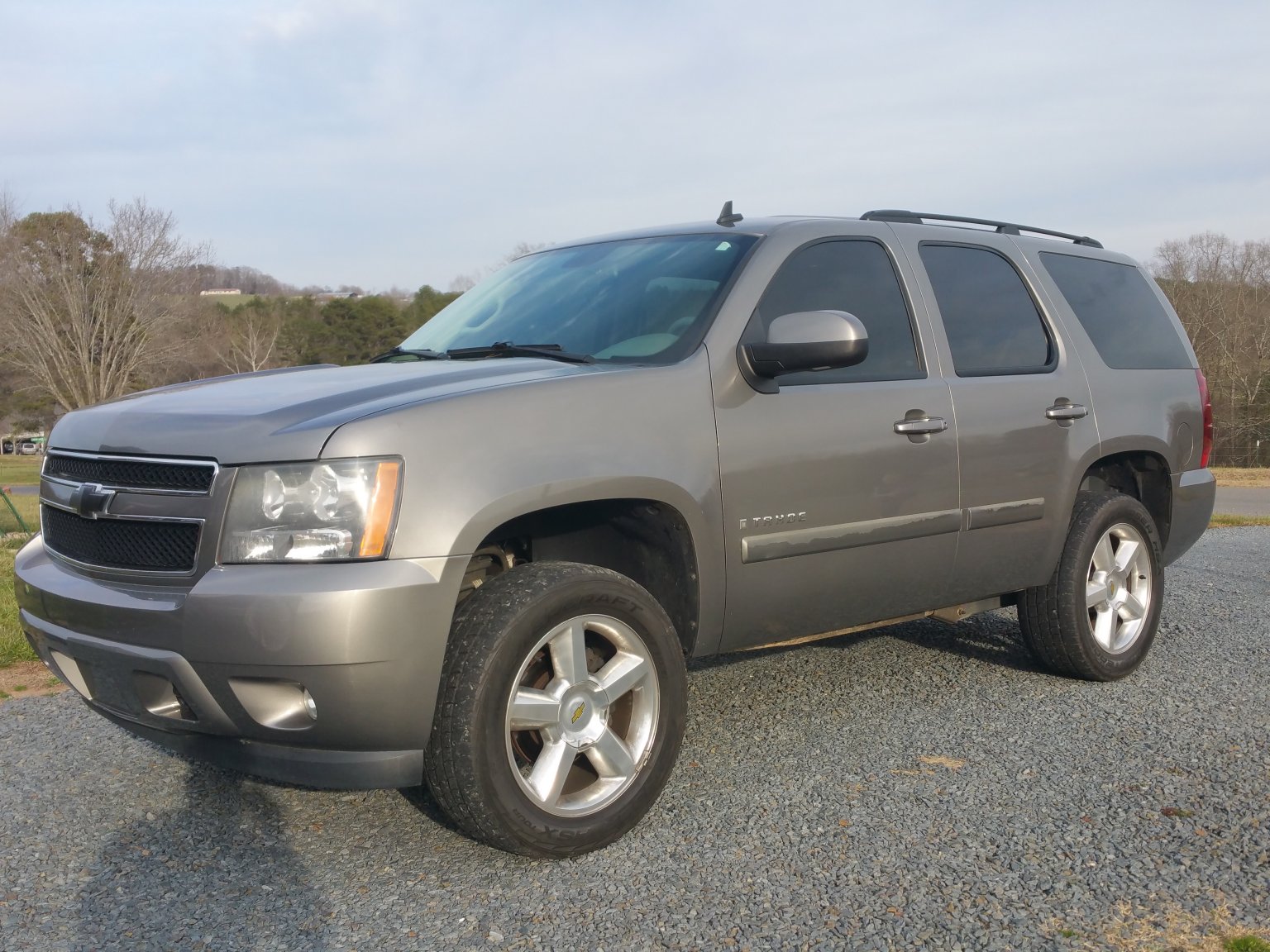

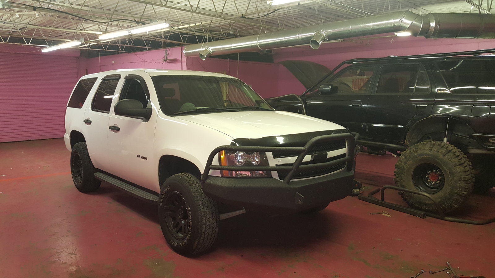

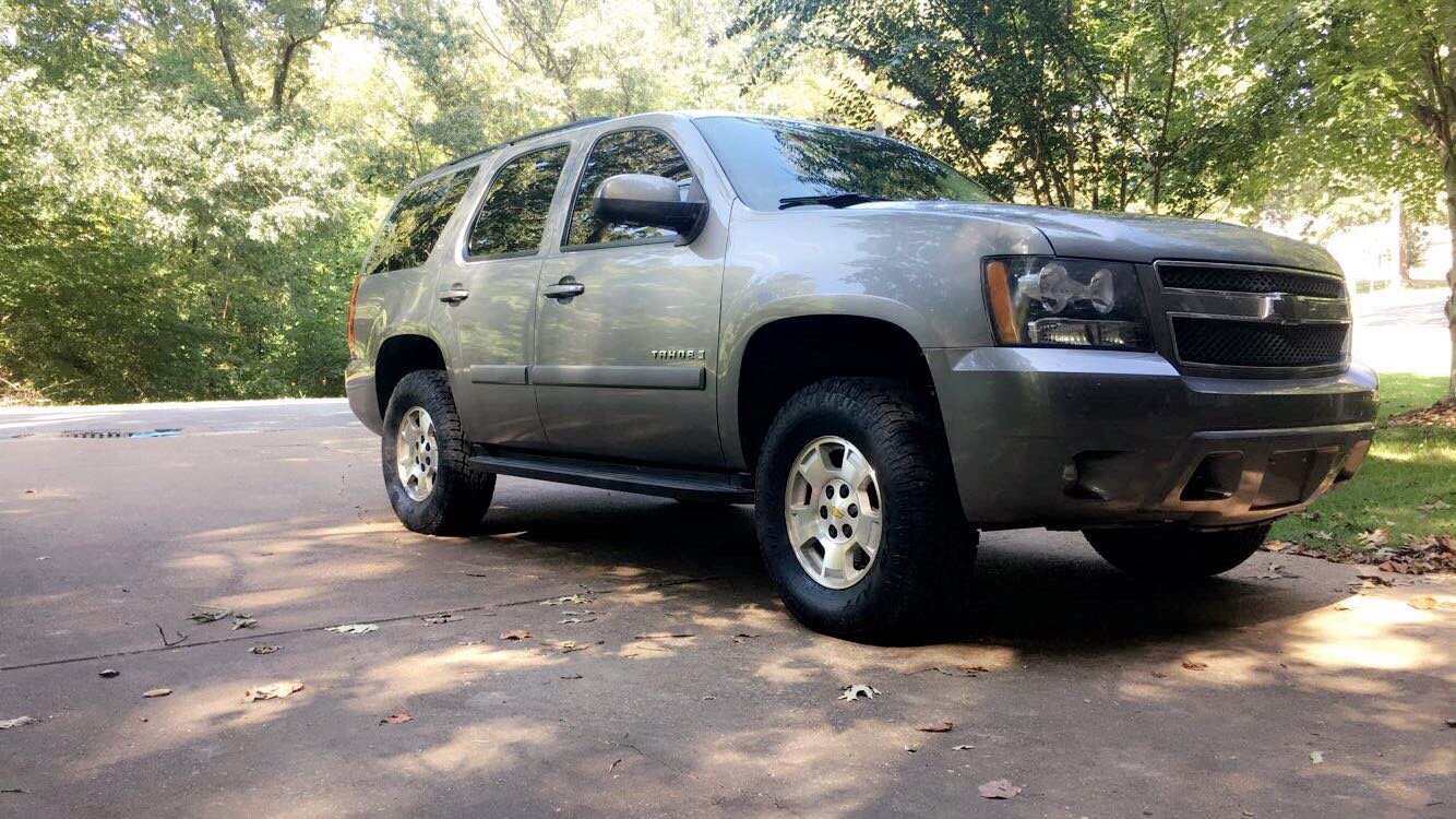

2007 Tahoe SSV rc front level kit for now. Going to do roughly 4in lift and 33s. Usually build much larger but want a more sleek look for this one
MadDogDelpho
Texcellent
Nov 20, 2016
1,692
2,297
Texas
I think 4 inch will be too high and might look funny. I'm at 3 inches on my 2002 and I want to go down a bit. I need to get spacers so I can clear first but I'm gonna go down to 2 inches. I think the NNBS has even more clearance, too, especially with that replacement bumper. But if you were to go 4 you *might* be able to stuff 35s

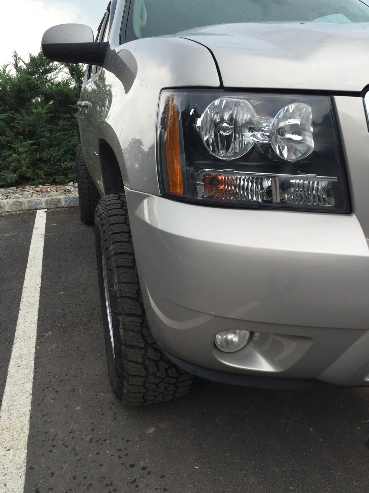

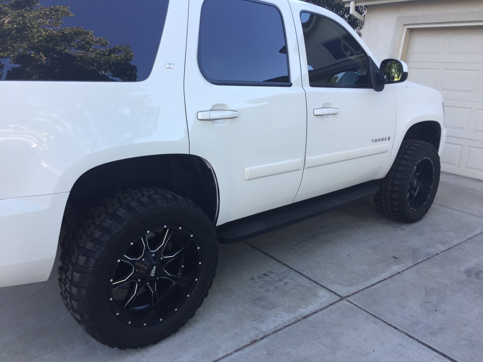

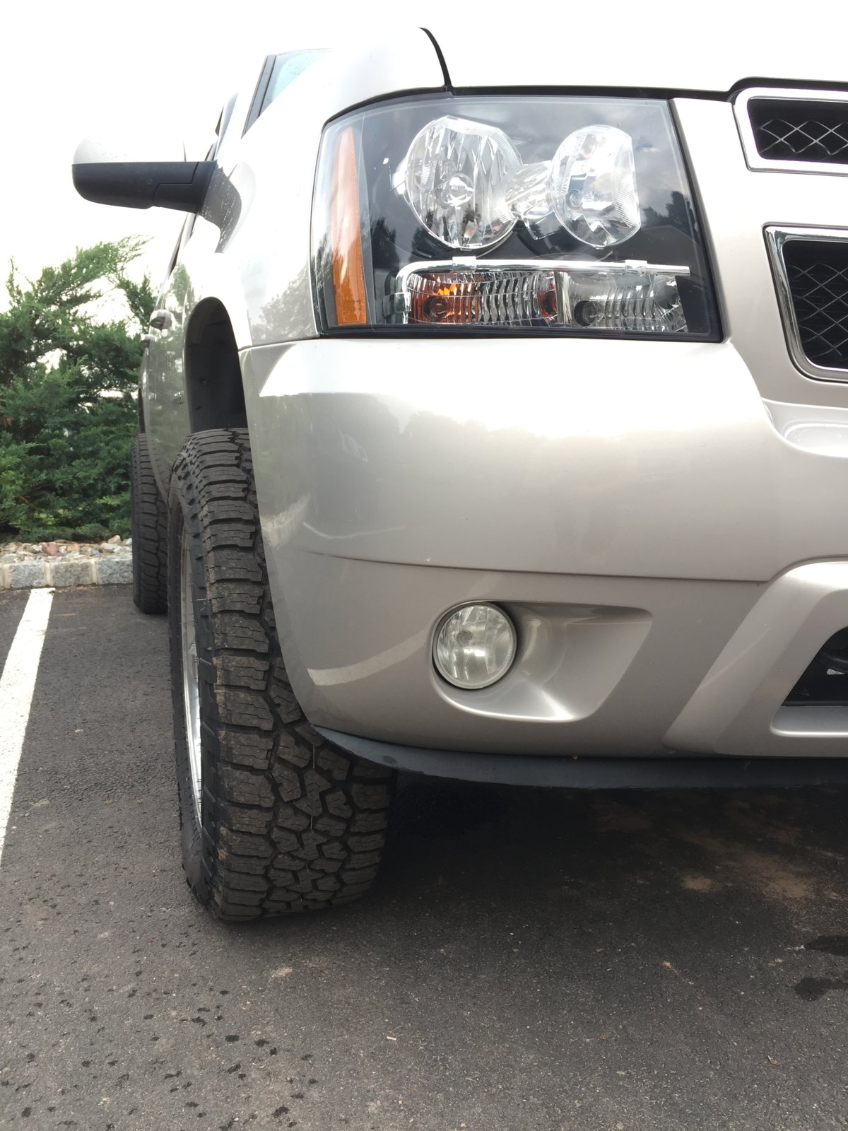

2" lower rc spacer bilstine 5100 on 3rd clip totals 3.25/3.5" with a 1.5" spacer in the back. 276/60r20 falken at3w with 2" wheel spacers.

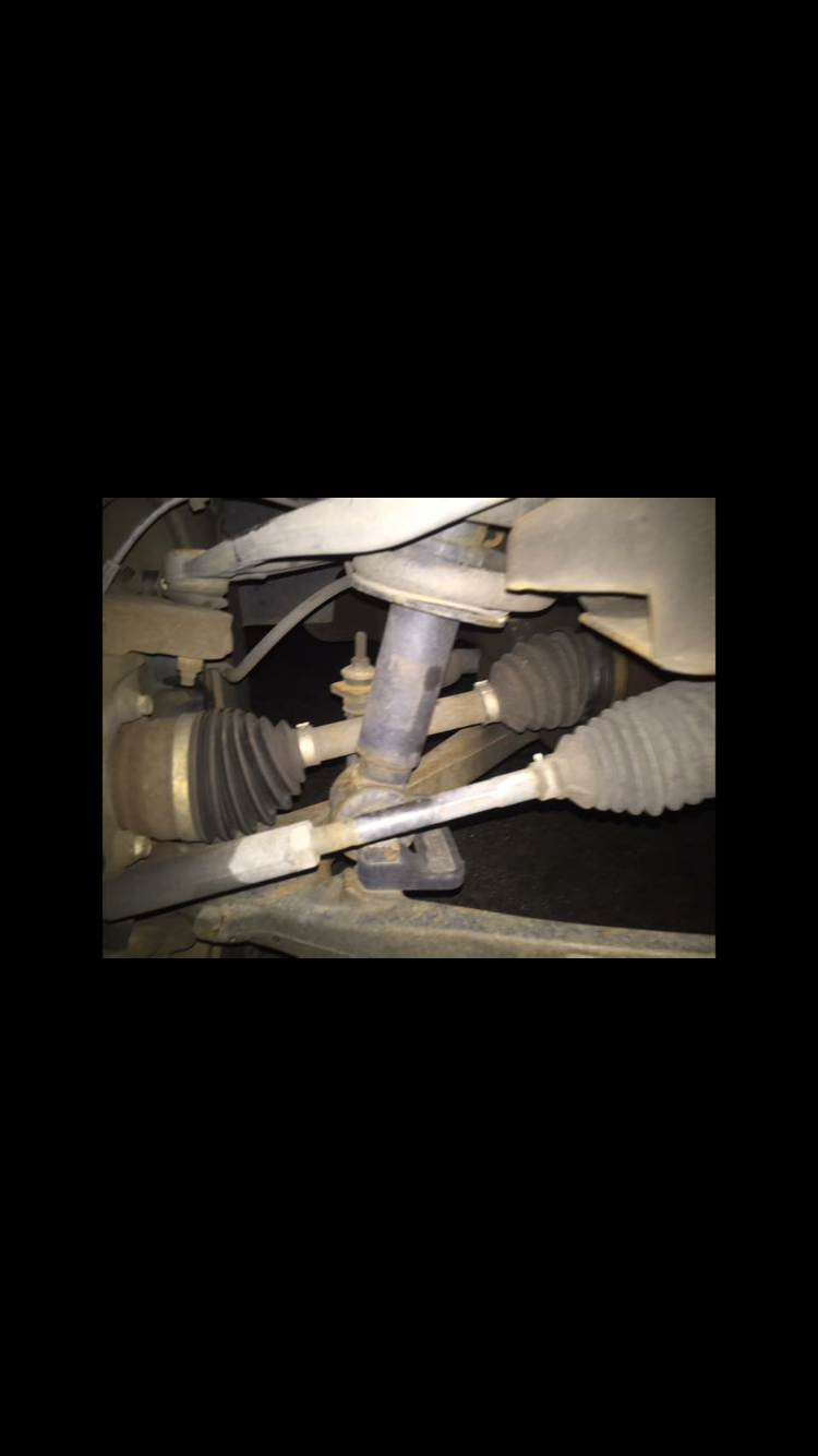

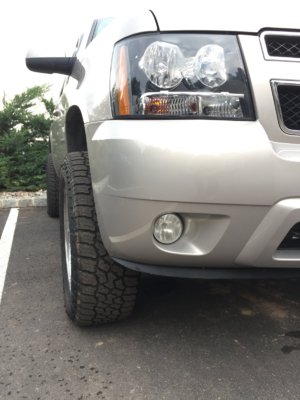

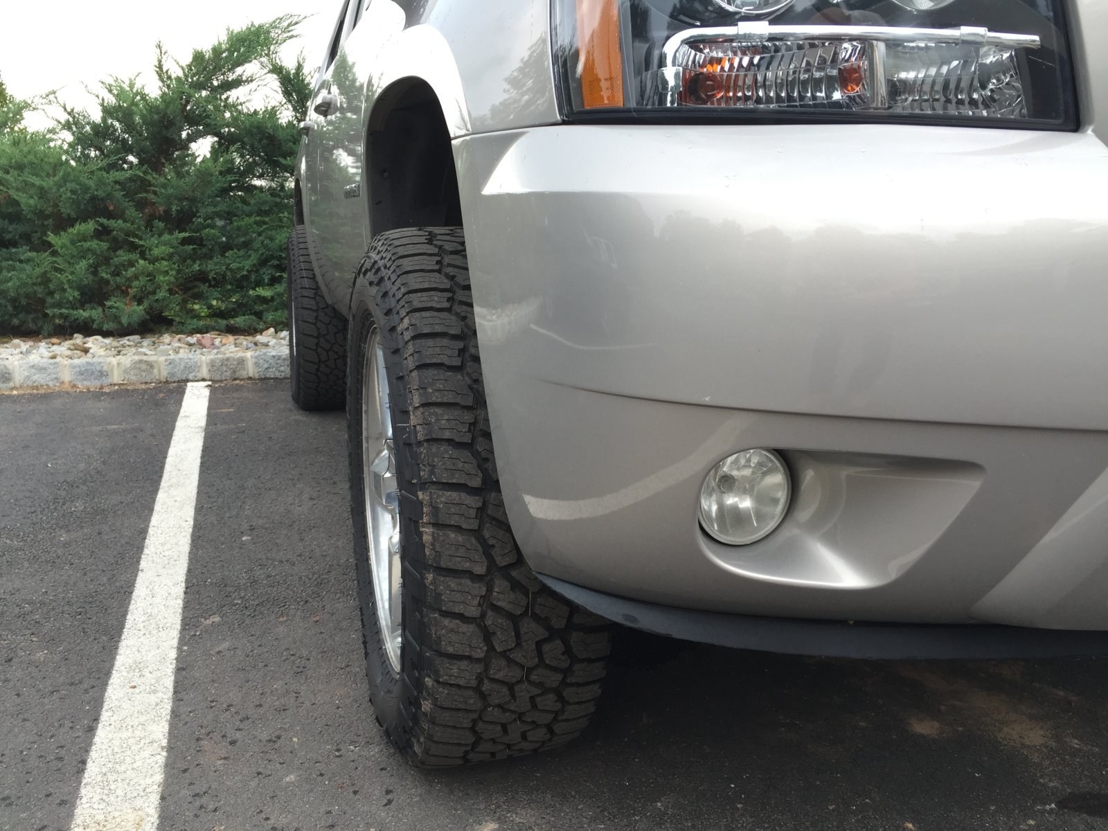

That height looks great but how's the CV angles on your truck?
First pic is mine on the 3rd clip with lower strut spacers, 2nd pic is my dads 08 1500 with just the lower strut spacer. Angles arnt to bad. I will be dropping the diff, working on making a spacer. Since The pictures I got rough country uppers, new lower arms with balljoints, new delco inner and outter tie rods

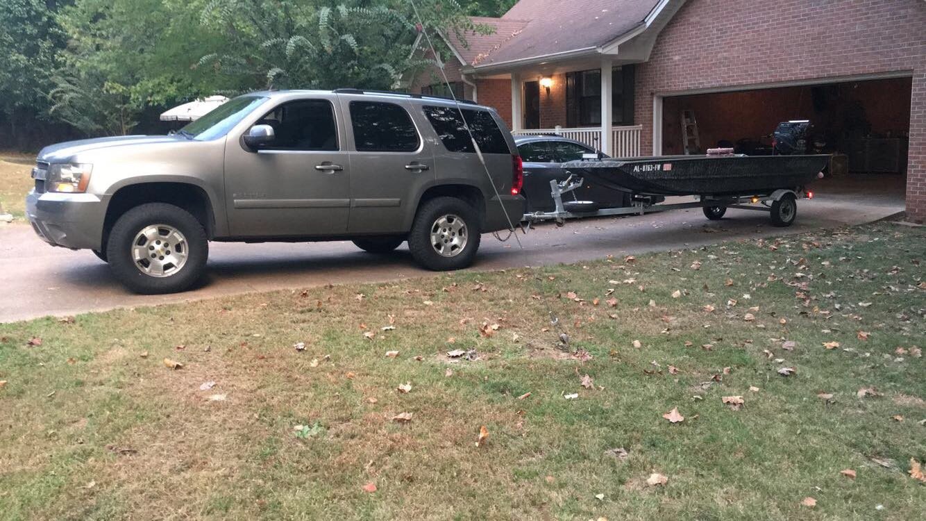

No steps really helped. Ill do wheels and tires next year.
how much fish or beer/ice do you have in the boat?
that looks like a lot of squat for such a small boat. ;)
