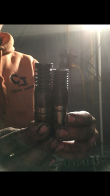

That's a first. Kill the engine huh. Explain please.
This is what happens. We just had to do a complete overhaul on our engine to delete the AFM. it’s a joke. My engine runs so much better now. There’s a website I can direct you to that explains how to do it and all the parts needed.
