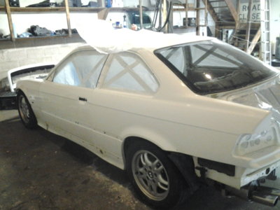

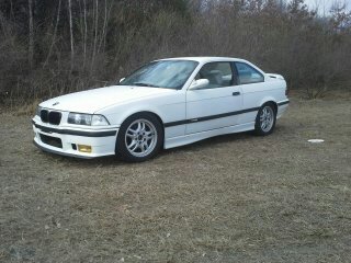

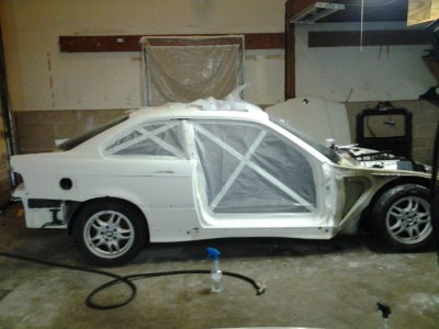

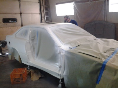

It's not on my Yukon but I dipped my previous BMW. Is pent a lot of time researching it and even going on the dipyourcar forum and calling the company. They'd never even heard of dipping a car to the extent I did. I couldn't find anyone to shoot paint after the body work was done so I dipped the car to protect the primer. Had it on the car for probably 4.5-5 years and it still looked good. I used to wash it with scrubbing bubbles and a white scotch bright pad. The WHOLE car was dipped, door jambs, underside of the hood and trunk, inner door, even the hinges and bolts. 9 gallons total (could have gotten away with 7 or so If I didn't screw the hood up twice.
2013-04-28 18.13.03.jpg 2013-04-28 18.13.37.jpg 2013-07-06 13.46.19.jpg 1396726922709.jpg
EfiniMotorsport
Aug 28, 2017
173
117
Using all new trim, rubber, seals, etc when I put it back together really made it look good
