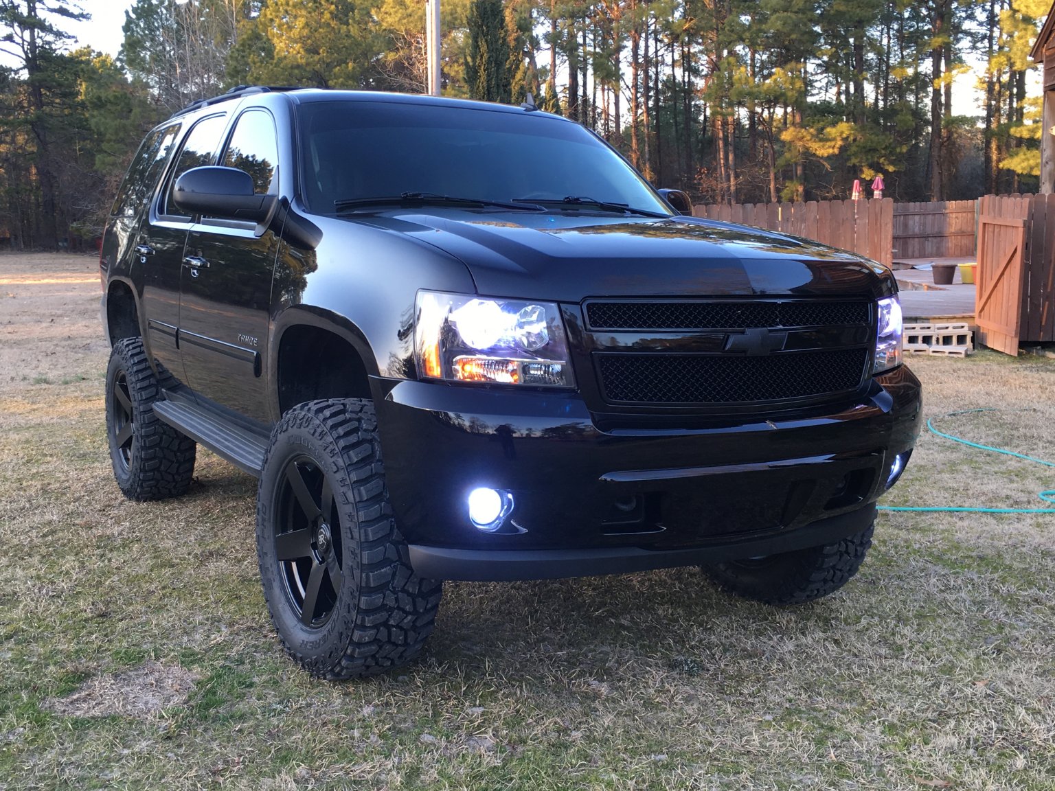

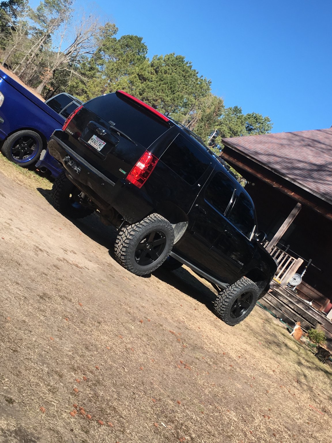

Absolutely in love with the way it turned out.

Truck looks good, What are those rims. first thought they looked like a rockstar 2 but they don't have the dish.

Yeah I forgot to order those spacers but they are on the list.
The wheels are Black Rhino Everest. I saw them on a truck on here and that's how I came across them

Very nice Tahoe. How is the ride with that lift and tire combo? I been thinking of lifting mine. Thought of just doing a level but but seeing this makes me want to go all out. But then again I have a lifted 1987 Blazer and the Tahoe is my daily driver.

It actually rides good the damn Traction Control is an ******* now. I can't set the cruise control

Is the TC light on all the time or when turning? Usually alignment takes care of TC light since the steering wheel position sensor needs to line up with wheel direction. Also correct programming of tire size to GPS verified speed on speedometer helps it. If anything else then check connection of ABS sensors and wear on wires.
