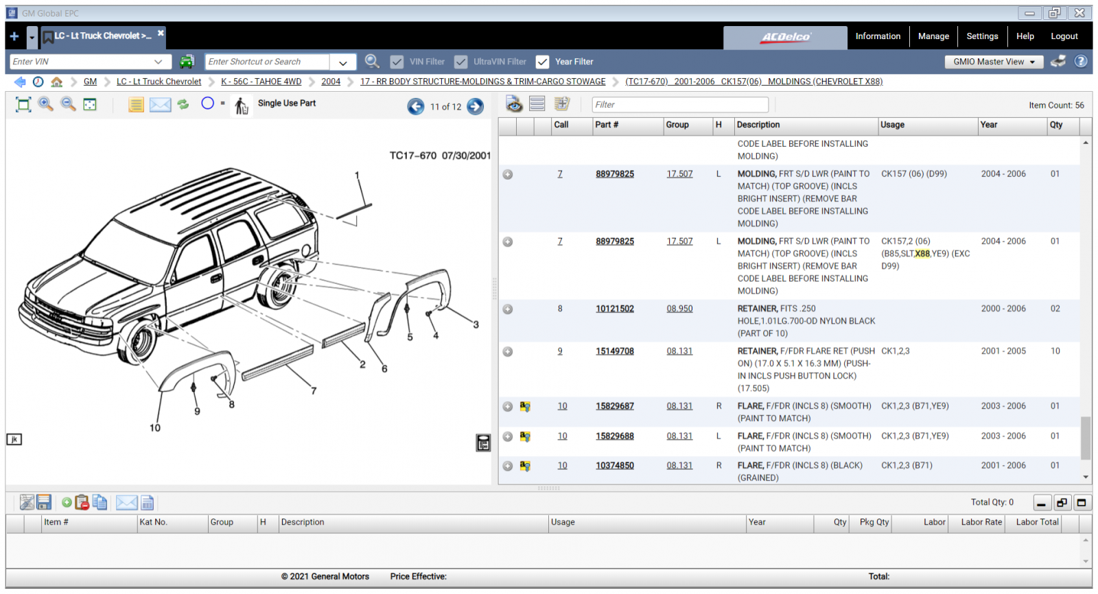

Would anyone have a source for the little plastic pins that hold on Z71 wheel opening flares on? I bought some off ebay and they were junk.

You're looking for parts 8 and 9 on this diagram
8: 10121512
9: 15149708
