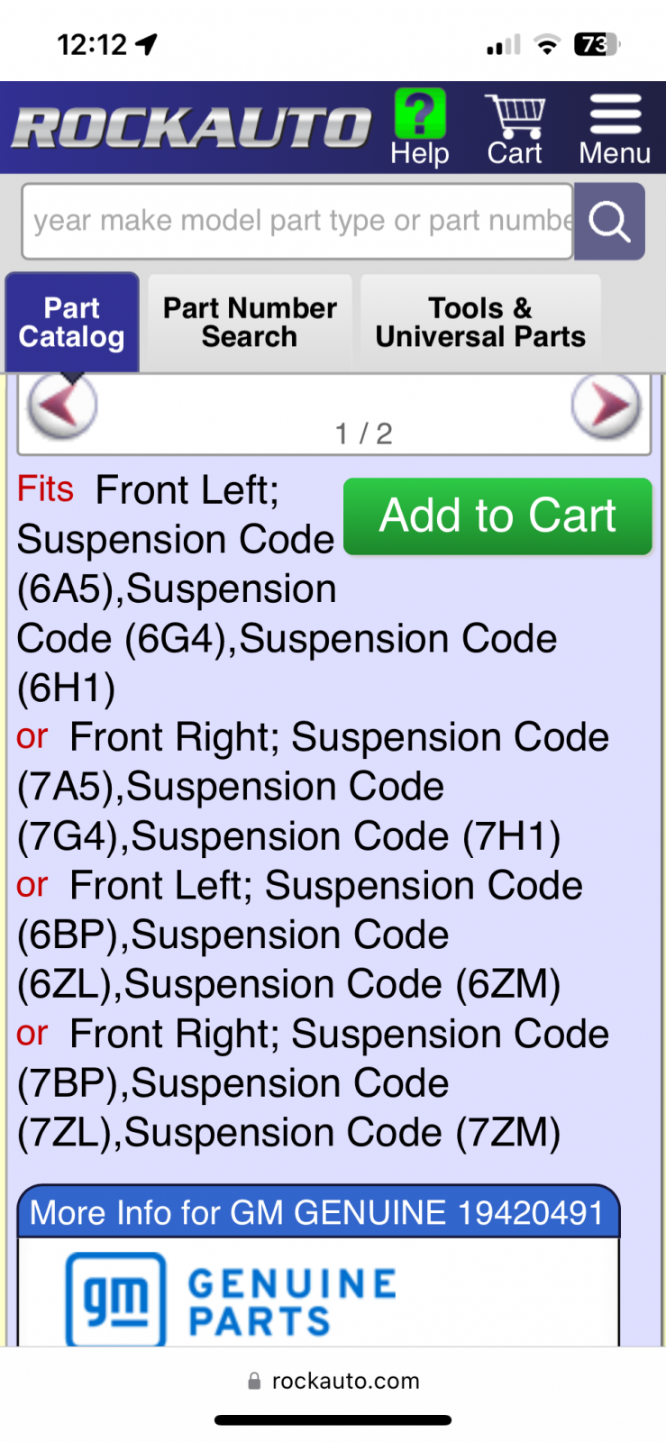

If your RPO codes match some of what’s listed here you got the right ones for the front …
If you can’t match any any of your suspension RPO codes to the ones above, go to rock auto and find the struts that match.

Thanks bud, I had some conflicting rpo code read outs and wasnt sure if Rock Auto was more accurate than dealer websites. But I learned quick on that one.
