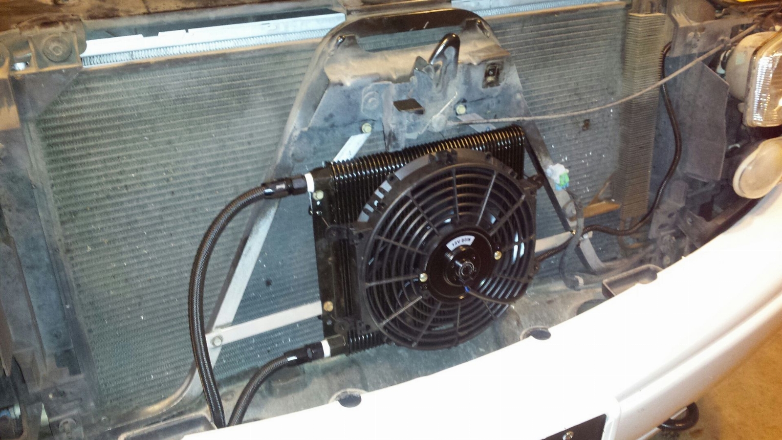

I realized I never put up a pic of the trans cooler setup. I had pics of the brackets I made in detail and somehow the pics vanished.
Whoops!!!!

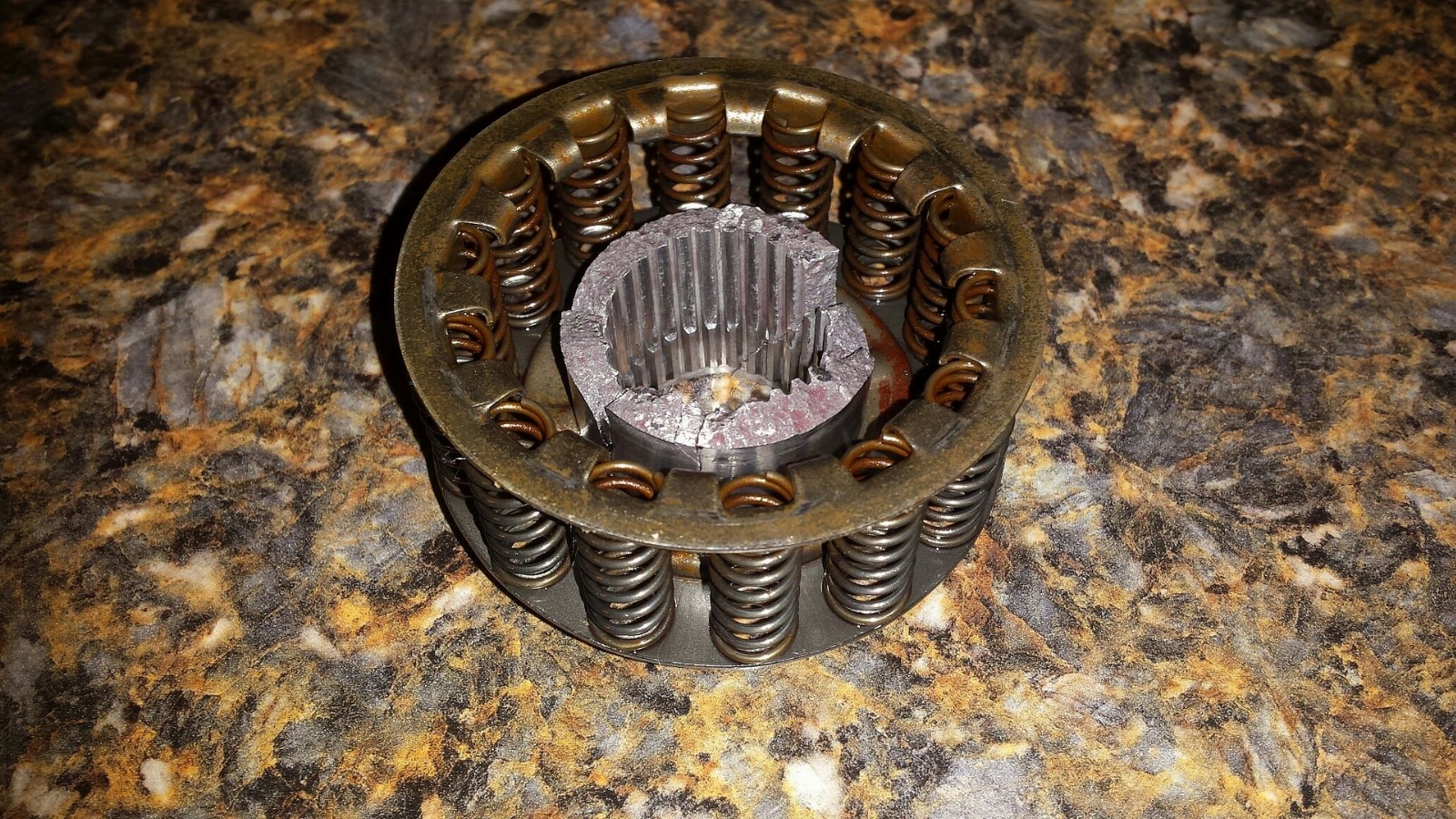

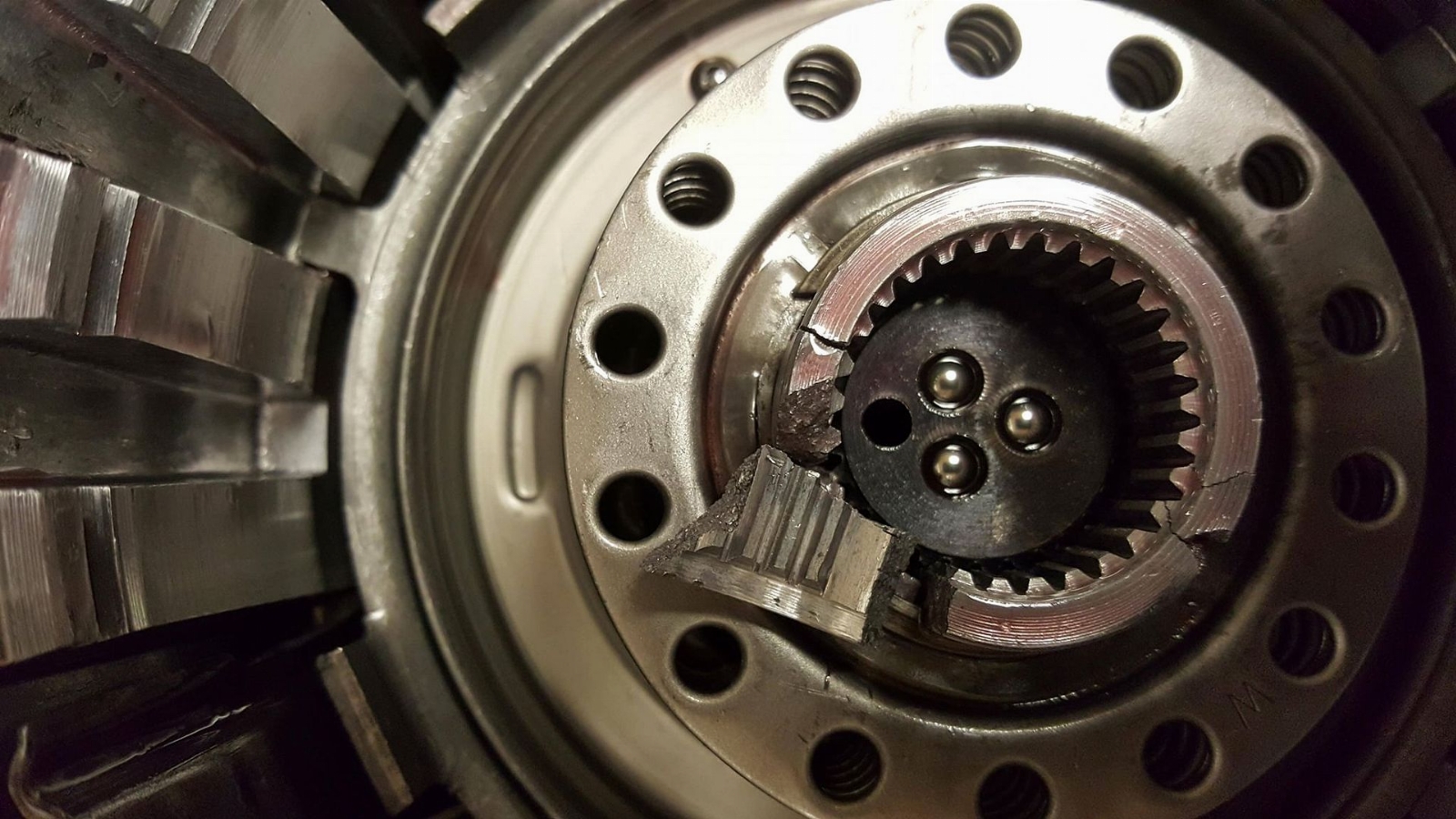

Broken input drum on the 4l60e.

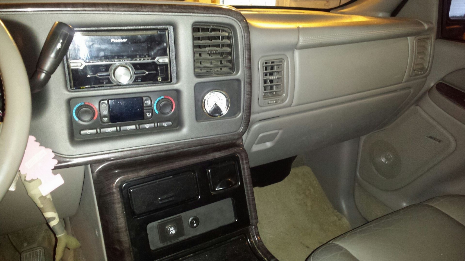

So since the truck is down for a bit, remember i put the air lift bags on the rear with a tire valve filler? I wanted something i could air up and down from the drivers seat. So I bought their gauge, and a compressor and lines, check valve etc etc. I needed somewhere to put it and didnt want it up by the windshield. So I took the traction control and trans cooler fan switch and moved them down to where the 6 disc changer used to sit, and made a new panel there for it.
