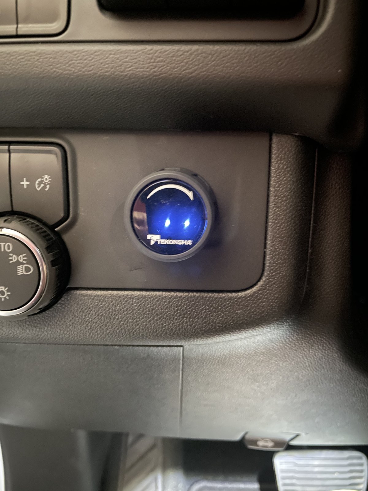

Hello I just took delivery of a suburban high country with the diesel. It did not come with the trailer brake controller I installed this one from Tekonsha. It’s nice cause you can make adjustments with your phone via BT.
