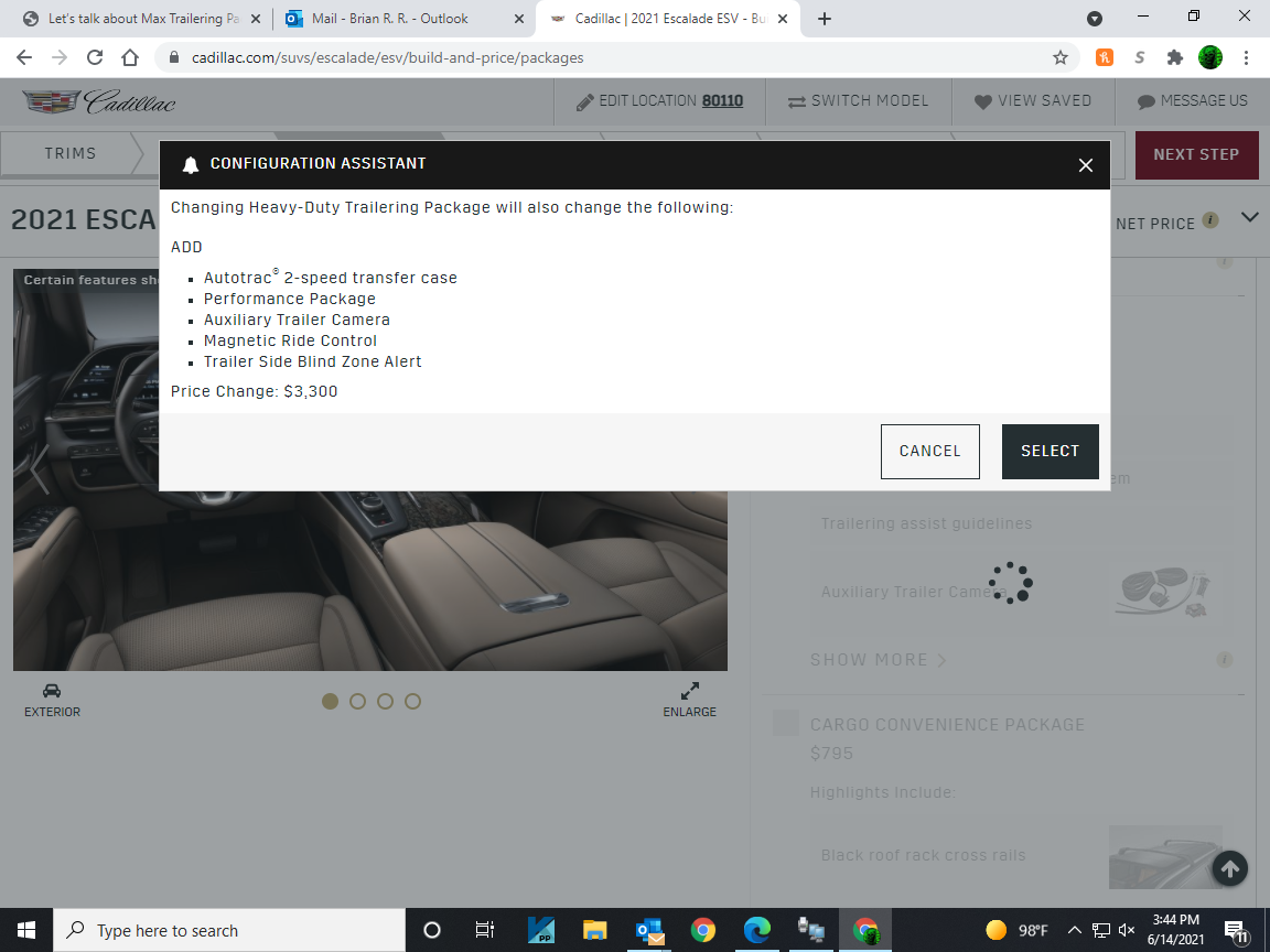

Note that this explains why the max trailer package costs less with the 3.0L dmax.
It depends on the brand.
On the lower trim Cadillacs for example, the Luxury package doesnt have a trailering package. But the Premium Luxury does, and it costs 3300 on the DM or the Gasser.
On the Sport or higher, its just a base 600 upgrade, DM or Gasser.
Premium Luxury
Sport and other higher trim..
